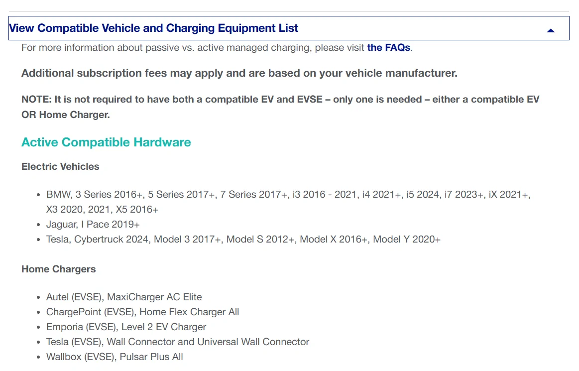

The Emporia is compatible with my utility company's time-of-day discounted rate plan, while the FCSP was not.
I only charge from midnight to 6am, and am able to utilize my utility company's "Charge Smart NY" plan, which provides a discount when using the compatible Emporia unit.

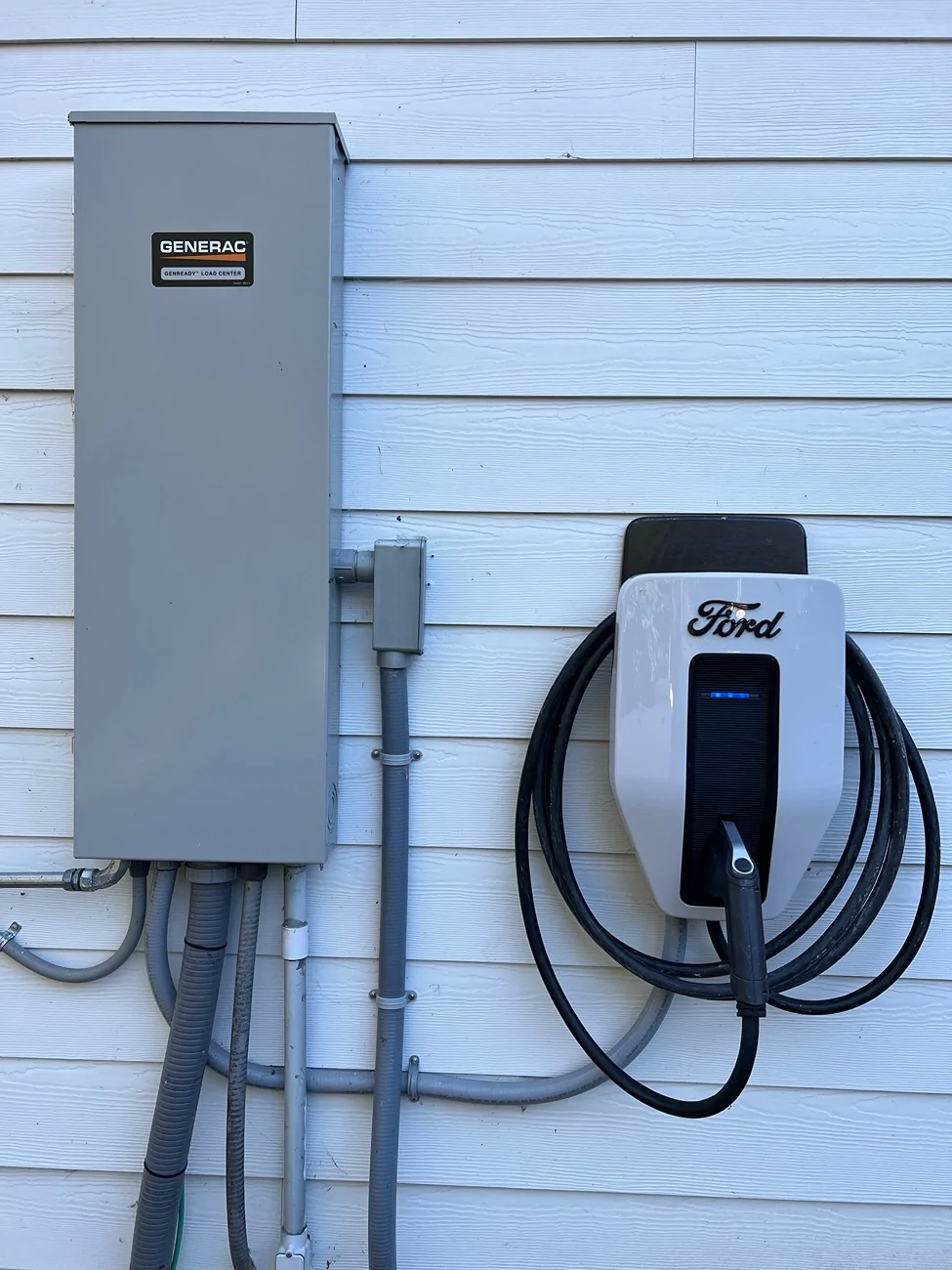

My FCSP charges at 16.2KW. It’s very nice to be able to start the charge at midnight and have it at 80% before 6am.
I have a short run outside connected to my house panel with a 100A breaker.
Also great to be able to top off before 3pm on typical errand days.
