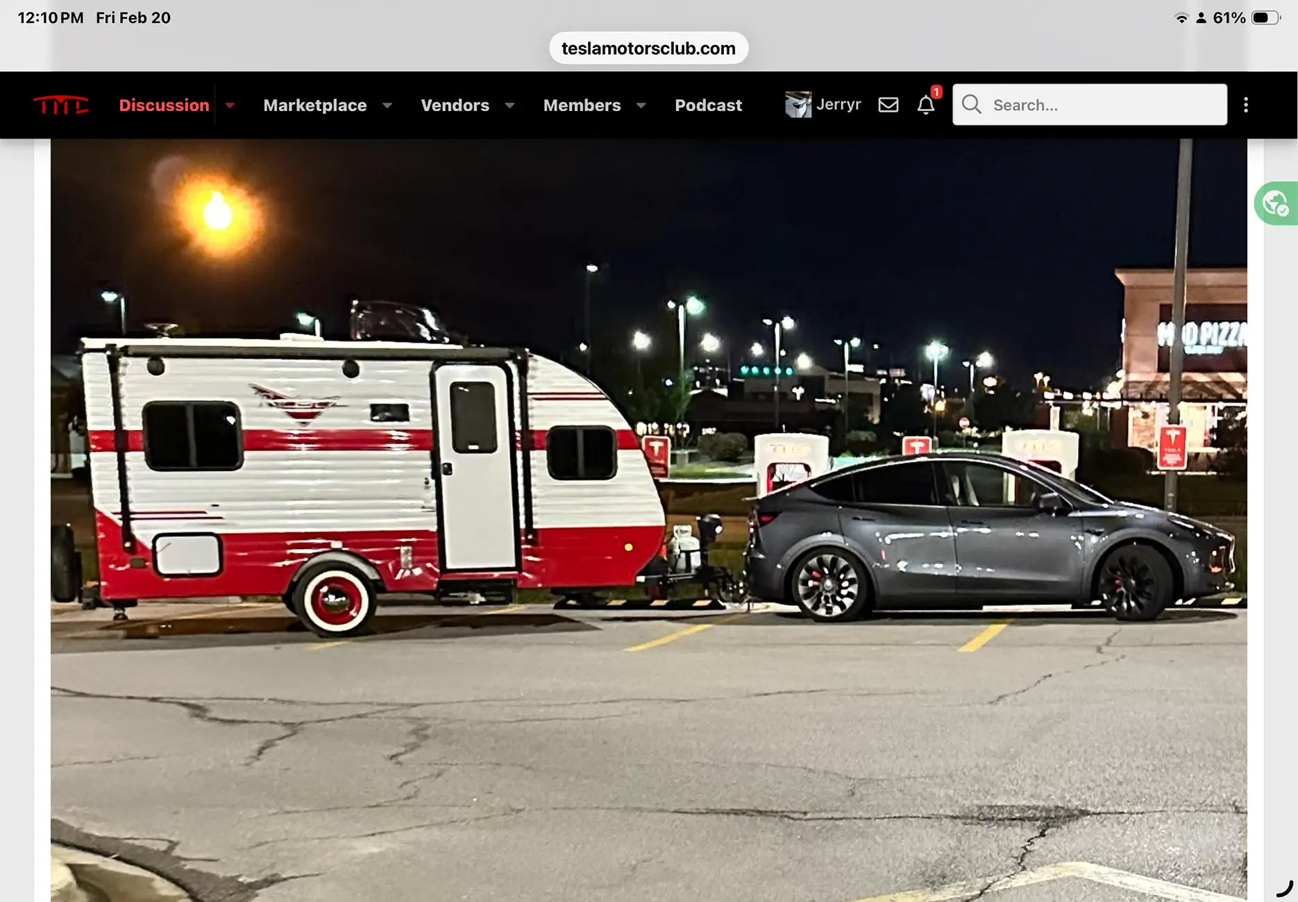

Here is a Tesla model Y towing a light weight camper.
Good picture to have in your pocket the next time a Tesla driver gives you crap about taking up 2 spaces at the Supercharger. 😂

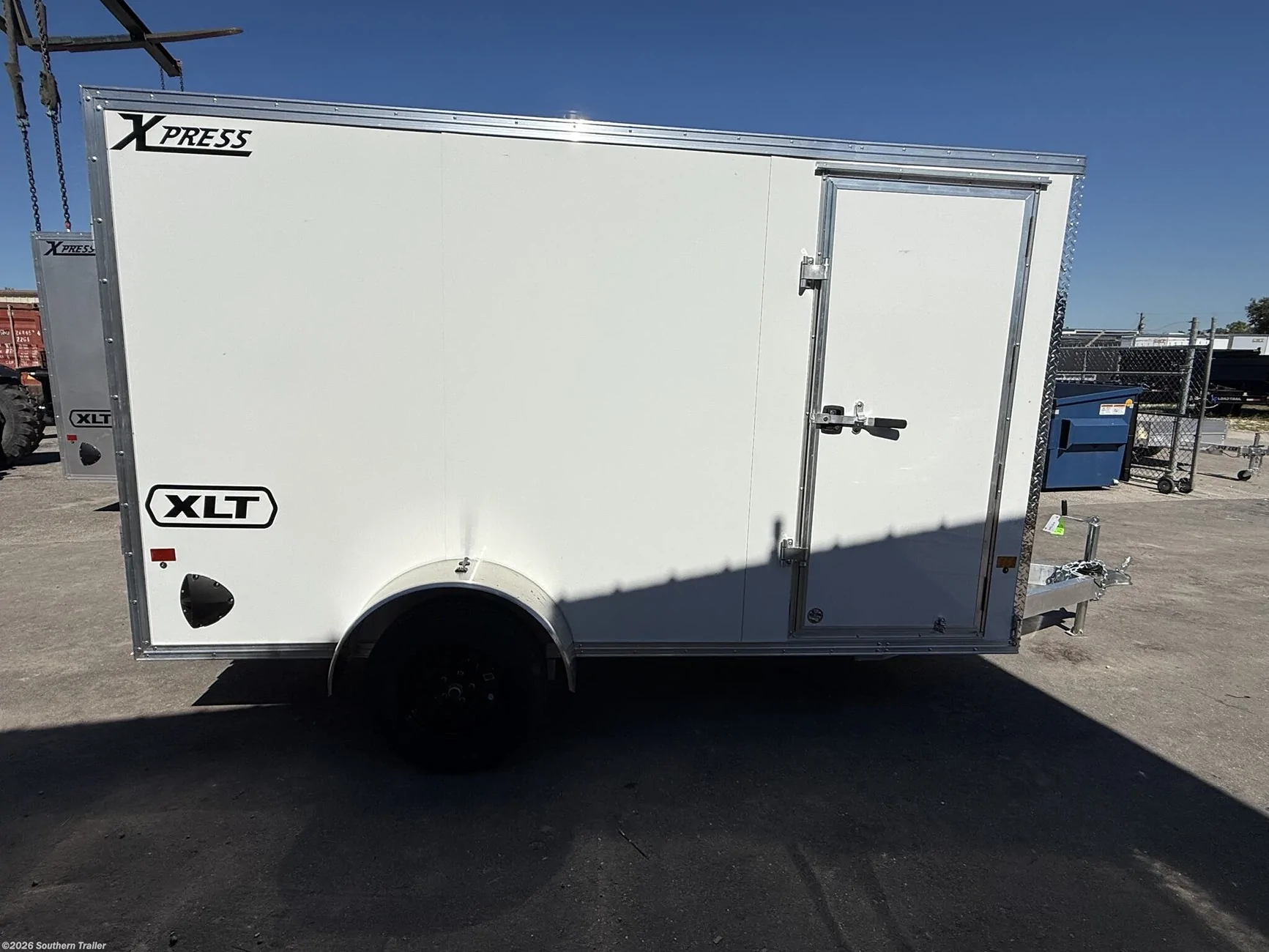

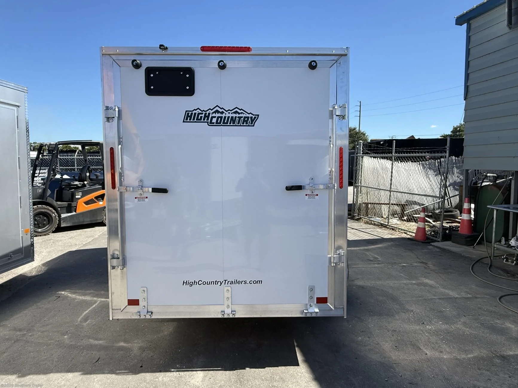

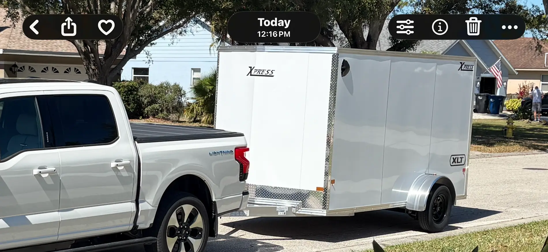

Thank You ALL for your input and advice that helped me decide. I went with a 6X12 only because I can also tow it with my Model Y. So today I bought a New 2026 Xpress 6X12 Pro Series Aluminum Enclosed Trailer 2990 GVWR.
Unloaded it did 1.3 mi/kW at 65 MPG on the 60 mile trip home.
I have to get reaccustomed to backing up a short trailer instead of my 34 foot previous 5th wheel and 33 foot bumper pull RV. It pulled so much easier backing into my driveway from the street.

The new trailer has a V-Nose. It’s had to see in my previous pictures.. Here is a picture from the dealer site that shows the X-Nose better.
I went with this trailer over a similar trailer because of the Aluminum frame. The Trailer weighs 650# less than a steel frame trailer.
Hopefully the V-Nose and lighter weight will help with towing efficiency.

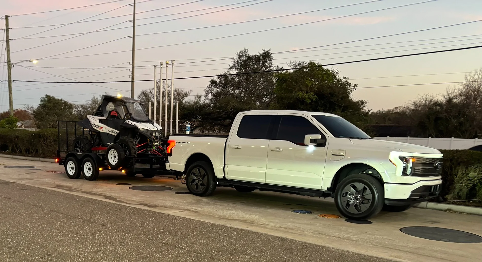

Highly recommend you check your level. it appears the trailer is leaning backwards. It should be adjusted to just slightly leaning forward. Ive personally used an old bathroom scale with a 2x4 on the tongue to see how much weight was dropping down on the hitch.. Its crude but has always worked well for me in the past.
Also good luck, you will enjoy how well the truck tows. I Tow my SXS all the time with it along with firewood when i go to my parents properly to cut wood. On my SXS because its not very aerodynamic i get around 150miles per charge from 100-10%, but using the same trailer towing tree logs weighing 2-3x the weight i can get 180+ miles out of the trip, because there is less aero drag.
