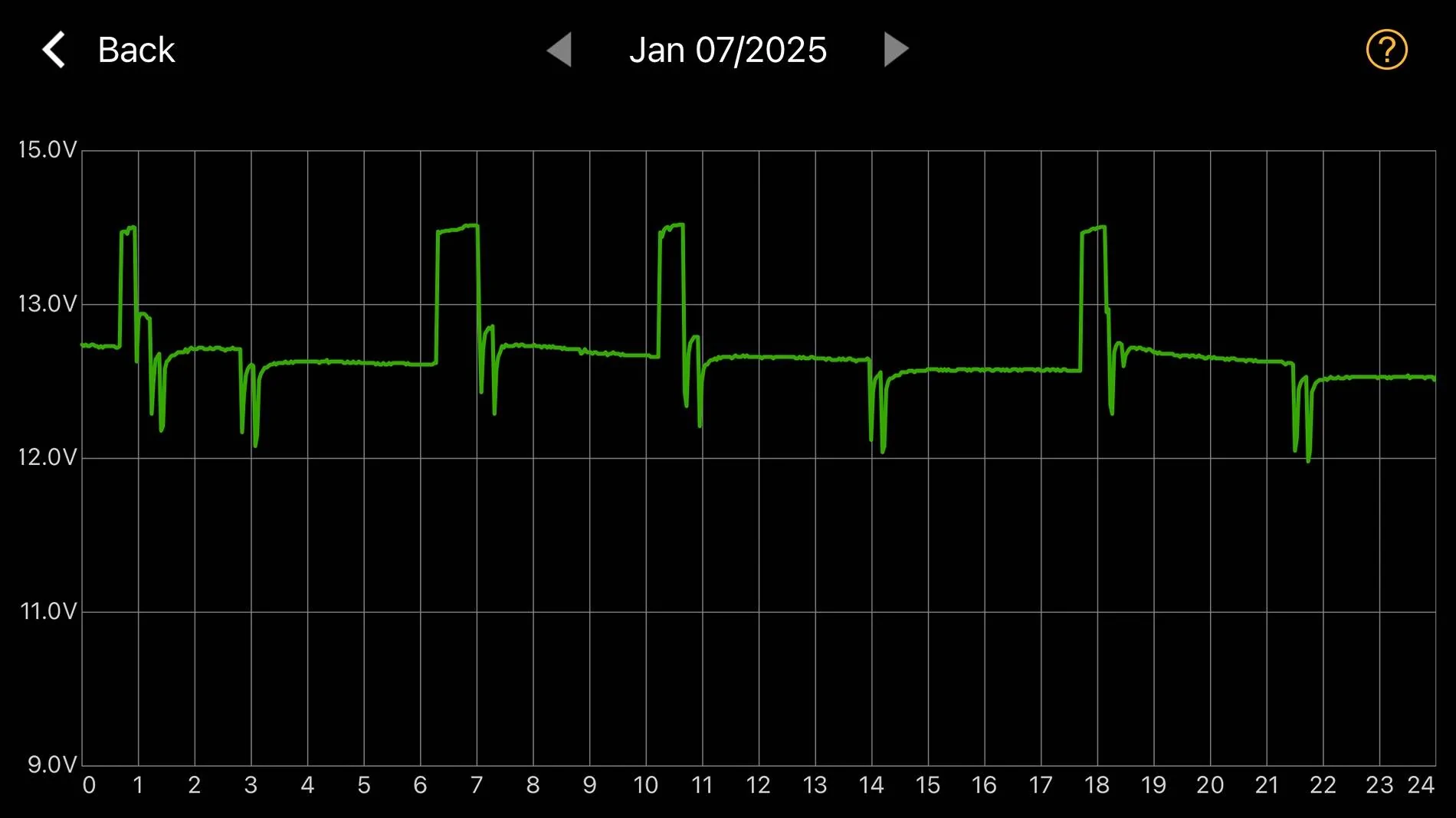

Ford F-150 Lightning Charge off peak only but keep battery warm when cold IMG_DBC28BEB2D96-1
This is from my 12v battery monitor on my 24 Flash. The truck was parked at the airport and plugged in to a public ChargePoint. This was a very cold day (for KC) - probably near 0-5F. I didn’t check on it during the day and there were no departures scheduled. It’s not a direct measurement of energy for battery warming. I’m assuming the voltage drops were the modules waking for some reason and the voltage increases were the system warming the HVB. I don’t have any data for cold days while unplugged.

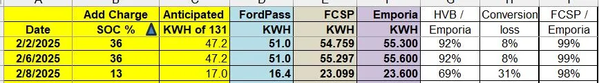

I just topped up again to 90% in anticipation of another snow event.
Tonight the conversion loss was 31% instead of the usual 8% or 9% when the pack is warm enough that it does not need extra warming. 5.4 kWh for heating, 1.8 kWh for ac/dc conversion,
