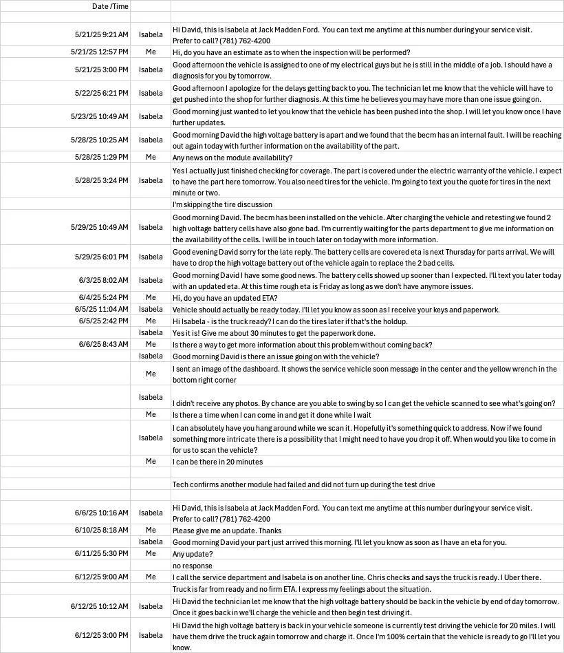

I am going to paste the timeline as captured in text messaging. No editorial comments as the content speaks for itself. I will report back tomorrow, hopefully for the last time when I get the truck back.

I guess they figured that out:
"Good morning David. The becm has been installed on the vehicle. After charging the vehicle and retesting we found 2 high voltage battery cells have also gone bad. I'm currently waiting for the parts department to give me information on the availability of the cells. I will be in touch later on today with more information."
When all my light went red and wouldn't charge they found 3 bad battery modules.
