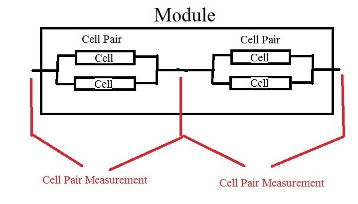

I hoping my Launch X431 CRP919 EV car Scanner will give me individual battery cell voltages. At the very least I'll be able to see each module voltage but I'm hoping for individual cell voltages.
I have a friend that owns several nissan leaf and uses an app leaf spy is capable of monitoring individual cell voltages and even gives him cell deviations. I'm hoping to be able to monitor the battery modules BMS.
I have a 2012 Leaf with the 24kWh battery.
As I understand it, technically Leaf Spy reads the cell voltage of cell pairs, because of the parallel cell connection in pairs.
Of course because they are in parallel, the terminal voltage each cell of the pair has to be equal to the other cell.
The 24 kWh Leaf battery pack has 48 modules.
Each module has 4 cells.
Each module’s cells are in two pairs.
Each pair is in parallel.
The two pairs are in series.
So voltage has to be measured in cell pairs since the individual cells are all in a parallel connection of 2 cells, as in this block diagram:
Ford F-150 Lightning Charging error (All 5 segments turn RED) HVB Module failure leaf battery modul
Ford F-150 Lightning Charging error (All 5 segments turn RED) HVB Module failure cell-module-pack diagram
Module voltage is 7.5 volts.
Leaf Spy is reading the data that the on-board BMS (Battery Management System, called the LBC for Lithium Battery Controller by Nissan) provides which is raw data, like temperature and cell pair voltage, combined with calculated values for SOC and SOH based on the raw data.
So I do not think it would detect bad modules before the BMS did.
There are many caveats with calculating methods for both SOC and SOH, but whatever method is used, the Lightning BMS according to the OP did not predict the bad cells/failure and did not alert about it until it had happened.
I imagine that Car Scanner reads the BMS data and therefore would not be able to predict/detect bad modules before the BMS did, eh?
I suppose if a module(s) fails gradually over time, the weakness has to reach a certain threshold before being detected as a bad module.
If it was gradual, the BMS should not have been reporting a 100% SOH to the Car Scanner.
There should have been a steady decline in the SOH as the bad module lost capacity compared with the new battery capacity.
So I suppose when the module fails it is a sudden thing and can't be predicted.
The BMS could isolate electrically or disable a failing module to protect the rest of the modules in the battery system.
As for the trucks with misaligned batteries, “Due to production process deviations at the supplier, the electrodes in the high voltage battery cells may be misaligned. Over repeated charge and discharge cycles, this misalignment can eventually lead to an internal short circuit...the company is asking owners not to charge batteries past 80% until dealers can repair them.”
So it seems this misalignement is a potential battery problem that the BMS cannot detect and isolate, and charging beyond 80% will heat stress the battery to the point that the misalignment could result in a short circuit and a fire. A truely scary proposition!
