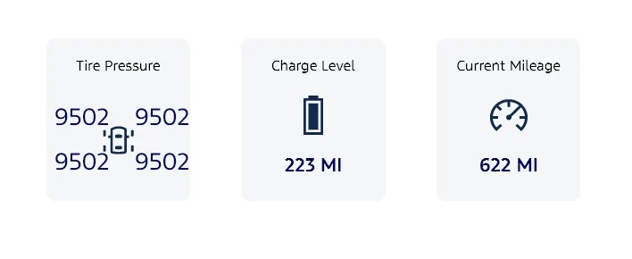

Ford F-150 Lightning Charging error (All 5 segments turn RED) HVB Module failure tire pressure - OMG
