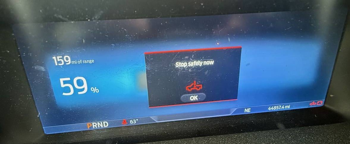

Getting towed in tomorrow for similar issue (TBD). Failed charging and ring goes all red. And this message on dash when trying to start.

AAA towed it to the dealer this morning. Getting into tow mode neutral was fine. Arrived at dealer and The driver starts unloading and the emergency brake is engaged. I tried to disengage and the truck seemed to lose its mind with every effort to dis-engage. Eventually the the truck stopped responding completely and the dash went black and would not wake up. The driver had seen this before and manully opened the frunk and attached his jump box to the 12 volt battery. Voila - truck wakes up and allows us to put it in neutral and release the E-Brake. As I write this I am home waiting for the word on the ($399 unless its the battery system covered by warranty) diagnostic results.
