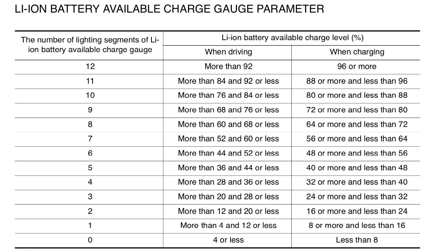

My 2012 Leaf bought in Dec 2011, never fast charged, low mileage, now has around 80% (between 76% and 84% based on the dash bar indications per Leaf table) of it's original capacity after 13 years of ownership. Still a useful vehicle for local driving which is all I ever did with it.
Ford F-150 Lightning Charging to 100% guage indication 4
I have about a 1.8% per year loss of capacity on average over the 13 years - the loss may not be linear over time.
The Ford Lightning battery warranty is 8yrs/100k miles, infrequent fast charging probably wouldn't push the battery into warranty territory (below 70%). But somewhere Ford the recommendation/best practices is to 100% before a long trip, but to no more than 90% for daily use, among other things.
