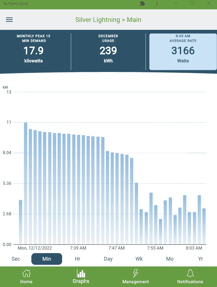

The cost @27/c-kwh to pre condition the truck this morning
Ford F-150 Lightning Cold weather - climate control not great 1670850634008
Energy draw by the minute this morning 7:27 to 8:06, departure is at 8:15am
