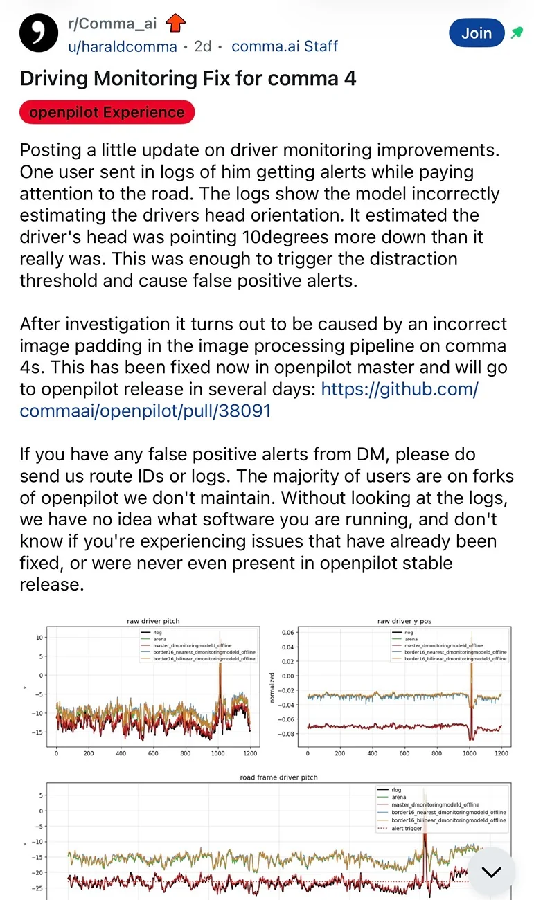

Will
Bluepilot/Sunnypilot need to be updated to include these changes?

Will
If anyone considers themselves a coder and wants to try and help get this merged into bluepilot please reach out to me.
I'm really bowed up on two big things I think you guys will love, and I can't get to it.
