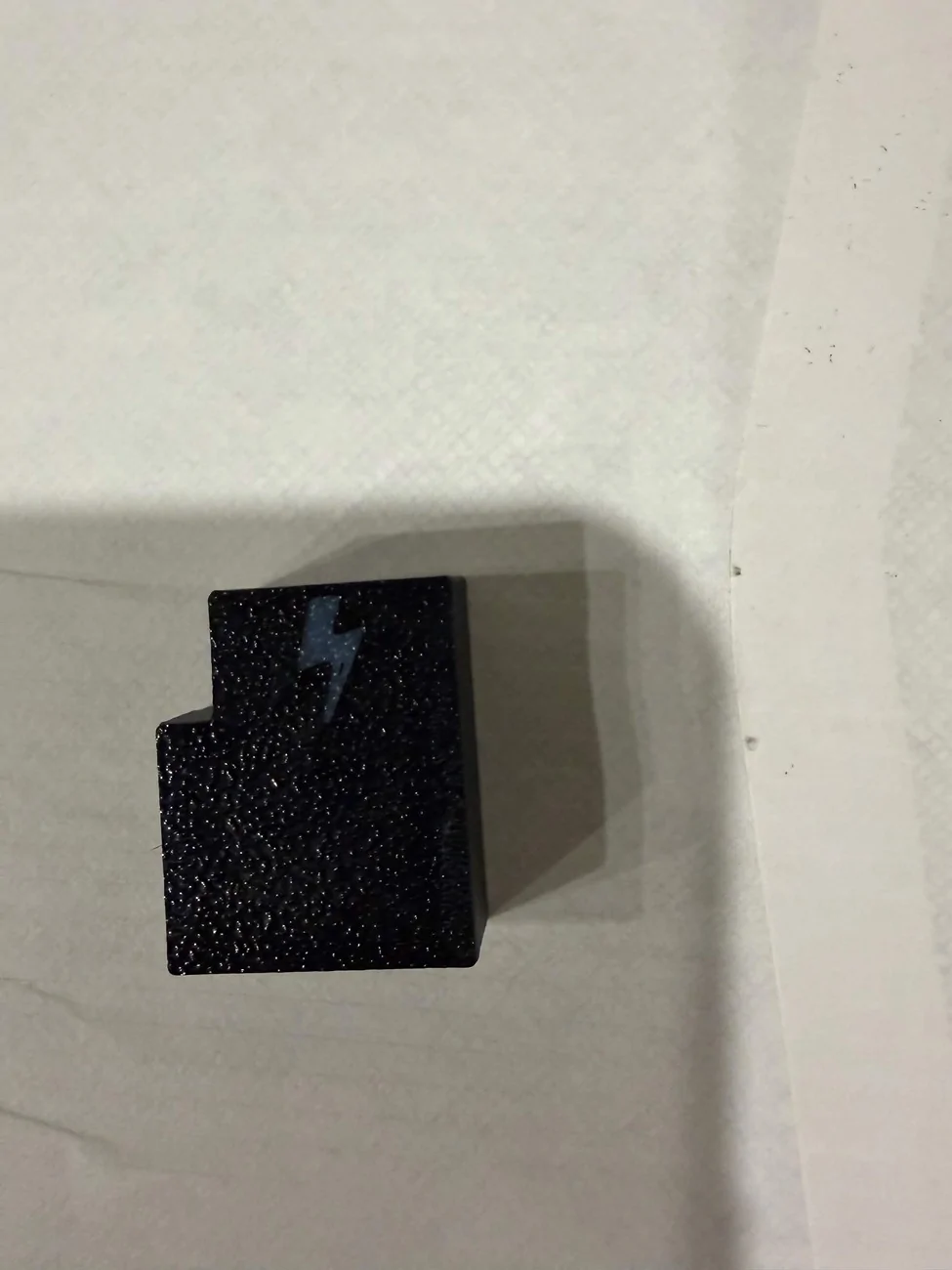

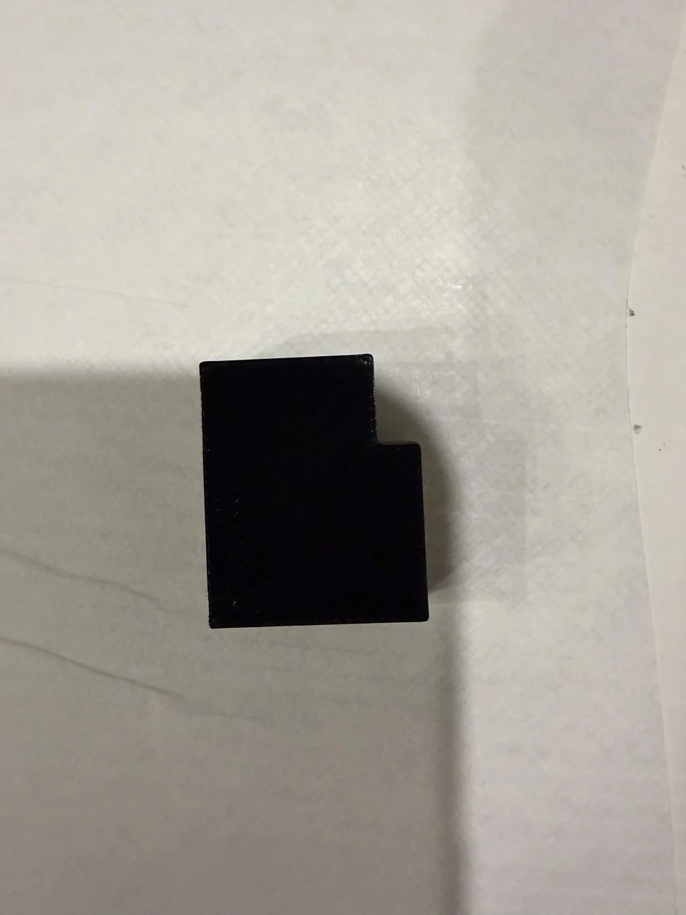

Sorry for the darker pictures - it is hard to not get glare off the TPU.
These are the v3 couplers that are currently shipping and wanted to post an update as they are a bit different than before.
They still function the same as before and the lightning end will still go towards the truck. The main difference is that they are all 90 degree designs so we could use them in the dock integration as well as stand alone. They are also printed into TPU casing to prevent the separation we were seeing with the ASA cases.
