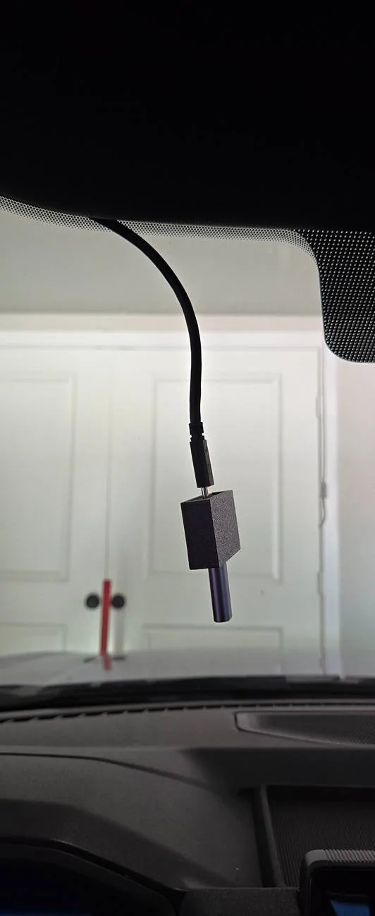

Should be installed like this.
This is the orientation where I do not receive the errors. A-side toward the IPMA.
I appreciate your persistence in tracking this down and working through the problems. Thank you!
