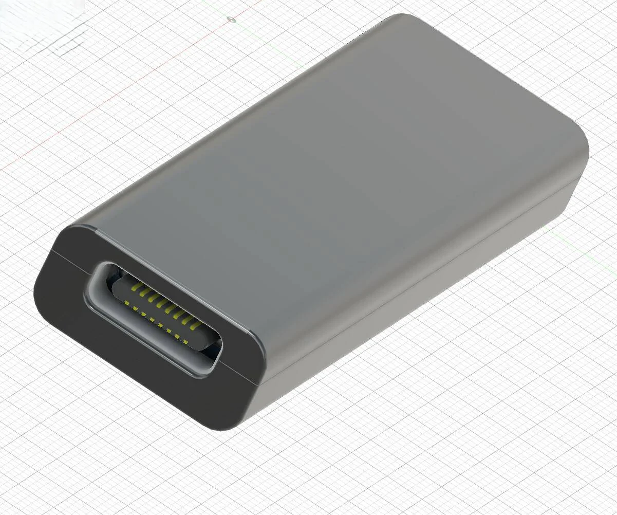

Also, here is a 3D generated image of the final adapter to give you guys an idea of what you are ordering once available. Orientation will be marked on the casing.
Ford F-150 Lightning Comma AI self driver assistant Lightning CAD generation
