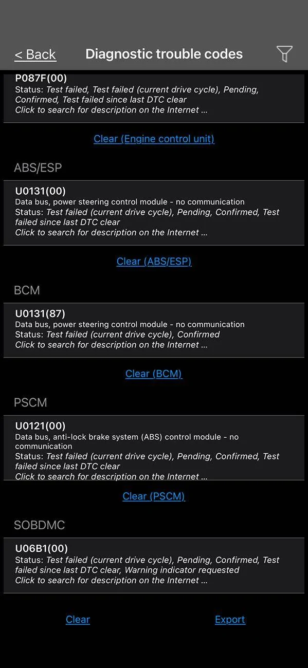

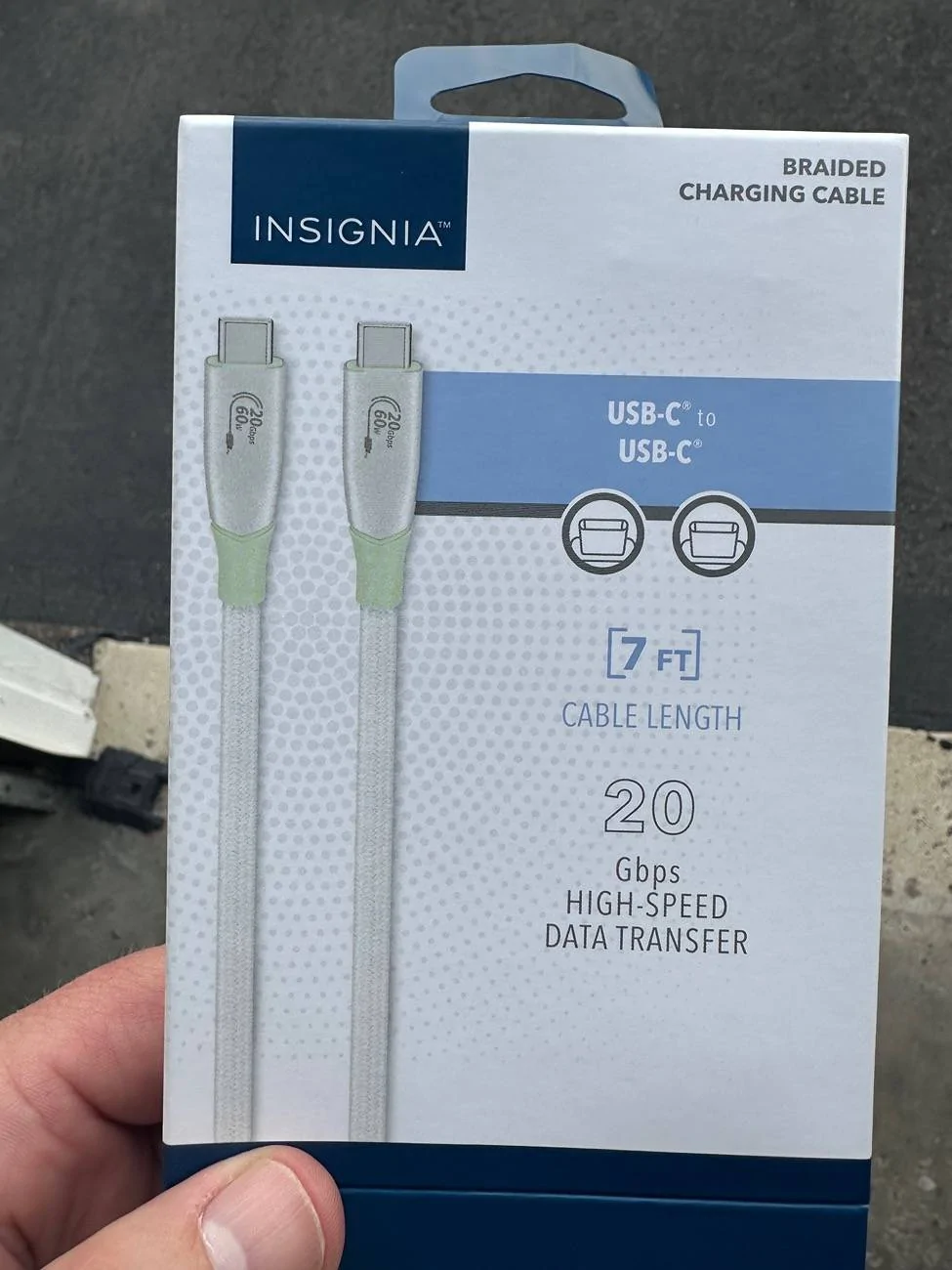

The longer drive went well. The comma unit did crash twice to the comma screen but recovered within a second or two. Steering was a-little bouncy between the lines and did cross over the lines on a few occasions. Still getting the pro collision error, one peddle error and service soon error. These are the codes I am seeing. I also included the cable I am using.
I suspect the cable is the issue.

  2. Alan (@Ajzride) and I revisited the USB-C cable discussion offline, and we’ve agreed that going forward, USB-C 3.2 Gen 2x2 and USB4 are the only cables we will recommend. These are the only ones that include the necessary internal connections by specification. (We are working on finding specific cables on amazon that are known to work to recommend).
