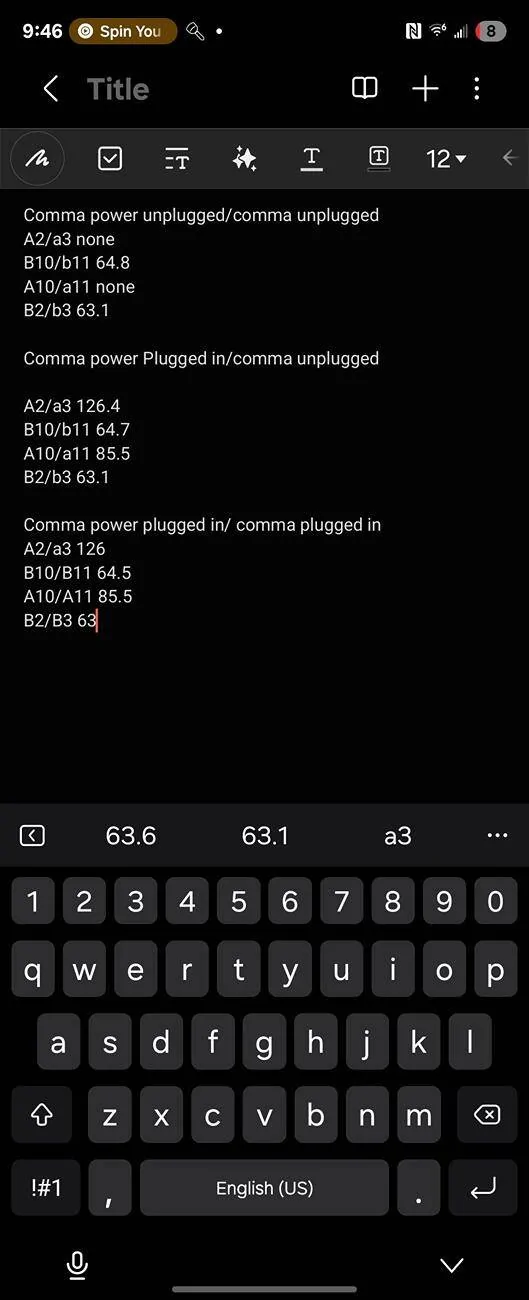

The pins don't match their designations since Alan got a reversed set. But you can see one of the 128 readings is sitting at 85 on the lightning which is causing reflections for whatever is on that Bus. The PSCM disconnects with reflections, which is why we get a Christmas tree on startup.

The 120 drops us into over-termination territory and the 360 puts us at 55 ohms and 69 respectively. Still slightly out of spec, but within margins. I don't expect 69 ohms to matter much since that is coming from the comma power. The 55 ohms is what we care about.

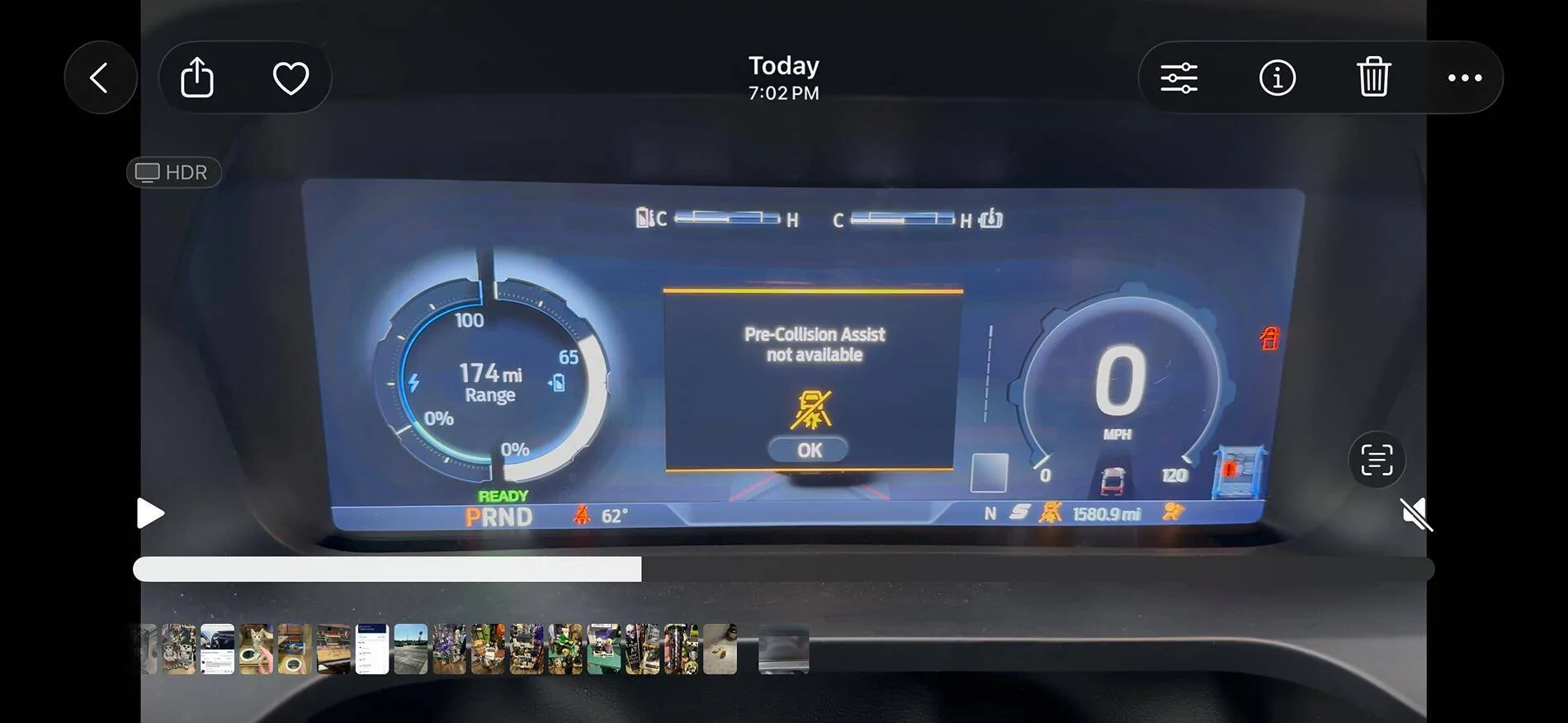

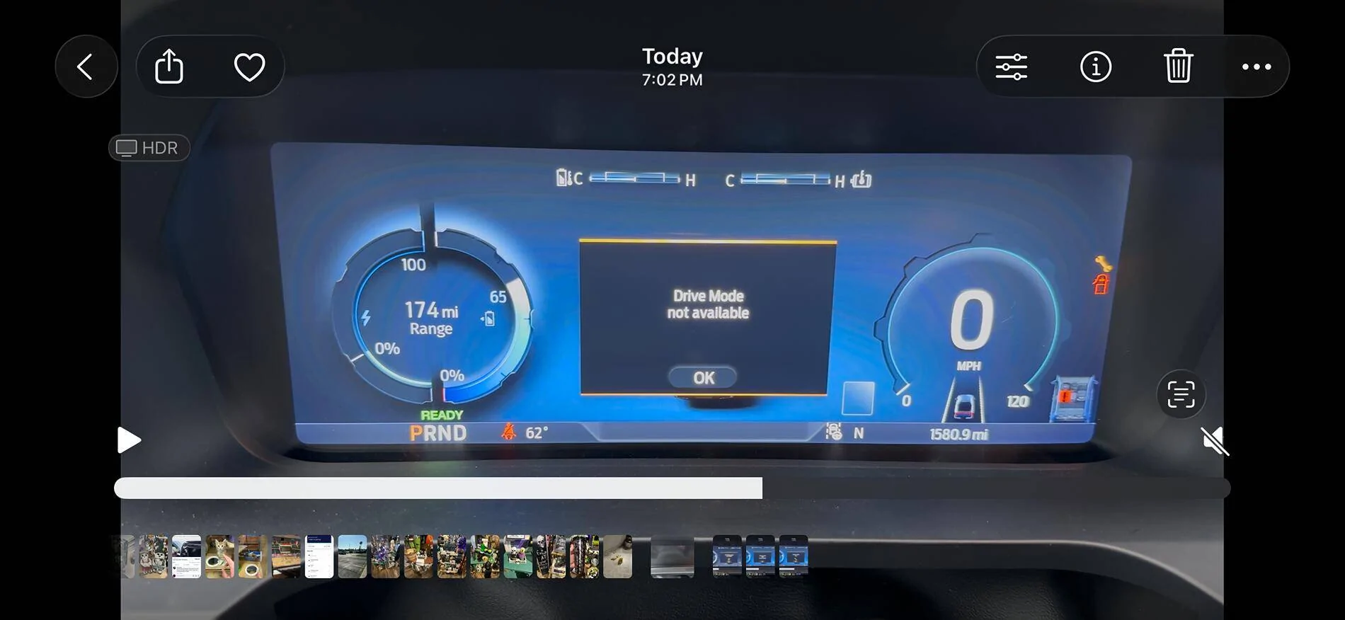

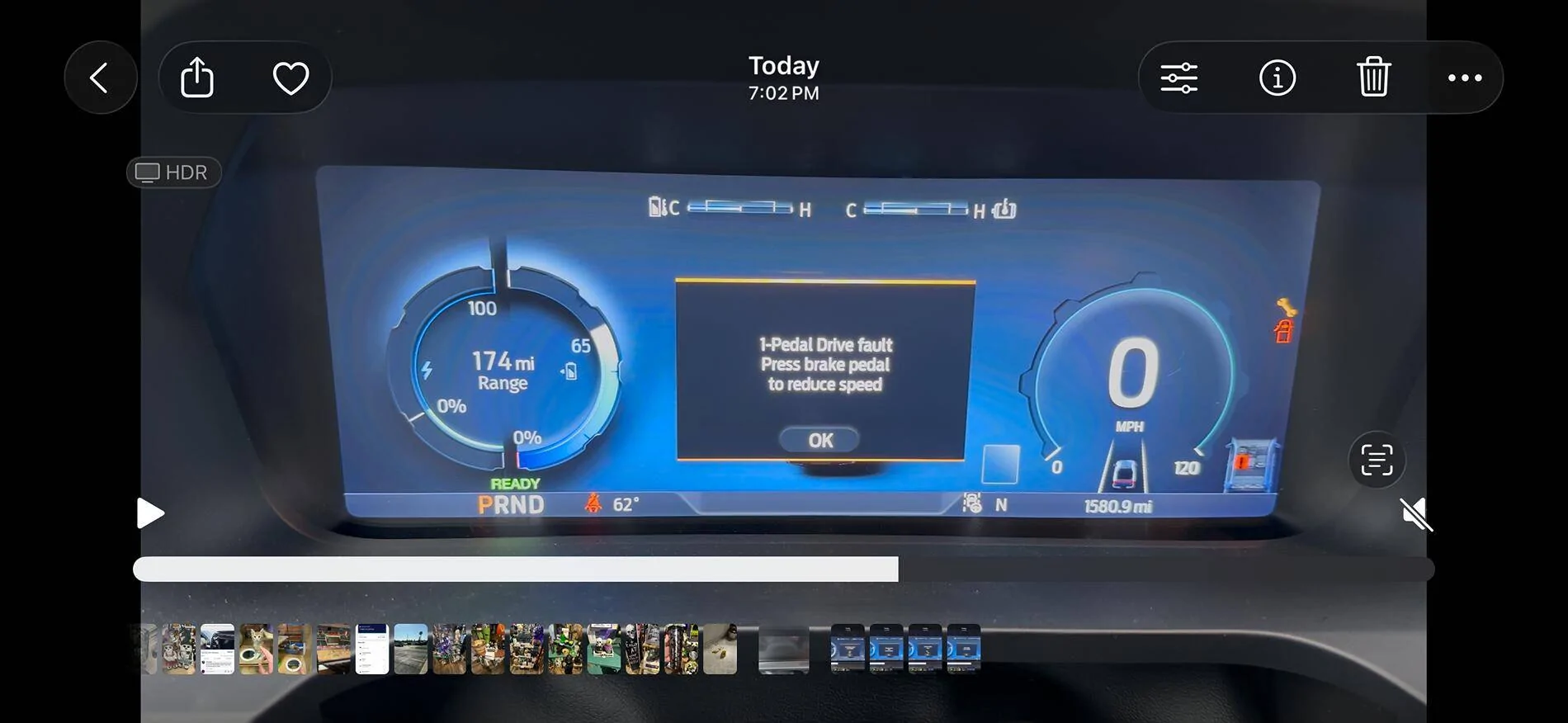

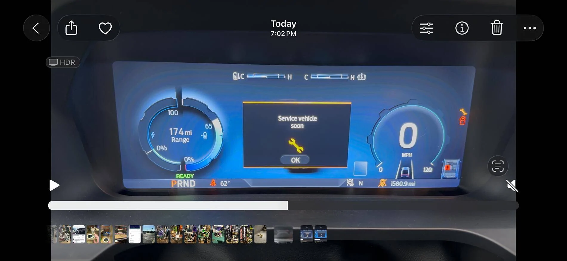

It looks like this cable from Amazon doesn’t work. Still getting errors on startup. I tried it again with the short jump only and there was no errors on startup. Should I try a USB 4?
I put on about 1,000 miles in the last few days and the was 2 instances were no errors appeared for a section of the drive. If I clear the codes after startup they do not come back for that drive.
Do the errors only exist at startup or are they sticking around once the comma is up?

The stick around
I have the Comma powered by the OBD port so it stays powered up. The codes stick around and do not clear.

The stick around
So an important thing to keep in mind is that it doesn't matter if the hardware is powered on. It matters if sunny pilot is up and controlling the signals and hardware.
From what I am gathering, you are having errors stick around after sunny pilot boots (When the camera opens and shows the overlays), and the "one pedal fault" and "service vehicle now" are the only errors that stick around. Is this correct?
If so, you are able to clear those errors with something along the lines of forscan and they don't return until you turn the truck off?

Thank you for clarifying. You are correct the only errors that stick around are the service vehicle now and one pedal fault.
I clear the codes through car scanner app and a Bluetooth connection that I use for ABRP. The code do not return until the truck is turned off.
I'm between two possible theories here,
1. You have a bad harness or box.
2. The CAN reflections are manifesting slightly different in your truck than what we normally see and are causing the one pedal to fault.
Option one doesn't make sense to me since the short cable resolves all of it for you. The fact that you can clear them with a scanner and they don't return also would point to it being caused by an error that doesn't clear once the reflections are resolved.
DM me your shipping info and I will send you a breakout so we can at least eliminate the reflections if nothing else. I will have to order a set, so it will take a bit to get to you.
