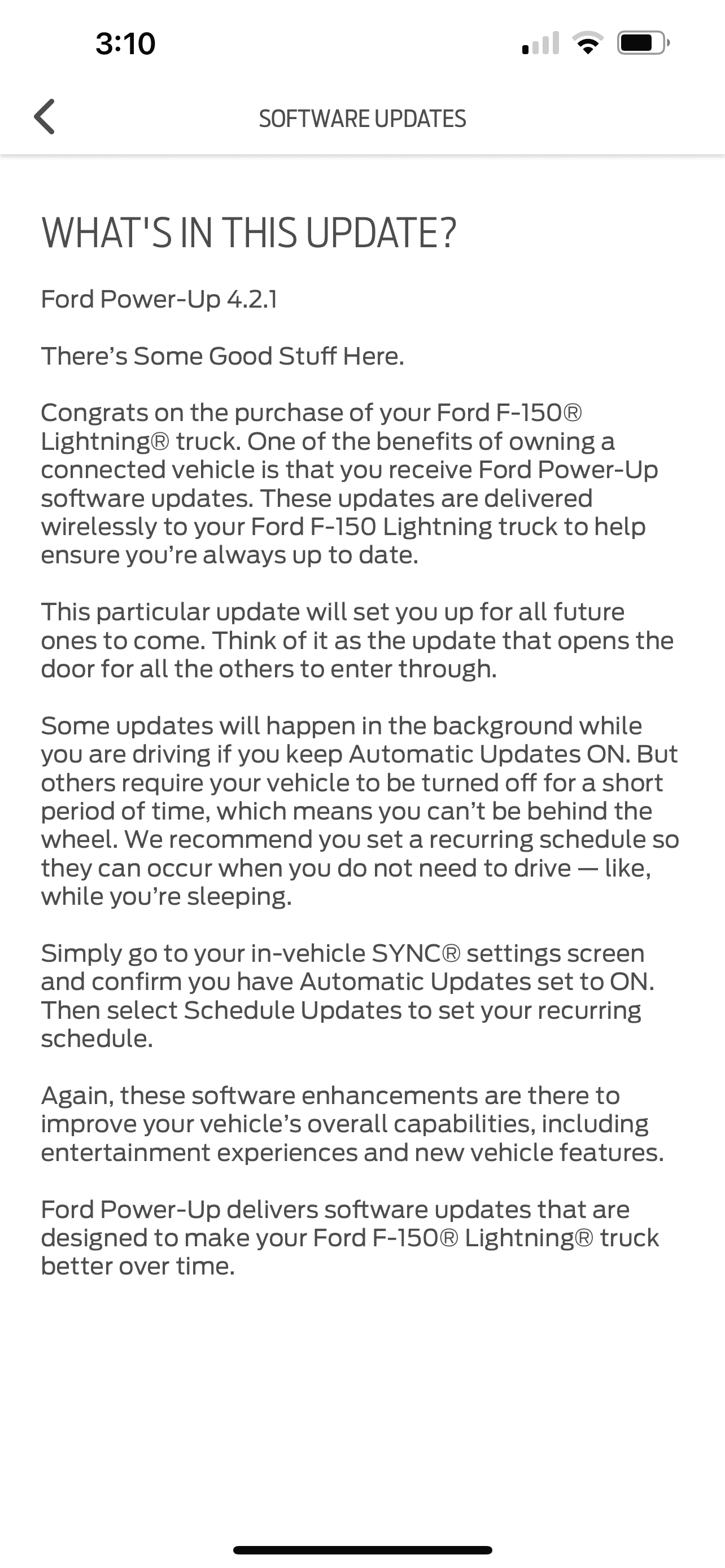

Good news! Can I pull fuse 32 instead? Can you please include the screenshot of the 4.2.1 update? I haven’t reset my truck for almost a month. It’s been frozen since Feb 22.
Pretty similar verbiage to the last 4.1.1 update to the truck
Ford F-150 Lightning Confirmed Fix for MY23 FordPass Connectivity Issue = 4.2.1 PowerUp OTA Update ED710C87-7D68-4FD1-BCA6-113EF5A0D8E0
