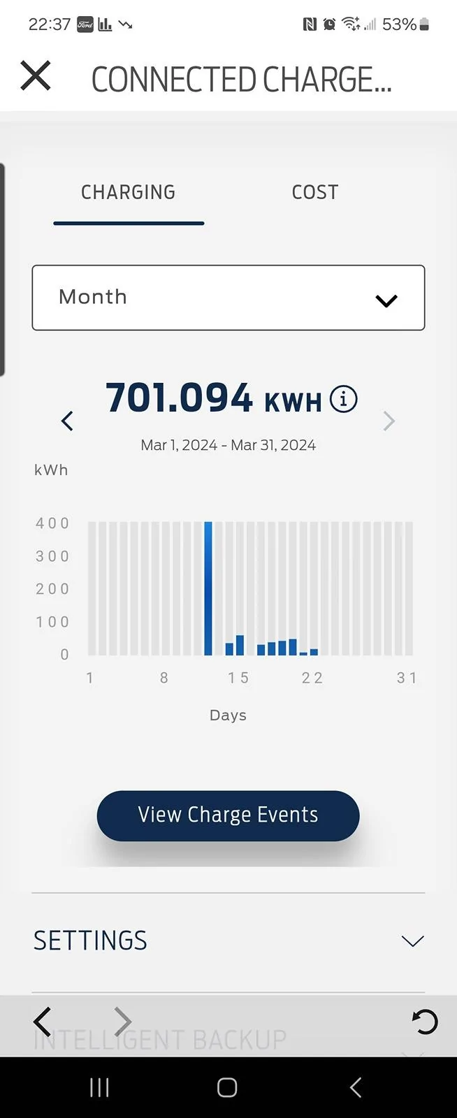

Note, due to the unreliability of the FCSP app connectivity I essentially haven't looked at it in 6 weeks or more. Today I did a check and I could see "stuff" like usage and such like I should.
Note in the image how I somehow used more KWs than my truck can take. I have never had more than one charge in a day and seldom from "empty". In any case the FCSP or the app or the something thinks I used 400 KW on 12 March...
Well after reviewing the image again, I wonder if it's the sum of the first 12 days since I apparently didn't charge from 1 through 11 March?

You could cross reference the CSP data with the Charge Logs data in FordPass to verify your hypothesis.

I got a high number like that after using Pro Power during a power outage last month. The truck was not connected to my FCSP at the time the power went out.

I've had that happen on a couple of occasions.
Ironically, this mornings charging detail did not post the Ford cloud.
