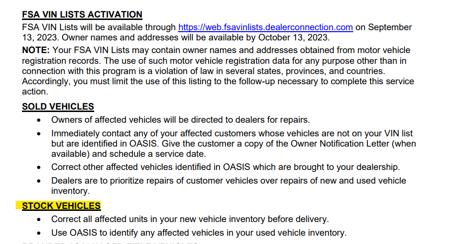

Ugh this just happened to me. I trusted my salesperson just a little too much on this and should have confirmed myself…. I’m sure will be ok, but nothing is 100% in life…. Now I have to deal with it.
Just bought a new lightning to replace my previous lightning yesterday. Anyone know if 23B57 should have been performed before they sold it to me? Does ford not have a stop sell order on new on lot lightnings that have not had the 23B57 performed yet????
I am a bit upset at dealership to say the least for not having done this yet before the sale based on my previous lightning experiences…. I was told all updates and recalls had been done on vehicle as of yesterdays date. Obviously I did not find out this until this am when I called service department and gave them my vin to double check what the app was showing. Seriously?
Dealership purchased from is couple hundred miles from where I live. Not going to be convenient for me at all…!!!!!
