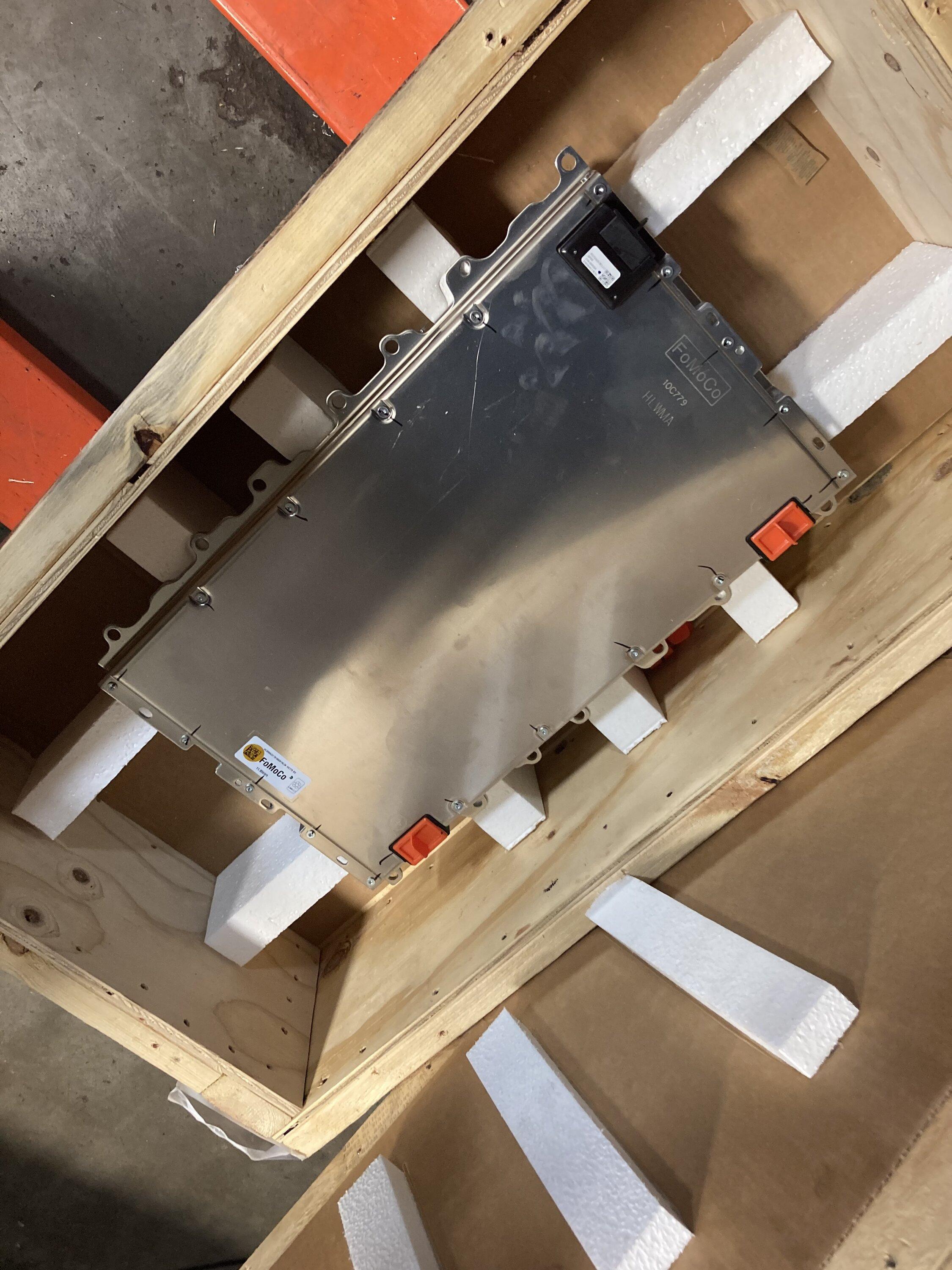

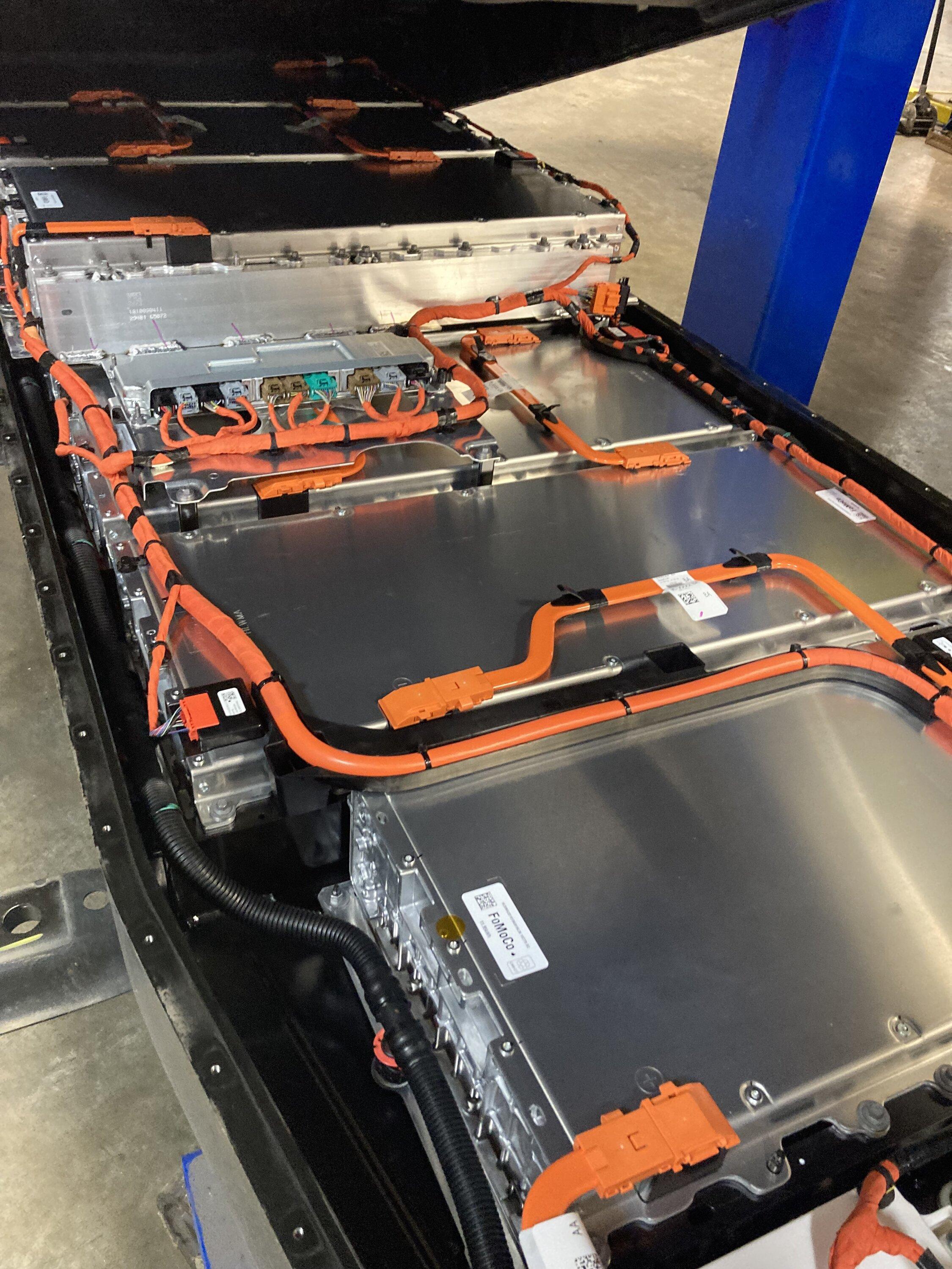

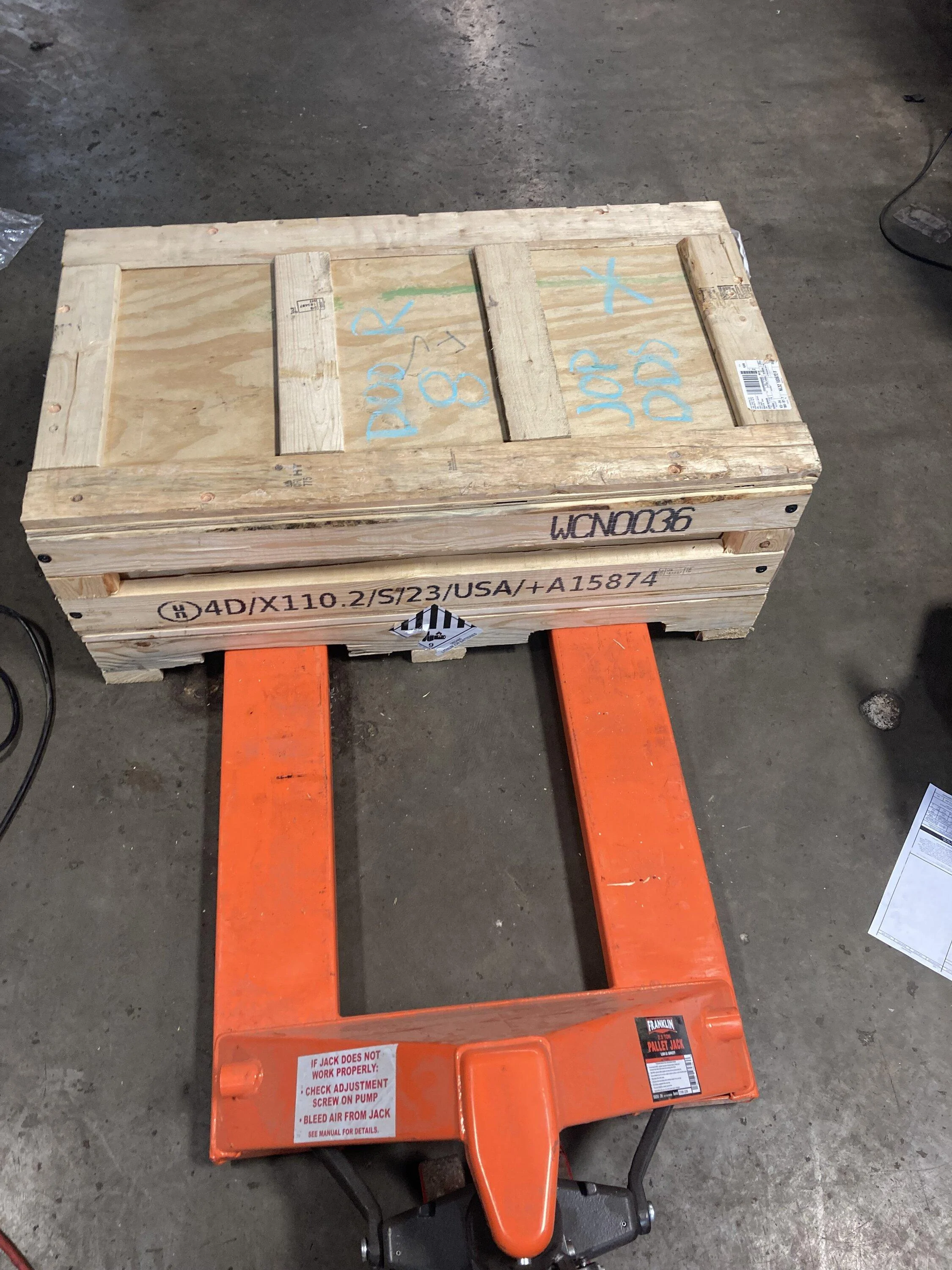

Oh here is a photo of the defective dead on arrival they shipped to my dealership for the 1.5 day estimated time frame and job when I first took truck into dealership on December 5th 2023, it’s still there. Factory original modules plus the bad one they shipped to dealership for the repair. No follow up at all from Ford still to date on a replacement time frame or repair ETA. All time estimates have been far from the truth, ugh. ?

Wow…I’m really sorry to hear that. I wonder why some are having these fixed within a week, and others are taking much longer? Are they waiting for a part that others aren’t having to be replaced?
Nope just Module 9.
Shop is fully EV certified and everything.
Just super bad luck I guess.

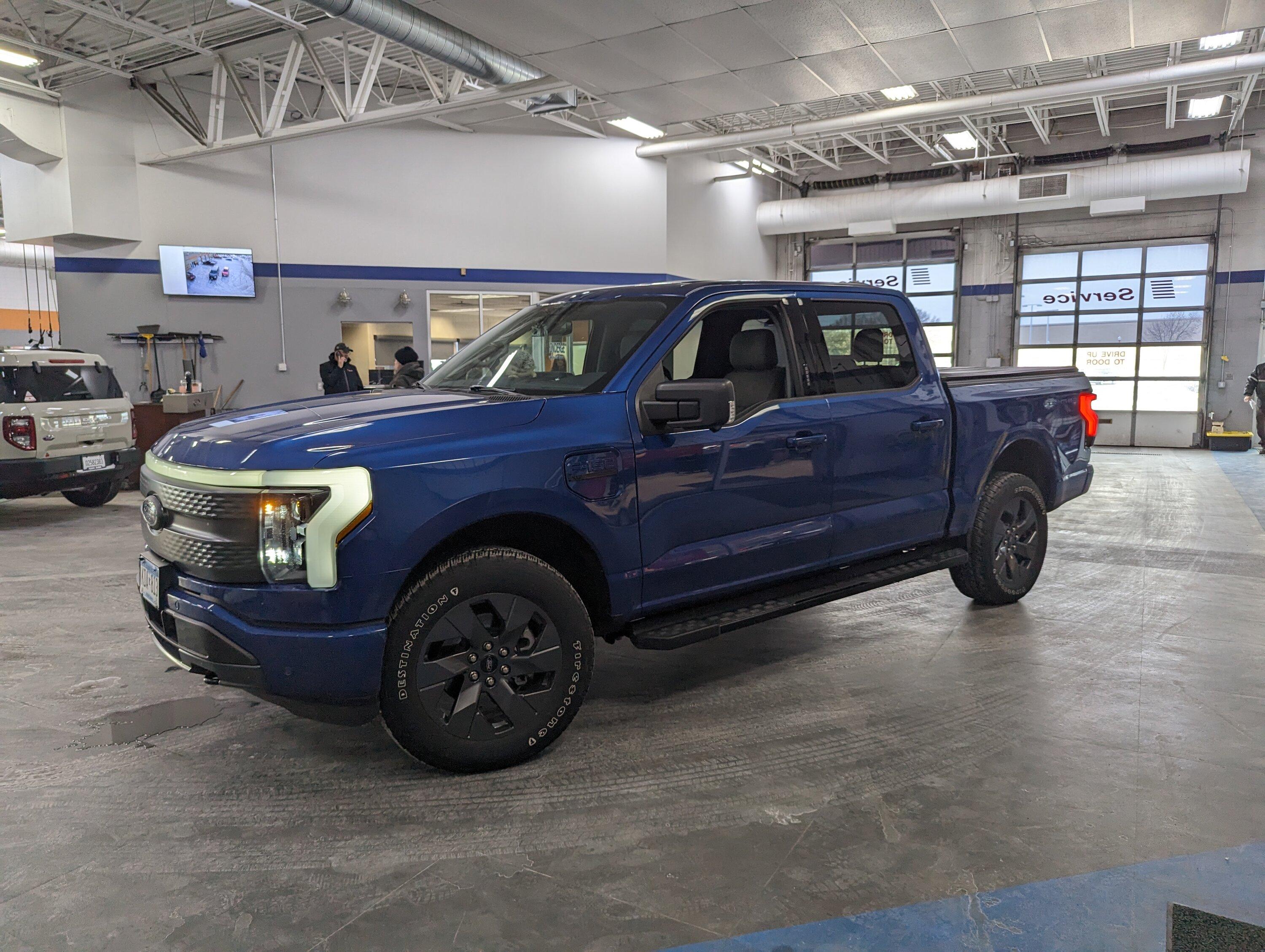

I made it down to the dealer this morning without issues. It gave me 58% power the whole way, which felt completely normal unless I really stomped on it.
They gave me a Ford Edge as a loaner, which cleared some things up for me. Getting into that cold ICE car at 6º reminded me why I put up with EV quirks and public charging. And it’s no wonder they can’t give these things away…I’m sure it would have been great six or seven years ago. But what a deeply mediocre car as a $40K 2024 model.
This is my first issue in four years driving EVs. Such a big bucket of disappointment for this lifelong Ford guy. SO many others seem to have figured this out.
