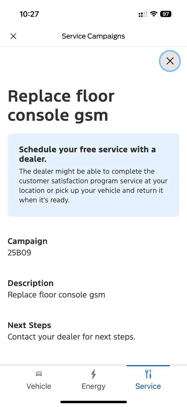

Right before I left on a month long trip away from my beloved ‘24 Flash in late June, I encountered twice within a week the dreaded glowing service light with the warning “Powertrain/ Malfunction/Reduce…” and suspected the problem was with the Gear Shift Module as had been mentioned by many in this good forum. Since the truck drove just fine and both times the warnings went away the next day, I was just going to wait to bring it to the dealer when I return in August. While away, I’ve checked on the truck a few times via the app and just noticed the attached message under the Service page. (Btw, glad to report that 3 weeks away, only 1% drop after the 1st week.) Good for Ford to be proactively doing something about this. I hope that you’ve all received this same message…

Thank you. I've learned so much from this forum thanks to all the generous knowledge sharing from good people like you. Aloha!

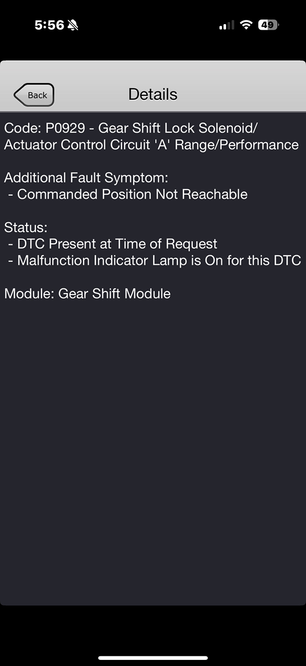

I just found this thread on the CSP-25B09 Replace Floor Console GSM letter. I posted the following in the Powertrain Malfunction / Reduced Power thread where most people seeing this Ford app error are having batteries go bad.
Ford App says Powertrain Malfunction / Reduced Power but dash display reads 100% power available no noticeable decrease in power, but not pushed hard. (seems extreme for a bad shifter)
Service vehicle soon, Orange Wrench on dash display, 7435.7 miles on a 2024, April VIN, G in the 12th position.
Forscan picks up a Code: (this is pretty damming)
P0929 – Gear Shift Lock Solenoid/Actuator Control Circuit ‘A’ Range/Performance
Additional Fault Symptom:
- Commanded Position Not Reachable
Status:
- DTC Present at Time of Request
- Malfunction Indicator Lamp is On for this DTC
Module: Gear Shift Module
This is probably the fifth time this “Service vehicle soon” has popped up starting in June and each time it has been in the high 90s F or 100s F as displayed on the instrument panel. This last time it happened after I stopped the truck, turned it off, plugged in the OBDII reader, turned the truck back on, the orange wrench was still on, took a reading in Forscan, found the shift lock error. I pushed the Shifter fold down button and nothing happened but a few wiggles of the shifter with some not working right noises. I scheduled an appointment with my local dealer and let them know about the CSP-25B09 Replace Floor Console GSM letter and asked that they order the part for the appointment.
