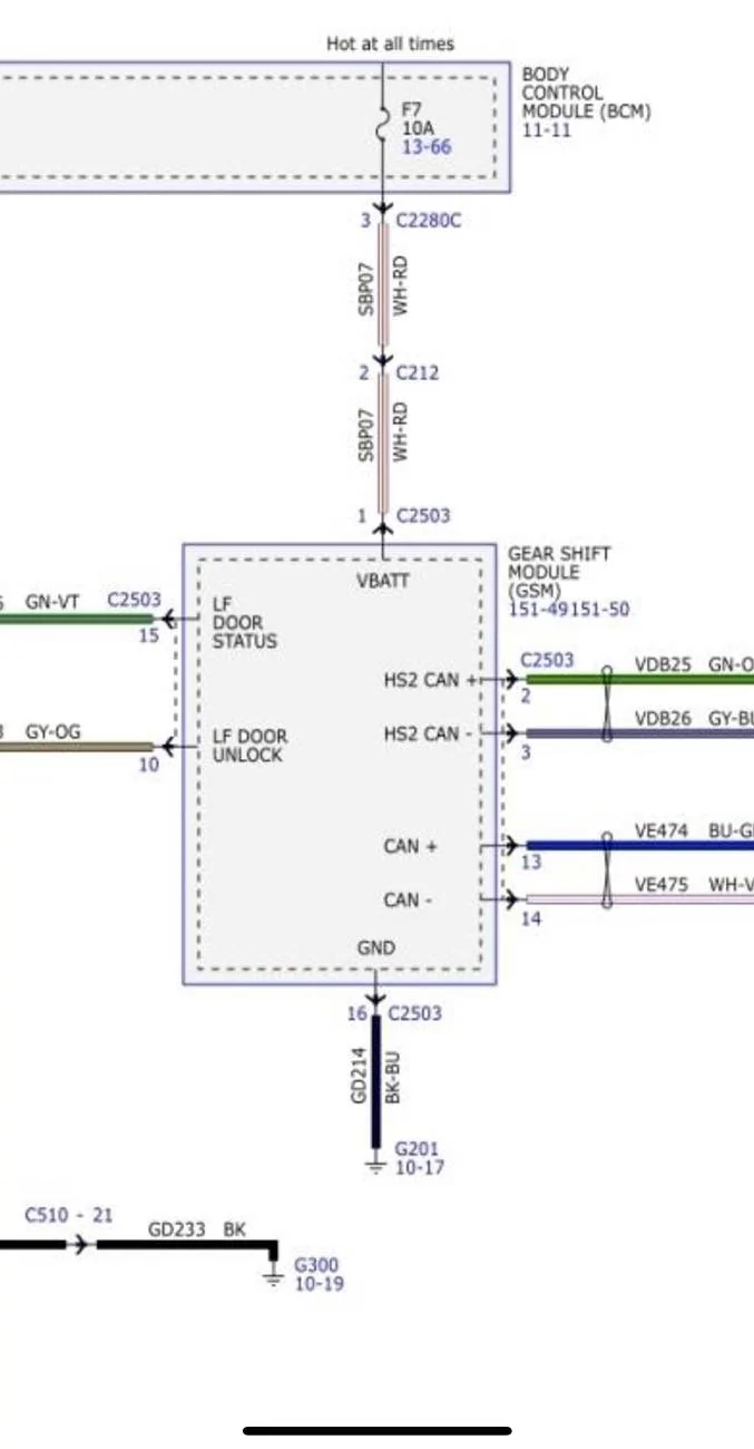

Well, no, all I was saying is that I think OP was referring to the computer module, but "everyone" is responding to the thread as if it was the physical shifter and as far as I know they're not the same / a single unit.
I’m under the same impression. The GSA (Gear Shift Assembly) is different and separate from the GSM (Gear Shift Module)
I wasn’t able to find the wiring diagrams for the Lightning but I would imagine that’s where the GSM would show up (like the below) or perhaps I’m mistaken and they’re integrated.
Yes they are integrated. Its not a separate computer that interprets signals from the mechanical shifter.

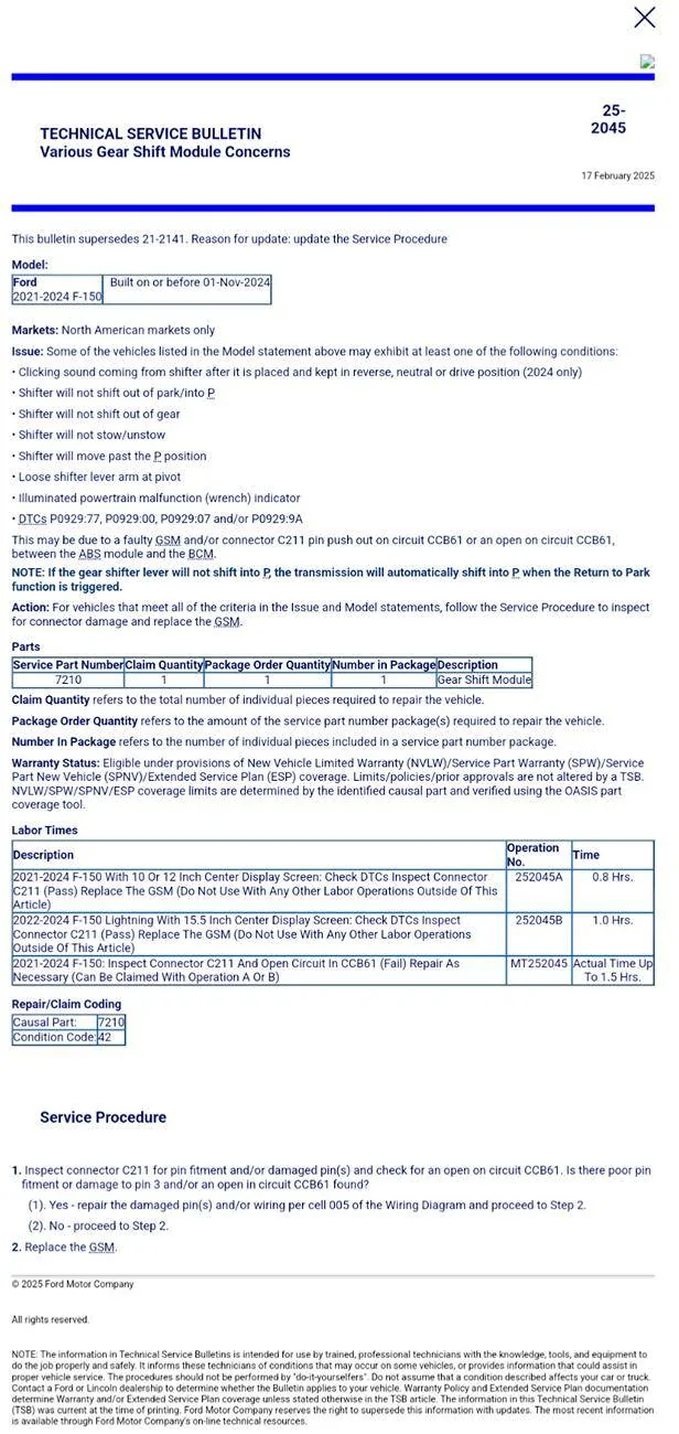

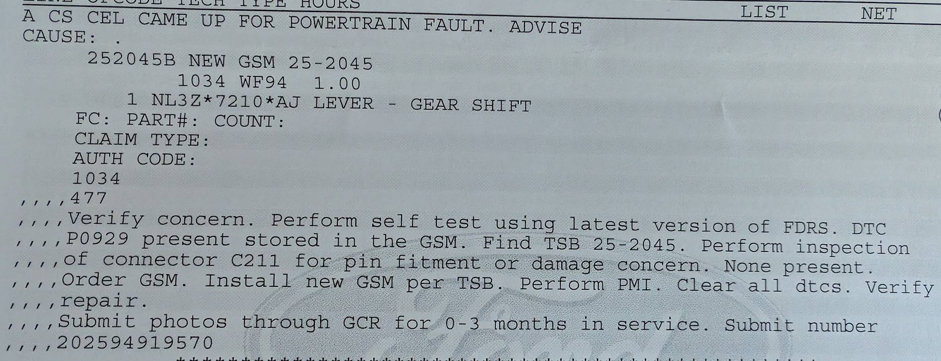

@TaxmanHog & @mr.Magoo here is the work order. It is actually called a GSM by Ford and there is a more direct part that they call the lever which is perfectly confusing.
Ford F-150 Lightning Ford stopped delivery of Gear Shift Module (GSM) 1000002927
I also found the TSB from Ford that they referenced in the work order and it can be ready here:
Ford F-150 Lightning Ford stopped delivery of Gear Shift Module (GSM) 1000002917
My dealers exact word were that, "Ford had stopped shipping this part temporarily until they could do a quality control check on the part." I haven't been able to get any more info out of Ford or the dealer at all.
