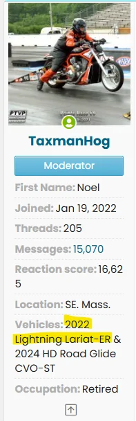

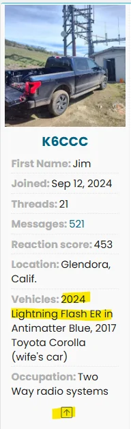

No doubt, I was digging for useful information, NEWBS on the forum should list their vehicle specifics accurately, then the number crunching can commence and useful timely information imparted on the masses.
CASE IN POINT
Ford F-150 Lightning Dc fast charger 50 KW 1756843988482-36
Ford F-150 Lightning Dc fast charger 50 KW 1756844014053-fy
Ford F-150 Lightning Dc fast charger 50 KW 1756844050370-fi
