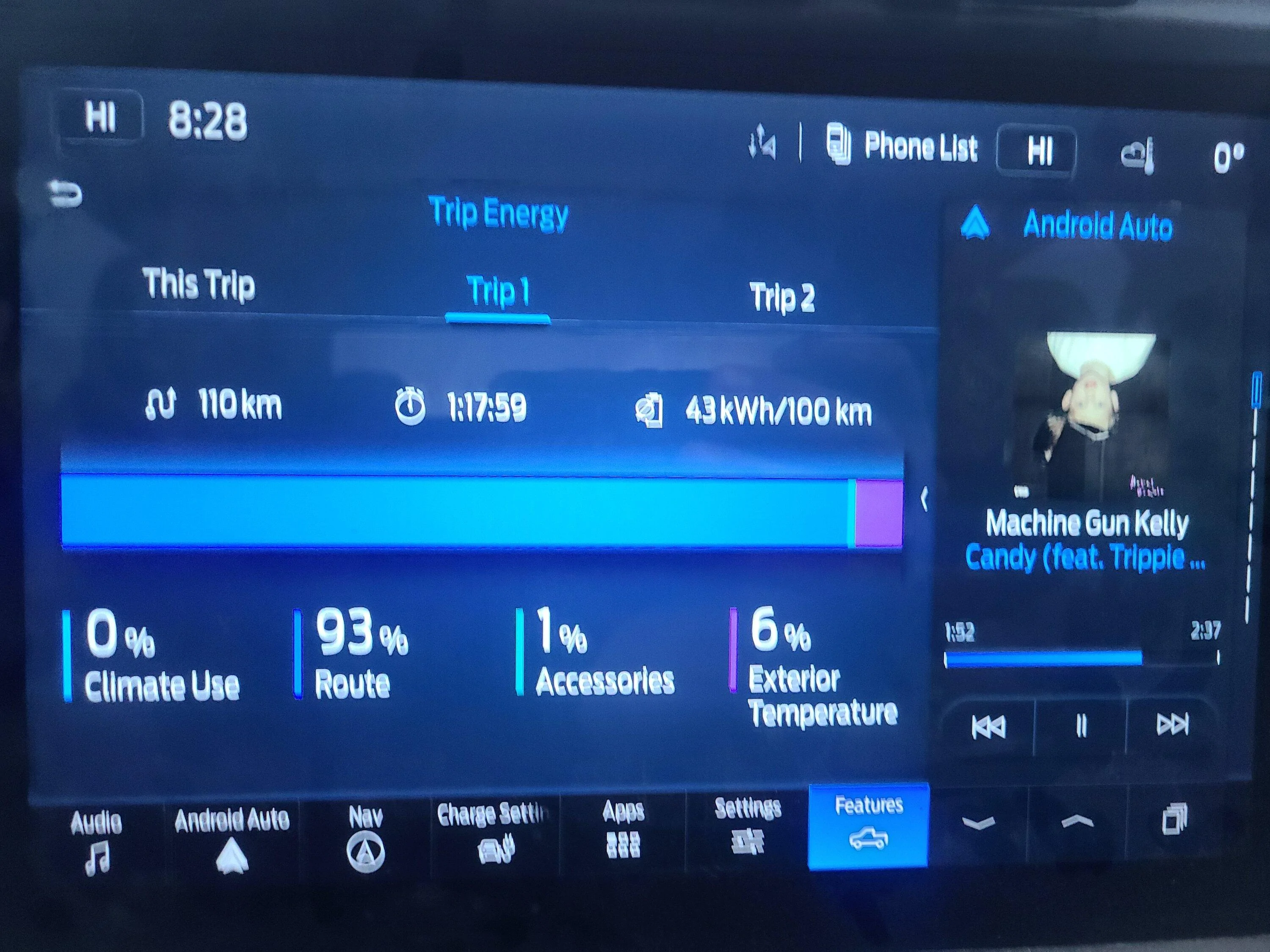

Look at the temp in the top right. I'm also towing a trailer
Maybe eventually you can get some data collection going and measure the difference with and without the aux heater? Hard to tell what you're saving in this case because of the trailer (190 mile range might be pretty good depending on what you're towing -- I assume you have the ER truck).
Interesting that battery heating is only 6% which seems quite good for that temp. Did you precondition the battery?

Yes left home battery was 20 degrees and after dcfc at 50% it was up to 30
