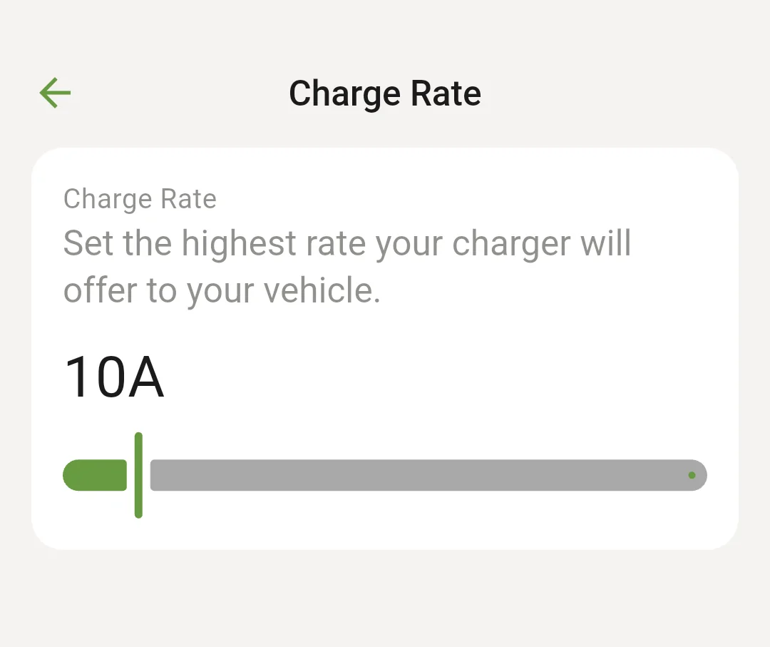

2025 Flash owner here.
No low battery issues except for one after dealer performed recall via software update in my driveway. I think the 12v battery got drawn done further than normal via FDRS updates.
I completed a long Level 2 AC charge at very low rate (2,200 watts) and it charged the 12v backup to full.
I like low rates of level 2 charging when I can get away with it. My Emporia EVSE has adjustable charging from 6 amps up to 48 amps. I can change it in the app from my phone. Very convenient.
Ford F-150 Lightning Do these 12v battery issues exist in the 2025 model? Screenshot_20260402-062027
Current charge rate (240v * 10a = 2400w. Then some losses in conversion gets approx 2,200 watts shown in Ford Pass app)
