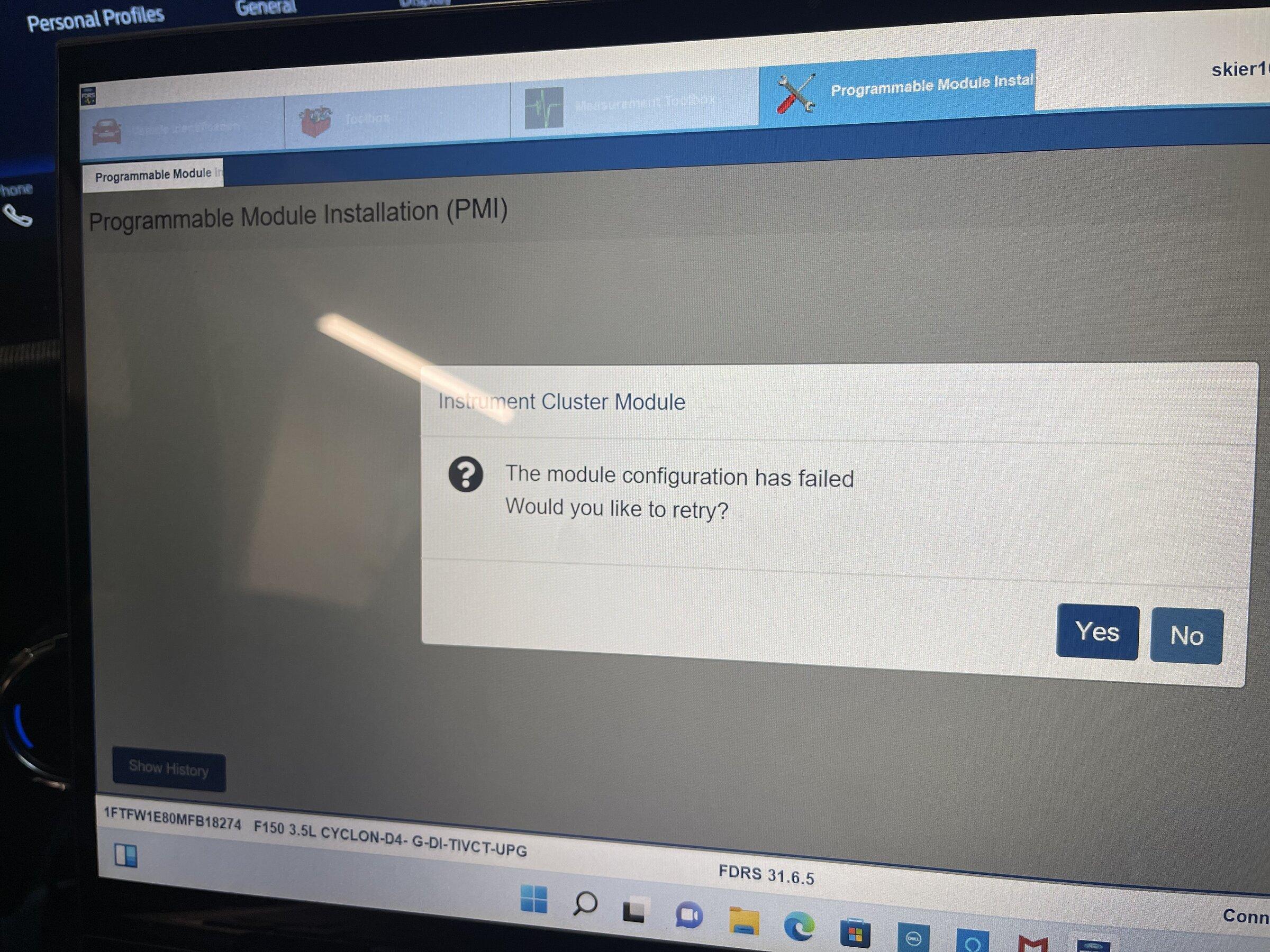

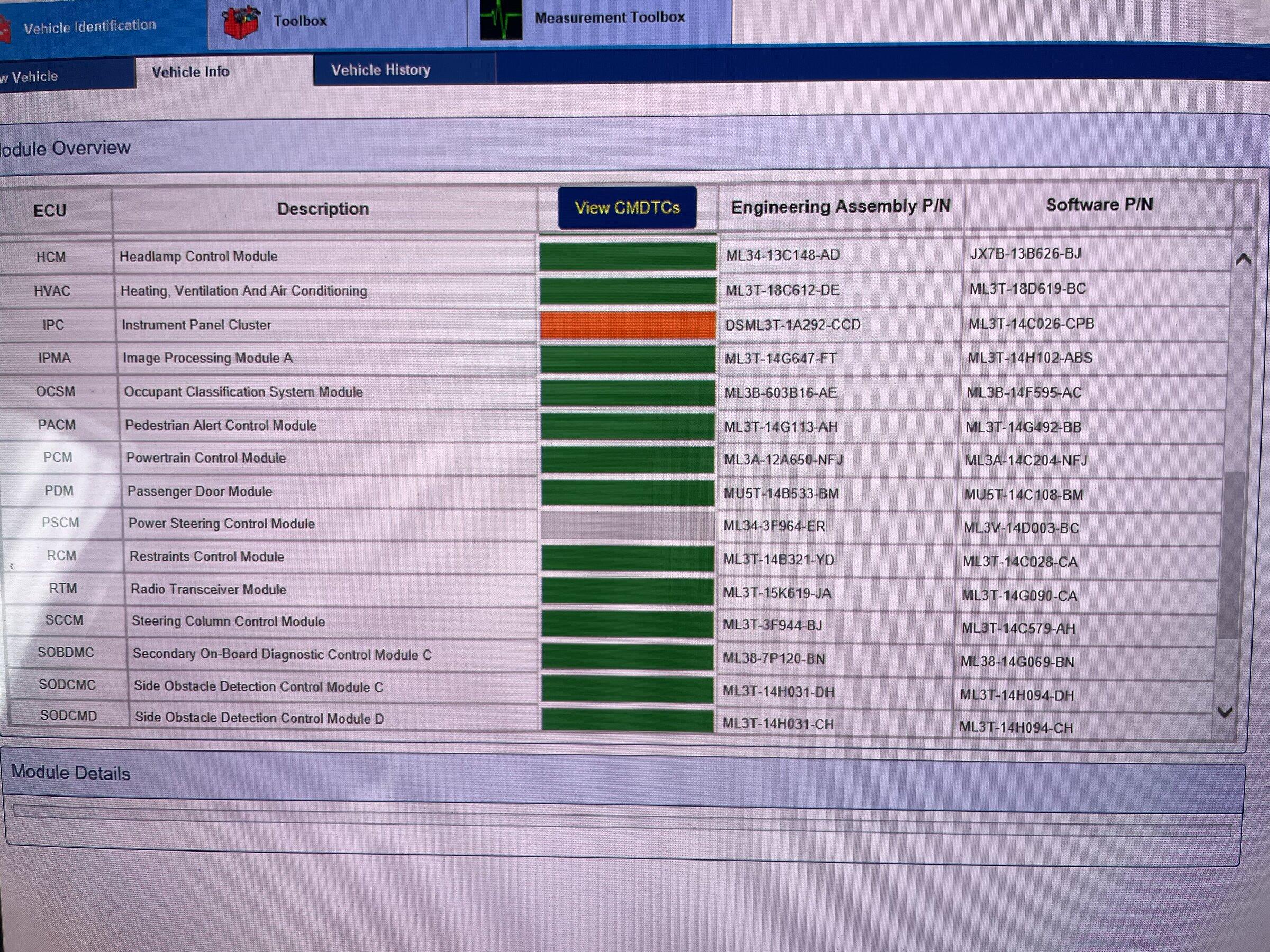

i answered my own stupid question, I can see the data in FDRS, it is corrupted there as well.
Am I destined for a dealer trip? How the hell do I fix a corrupted module?
That's not a corrupted module, you have a DTC. Can you provide us the DTC it's showing?

The DTC is U2100, no initial config. The reason I think it is corrupted is because the Part number is wrong.
If the USB update had gone through and not the CAN update I would have
F120: ML3T-14C026-CRC
F188: ML3T-14C026-CPC
If the Can update had gone through and the USB then I would have
F120: MU5T-10F906-FDA
F188: MU5T-10F906-FCA
But what I have is
F120: MU5T-10F906-FDA (USB and CAN Updates Went Through)
F188: ML3T-14C026-CPB (This looks like the USB went through but corrupted the code from CPC to CPB, and then CAN never went through).

I see what you are saying, but it's been almost 96 hours since my IPC CAN failed and I still can't PMI it or clear the DTC.
But what I have is
F188: Ml3T-14C026-CPB (This looks like the USB went through but corrupted the code from CPC to CPB, and then CAN never went through).
And as I said to @Skier167 you as well as he will have to fail the update and go the CANBus route
Also, have you made any IPC FORScan changes and if so, which ones?
