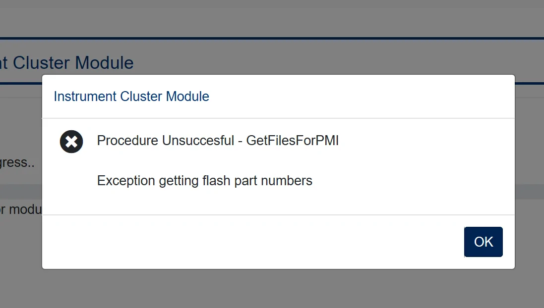

I finally had a chance to spend the day yesterday with a Mongoose and FDRS license. I have a 2021 job 1 and was hoping to finally get BlueCruise.
I had about 15 updates to install. There was no APIM update listed. All of the updates installed successfully with the exception of a GSM update that won't seem to go away and my Instrument Cluster Module. It gave me the attached error and then the update disappeared from my list. My sync version is still revision 244.

You are where several people were. The FDA is loaded. That’s actually a good thing because it’s the large file. The 188 should be fca and takes about 4-5 mins. You can try a PMI and see if it will now load the fca. If not we would have to side load that file. Yoo poop u won’t get any further until the cluster has the 188 is at fca
Thank you for looking at it! I just tried to do a PMI and received the attached error.

Ok. Well get with me and I can work with you to side load it.

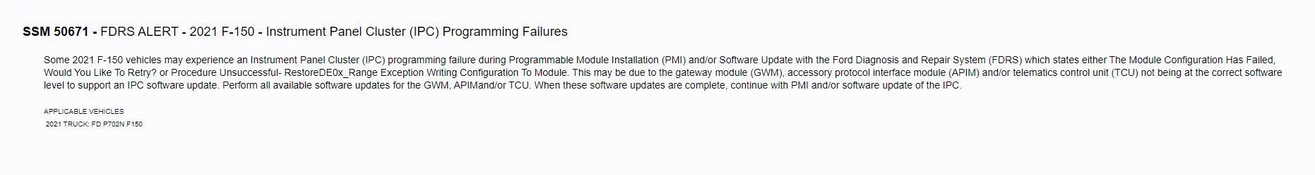

I tried updating the IPMA last night, fully expecting it to take 3+ hours, but it actually ran for about 9 hours - not kidding. Then at the end it said there was a error/it was unsuccessful. Pretty annoying. Did anyone else run into this error? Should I have updated something else prior to the IPMA? Prior to this I've updated the PCM, ABS, SOBDMC, BECM, CCM, PSCM and the CMR. Still plenty left to do lol.
Be sure to follow these directions, many modules requires others the be performed before they will take.
