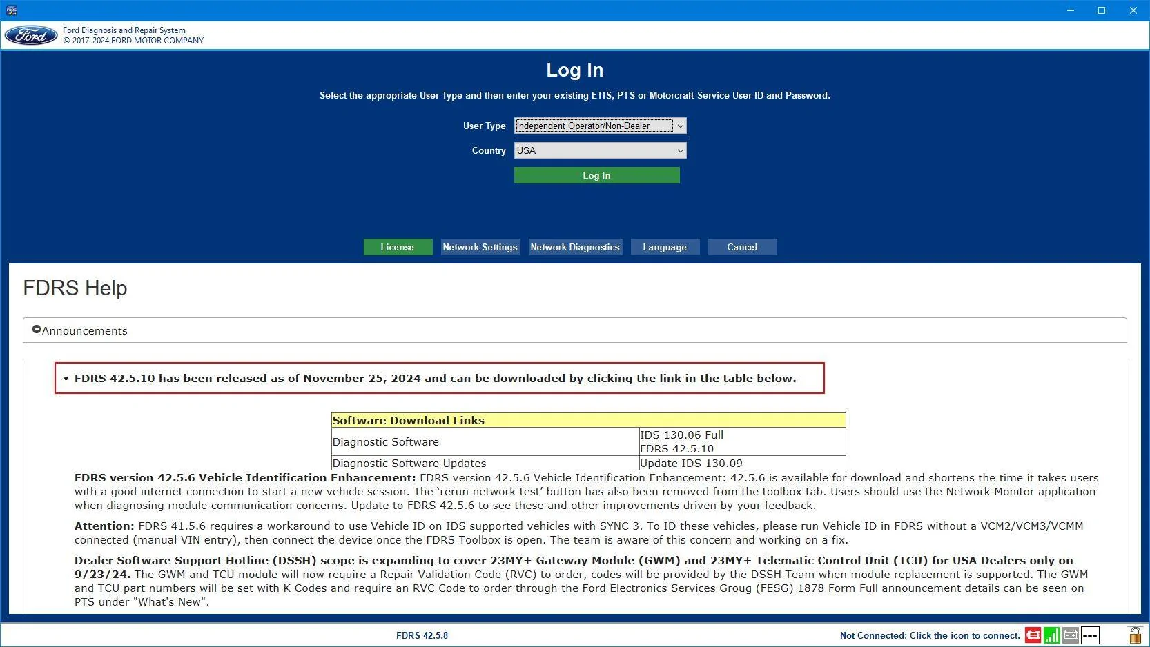

FDRS was updated to 42.5.8 yesterday.
Installed without issue.

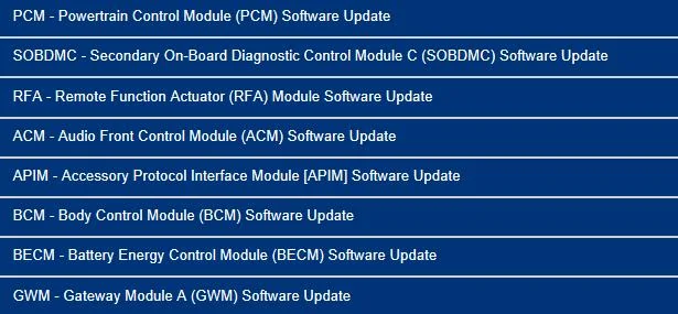

Q: For this one
https://www.f150lightningforum.com/...-now-available-for-the-f-150-lightning.22234/
Is it possible to get this update via FDRS?
Planning to do a 500mi trip early Dec, and I hope I can just spend $50 on 2-day pass to get this installed.
Break out the USB drive because it's update time!
Do the GWM first, then, if another GWM doesn't show up, do the APIM.
That should do the trick. My '22 is on the APIM rev "-NG" which I know is Sync 1270. The application manifest for the APIM in your list says it's the same "-NG" revision you'll end up with when it's updated.
You can also do the powertrain updates while you're there. In this case with only three modules in that set it shouldn't take more than 10 minutes tops for the powertrain.
