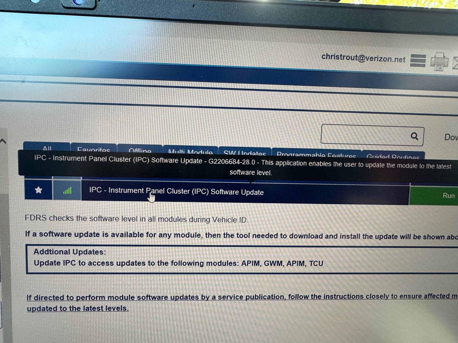

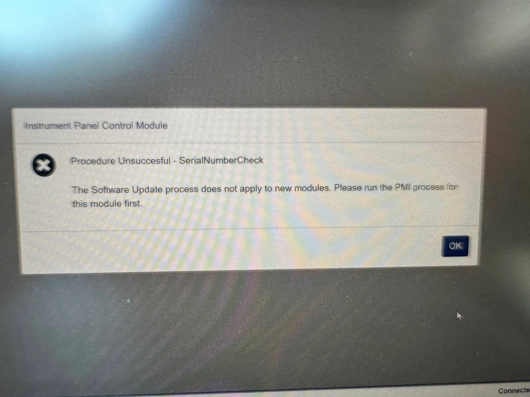

I noticed that as well and was about to post that along with a problem I’m having hopefully you or @rugedraw
can help?
got the error in the first pic when trying to install the IPC update in the second picture??
Serial mean the cluster Serial doesnt match what ford has on their server.
The easiest way to get around the serial number is to PMI the IPC..
Are you aware of the IPC ever being replaced?
PMI will associate the serial with your truck. PMI will also update.
Keep in mind the IPC update is two parts. So make sue to pay attention.
First half is USB
Second is can bus.
Need to do both halves sometimes people get click happy and miss it
