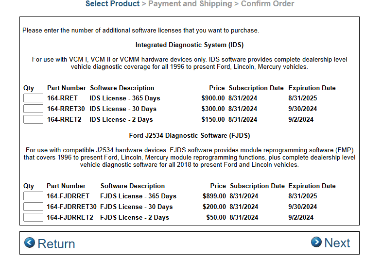

I've decided to take the plunge, and I purchased the Mongoose (which has been updated and setup), 64GB USB 3 thumb drives in ExFAT, and the Schumacher 100 (which arrives today). I decided to setup my Motorcraft account but it appears it's now tied to my Ford account (redirects you to the Ford site and once you login back to the Motorcraft service site which you have to create a new account). The "User Type" now has 11 options and none of them are "Non-Dealer Motorcraft". The most logical options was "Do it yourself". After I login I only see the following licenses to purchase:
Found the answer in posts 241-243.
Two questions: 1. Is the license valid 2 days from the time the license is installed (timestamp) or just midnight of the 2nd day? 2. Is 2 days long enough if I'm on PowerUp v4.2.3.1?
Thanks
I can't remember the time frame exactly but activating first thing Saturday morning should carry you through the weekend.
2 days is long enough to do every module in the vehicle.
