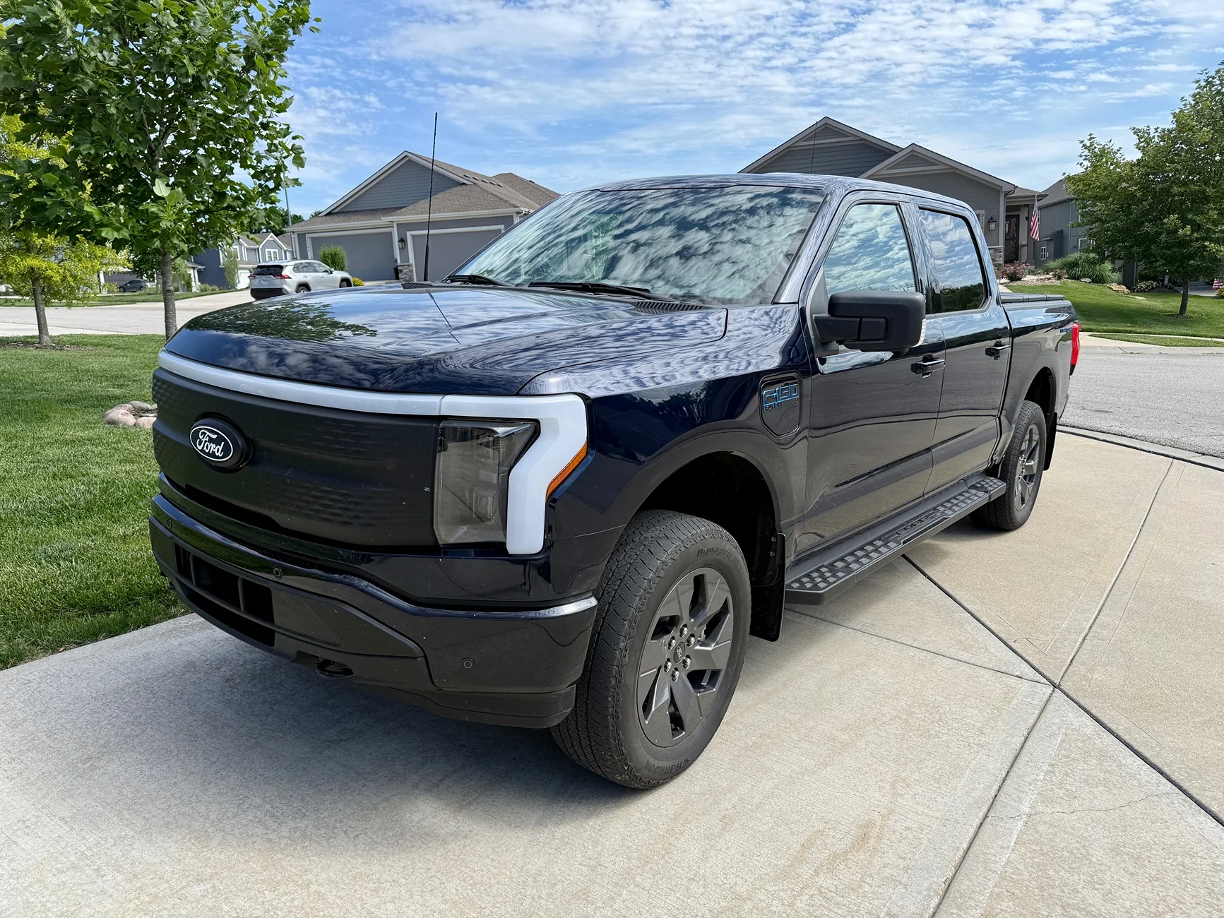

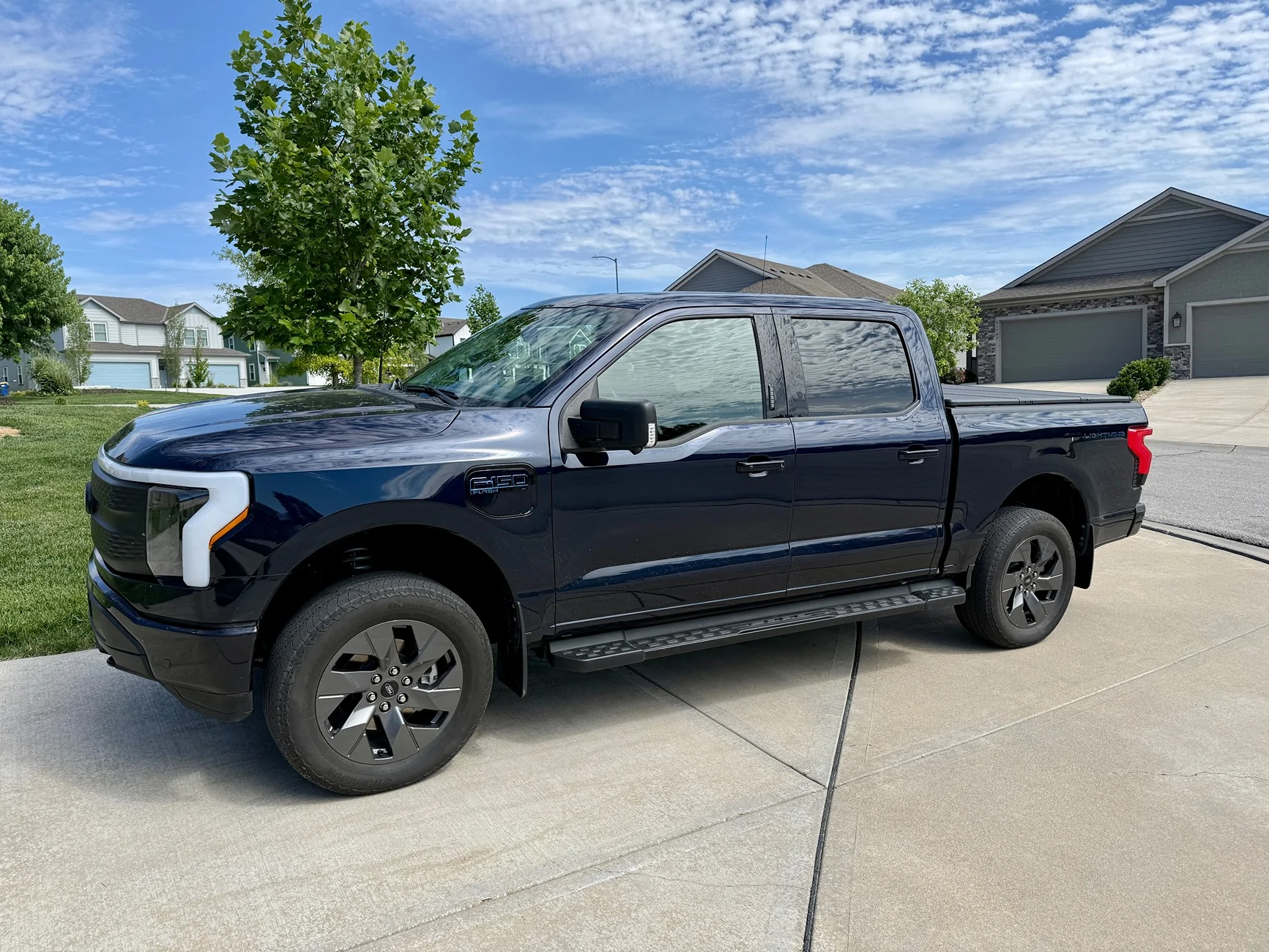

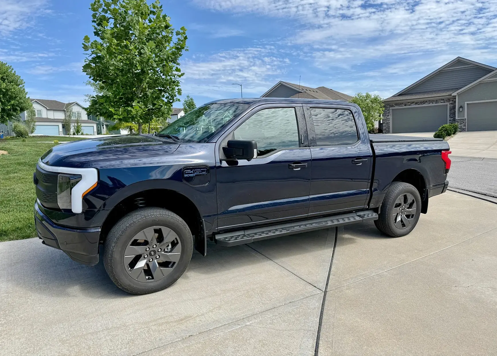

Finally got the Eibach lift kit installed yesterday. Did both front and rear and brought up the rear by about 1/2” and the front by about 3”. Loving the ride difference so far and I have about 30K miles on the truck now.
I have a set of brand new Ford Tremor 18” wheels/tires taken off a new truck sitting in the garage for when either winter comes or the factory rubber is no longer good. Might put a Raptor skid plate on too, but I don’t want to change out the bumper.
Love this truck!

Lookin good. Tires look like they need to go. Might as well throw them on now and enjoy the new look even more.

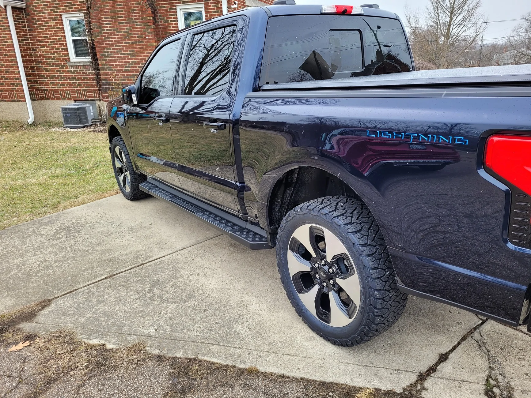

k03 34s close but don't rub on my max tow standard height, with that 35s will clear i'd think.

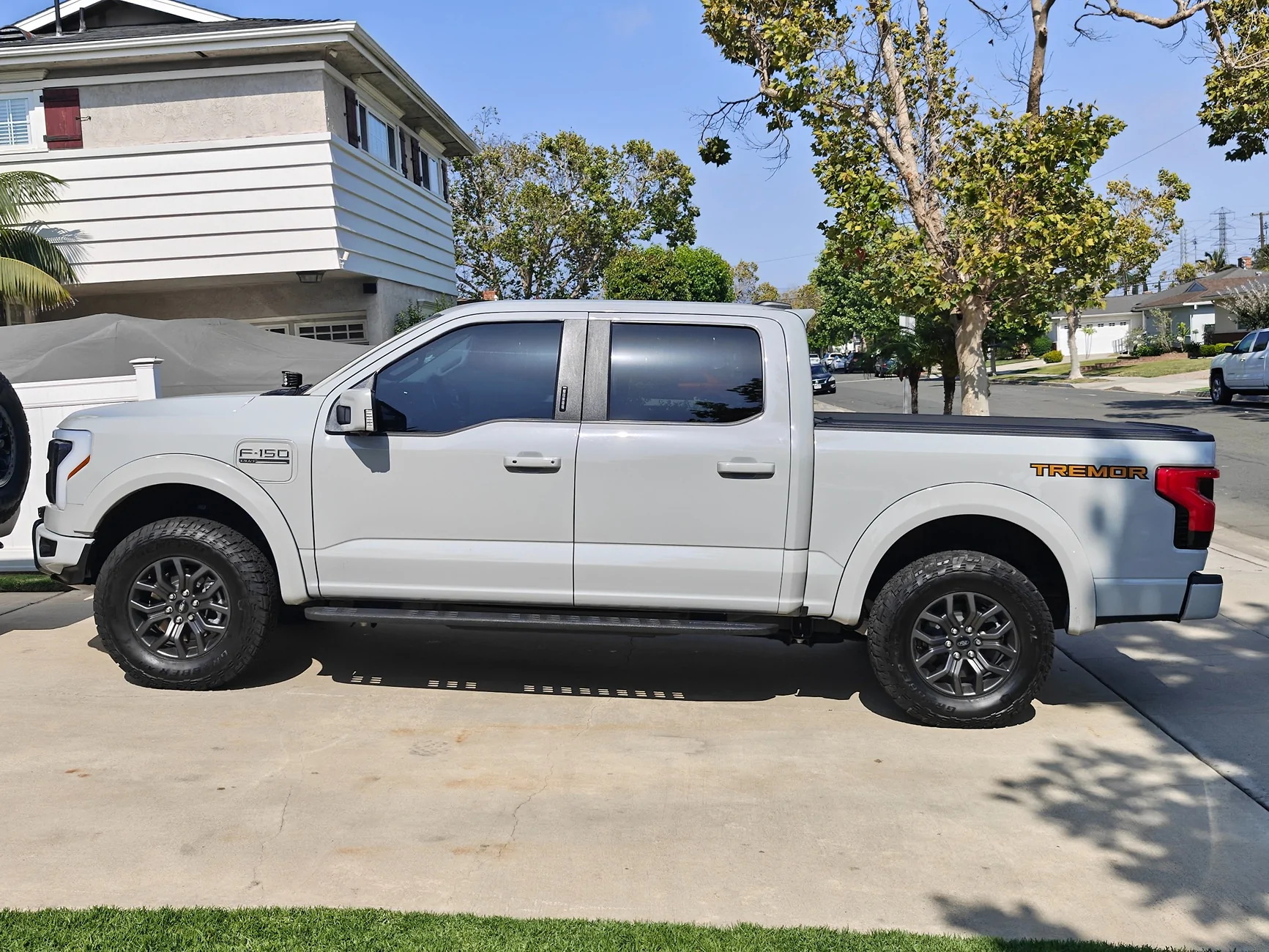

Nice! I have these going on Monday. Along with 35's. I'm taking off my tremor wheels/tires. keeping them for longer road trips. Im currently running the OEM shocks with 2 inch pucks.

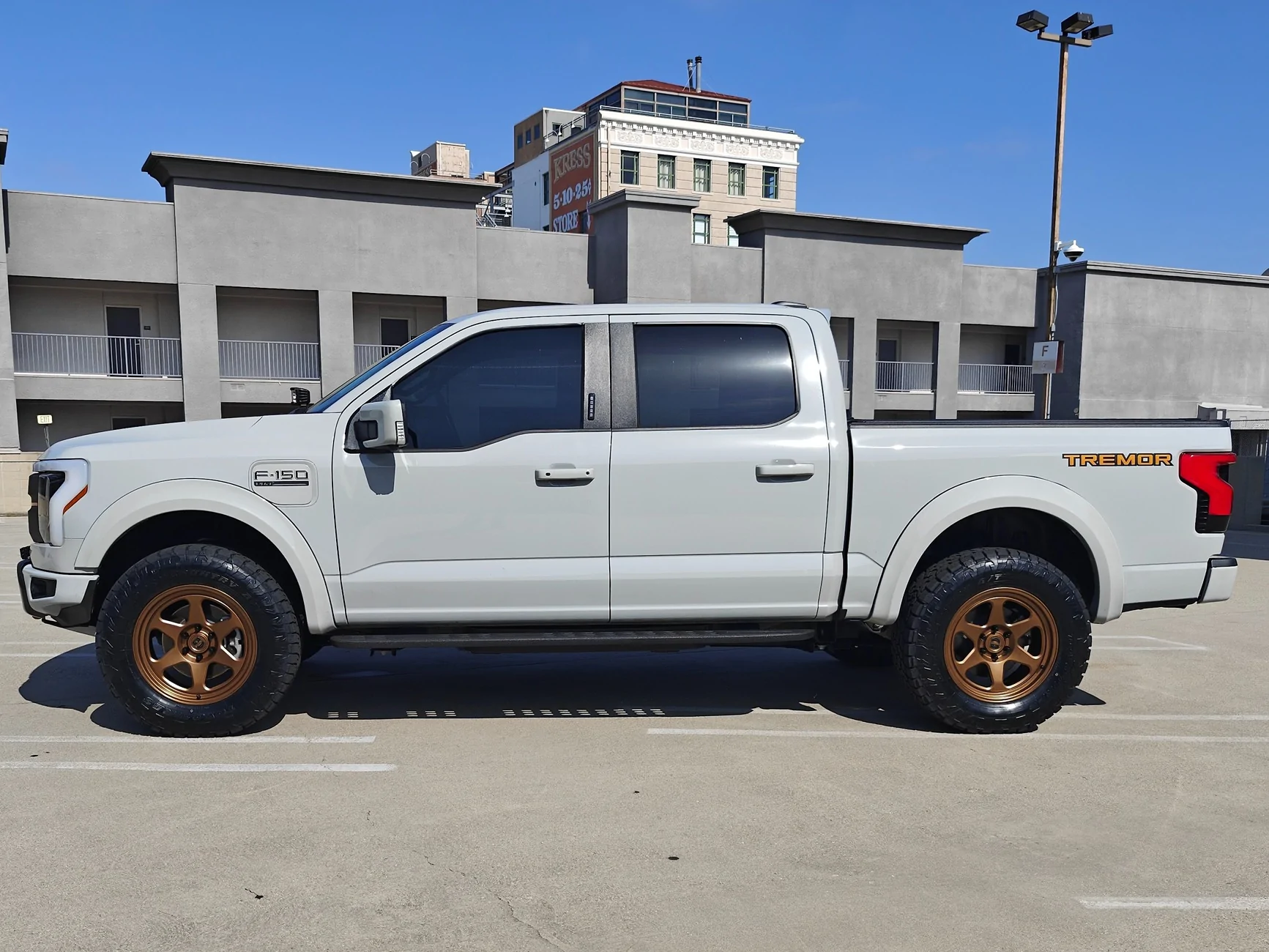

Got the kit installed yesterday. Front/rear shocks and springs. I also had the shop install Icon upper control arms. Tires are 295/65R20 Toyo Open Country AT3. Due to the 18mm off set of the wheels the shop had to cut the front crash bars and trim my skid plate. Ride is firmer than stock but I like the planted feel.
