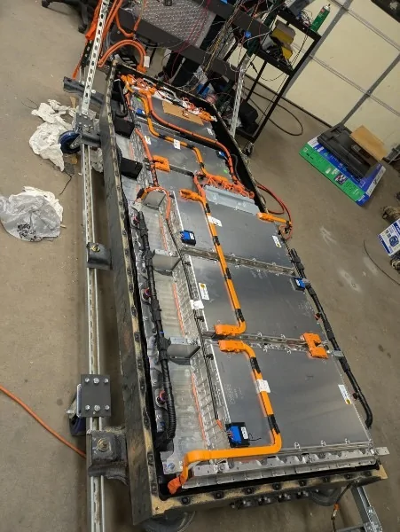

My personal confirmation of passive only balancing is from basic analysis of the BMS Module inside the battery pack and evidence of what I've seen with watching the data from my truck. I've seen 6%+ before that was reset in one night to 0.2% after charging to 100, but otherwise charging to 90 every night.
Ford F-150 Lightning Elevated HVB Module Variation (Solved post 26 & 49) 1772485211520-f
See how small the module is (thin PCB inside) and how small the balancing wires are to each module. These two facts mean that it's only passive balancing and those wires can't handle more than 5A continuous by design? So, this is why it takes a LONG time to balance the battery at the top. Active balancing requires capacitors and a much more complicated BMS power electronics. Also, Balancing always results in a net loss of energy over the pack, more so with passive balancing so it wouldn't make sense to EVER balance an EV if not charging b/c the vehicle has no way of knowing your future plans, You might need every mile of range to reach your destination.

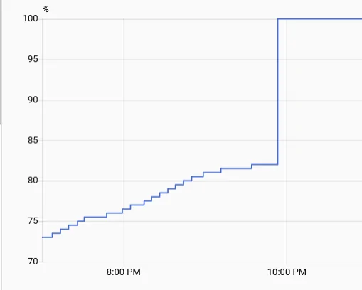

Well, looks like it's off to the dealer. Did another attempt at 100% charging last night and same result. Once it got to 80% SOC, charging slowed significantly and when it got to 82%, charging stopped and the SOC jumped to 100%. Starting the truck this morning, the truck showed 100% when I got in but as soon as I pressed Start it went to 82%. Same as others have experienced (one example).
SOC:
SOC:
Charge kW
Yep that should be your plan.
This behavior has, as far as I recall, always been a symptom of of a failed battery cell.
SOC:
Charge kW
If you don't/can't immediately drop it off try a slower charge rate if you can, seems to be about 40A already but can't hurt...probably.
I thought the same thing. I tried 40A two nights ago and 32A last night. Same result :( .

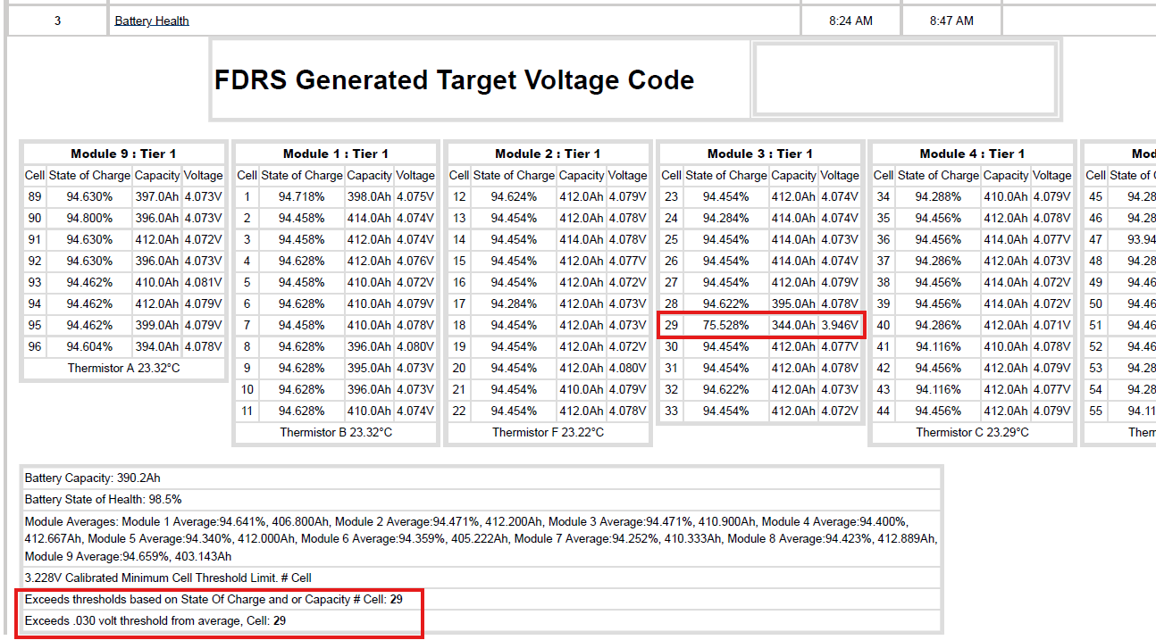

Update. Contacted dealer yesterday and they said they could get to it today so I dropped it off last night. I made sure the Advisor knew about the SSM and gave him a copy (thanks @GoodSam!). He said he had a knowledgeable EV tech that would handle.
Got a text this morning that a battery module is bad, covered on warranty (duh) and is normally $7500. No ETA on when part will arrive. Says Ford will cover a loaner.
Being curious I bought a 3-day PTS subscription. Shows tech connected to FDRS and immediately did a Battery Health test. Then spent the next hour reviewing the Workshop manual.
Battery Health test shows cell 29 in module 3 well below average:
Ford F-150 Lightning Elevated HVB Module Variation (Solved post 26 & 49) 1772665992198-e5
My last Car Scanner look was showing a 0.130 V variation from average which looks to be pretty close to the numbers above.
So I join the "two module failures" club. First one was almost exactly 2 years ago. Module 6.

Electrical Engineer

This tracks with what you were experiencing, NMC Li usable range is 3.0-4.2V,, 0.13V variation is 11%, so you not being able to charge past 85% makes sense, the BMS couldn't hold back 95 cells while trying to pump up cell 29.
