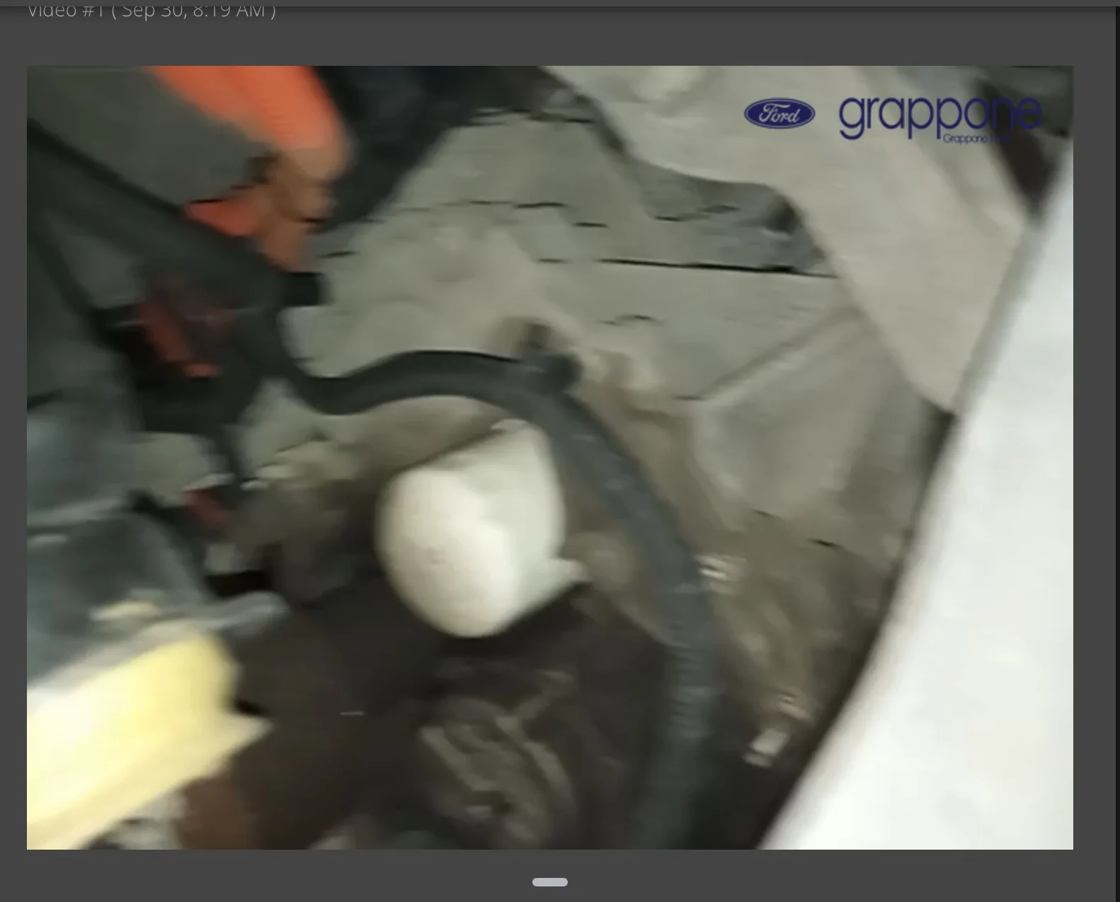

To my eyes it looks like regular oil filte
It is a spin on type filter, the internals will be different whether it's engine oil, fuel, Hydraulic or coolant. Some spin ons are in the suction line, some pressure.
