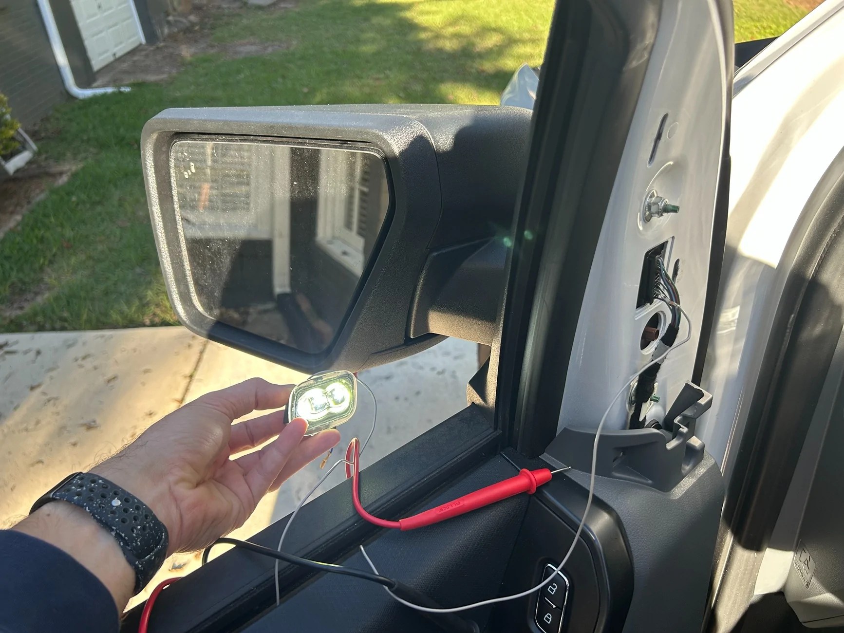

Note: has issue that puddle lights get disabled.
