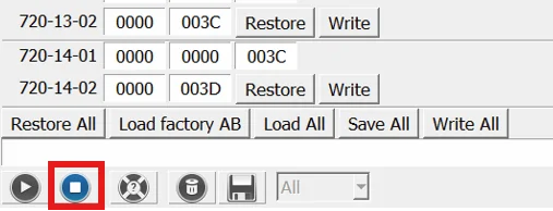

so first time FORScan user here with a 2024 Lightning, I programmed the APIM to enable autofold mirrors, wrote the value and Sync rebooted and it said to stop then start the truck/ignition, I did both of those.
But now I'm worried because in the FORScan app (Windows) the disconnect (and connect) icon are gone, I just unplugged the ODBLink cable... is that bad?
Everything seems to work though... anyone know what I'm talking about?
3,125
4,479
Once the values are written, you are good. Next time exit Programming mode (the Stop button at the bottom) and you'll see the disconnect and connect icons again. But no harm that you didn't click disconnect before unplugging.
