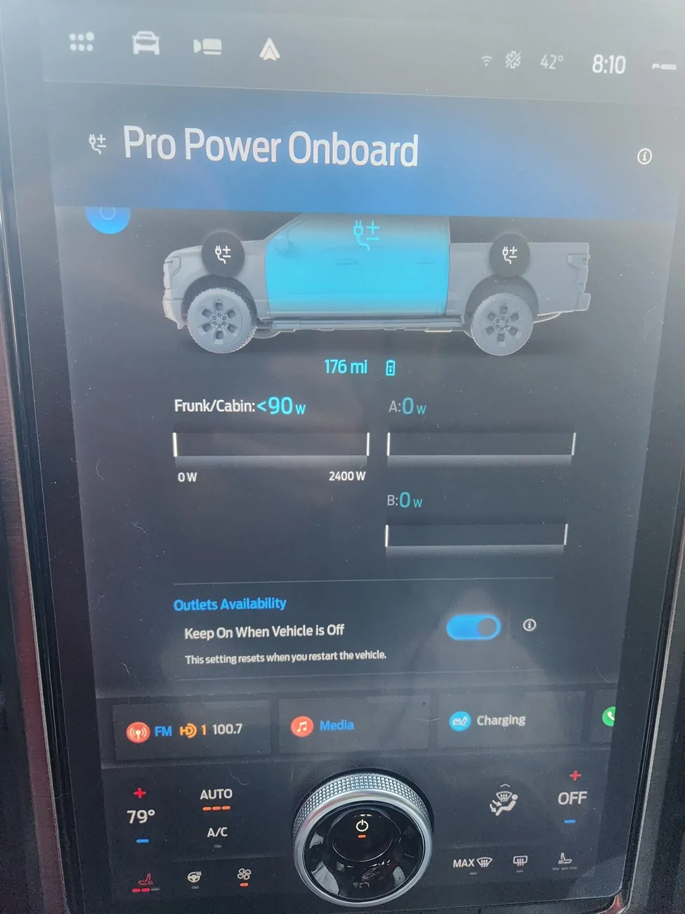

Here's a fun one. @bmwhitetx this should get added to the first post in this thread.
Enabling 2024 Feature - Pro Power Onboard Outlets w/ Truck Off
Both changes in APIM.
Jesse-Infotainment said:
As long as the truck is fully updated in FDRS you should be able to do this pretty easy
Set
7D0-10-03
XXXX XX2X XXxx
7D0-10-04
XXXC XXXX XXxx
tHAT SHOULD ENABLE THE SWITH to leave outlets on. That should be all you need to do.

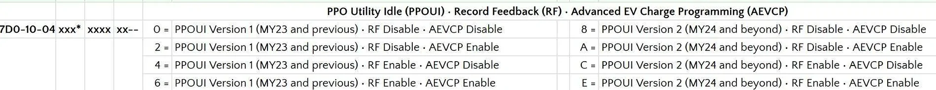

Always like to confirm FORScan changes before adding to post 1. :) So looking at my database of As-Builts:
7D0-10-03 xxxx xx2x xx--
All 22-23's have a 0, all 24-25's have a 2.
So you would be changing 0 to 2. According to the 24 spreadsheet, this enables "PPO Outlets On in Vehicle Off State".
7D0-10-04 xxxC xxxx xx--
Almost all 22-23's have a 4, most 24's have a C and 25's have a E.
So you would change 4 to C. According to the 24 spreadsheet, this changes "PPO Utility Idle" from Version 1 (MY23 and earlier) to Version 2 (MY24 and beyond).
If your 22-23 has a 0 that means the Sync feature to Record Feedback is disabled. This was an OTA you likely didn't get.
EDIT: The difference between C and E is that 2025's also have the Advanced Charging Screen. So if your existing value is 6, then you change to E not C
Note that Jesse says the the truck should be fully updated. I will wait for several 22-23's to confirm the toggle appears AND the functionality works before adding to my Forscan mods page. If it doesn't work, you might check your Sync version (Settings..General..About Sync). I think the most current is 25094. I would imagine there might be another module or two that is also needed.
Reminder, this does not apply to 2024 and newer. You already have this!

hmm...looks like I should maybe change mine to E. My 7D0-10-04 value was a 6 (changed from 4 to add the enhanced charge screen). Guessing changing it to C probably broke the enhanced charge screen. Would make sense due to the 25's having E and the enhanced charging screen along with PPO when off.
3,194
4,625
Yeah, I agree - C would have disabled the charging screen. The public spreadsheet doesn't show E but Jesse provided it here. Might scan that thread just to be sure. I'm updating my note above.

Have you tried this? My truck is fully up-to-date thanks to a dealer who thought that was a good way to troubleshoot a bad battery module. This seems like a nice feature.
Yep works on mine. I’ve never done FDRS updates but my truck did take a visit to the dealer in June for contactor issues and warranty items which included an IPMA update. No clue if they updated everything while they had it in there or not.
@bmwhitetx - I set mine to E to see if I could enable the enhanced charging settings but since I have the 12” screen nothing happened yet. I’ve left it at E just in case Ford pushes whatever update is needed for the 12” screens.

What’s interesting is I had a 0 there but I’ve always had Record Feedback. Wonder if I’ve been yelling into the void 😂
Blochead21
Oct 25, 2022
524
570
PA
Black 22 XLT 311pkg
Can confirm this added the switch for me as well on my 12”.
