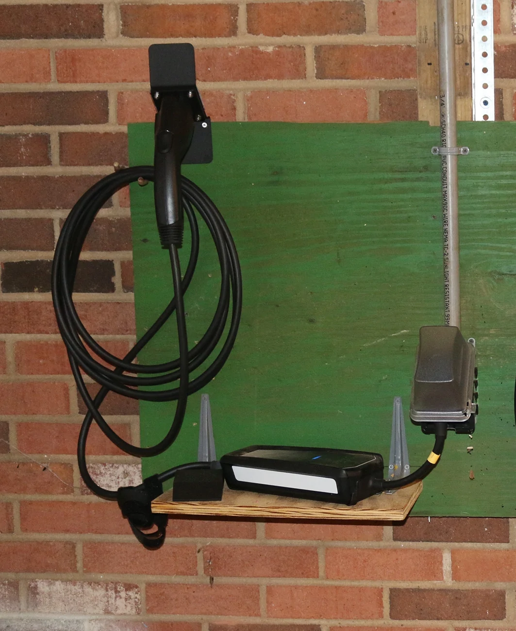

Or have the EVSE mounted inside your garage like I did before getting a FCSP installed:
Ford F-150 Lightning Ford Charging Station Woes and Whews! FMPC mounted inside garag
Run the J1772 with or without a J1772 extension rated for the correct amps (if another FMPC then 30A) through a pass through panel (like below):
