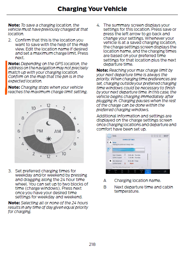

@TaxmanHog I wonder what the location accuracy is for determining if one is at a Saved Location? I have seen two different numbers for my driveway Home location latitude & longitude, say latitude 34.000000 vs. 34.001000 and the same small difference for longitude. Could that cause a Saved Location not to be recognized?
[edit 11-27, I have had the "One-Time Max Charge Limit" change to 100% a few times, so if the Saved "Home" Location does not match, I may get the over-charge - @Ford Motor Company - this may cause Ford to have more warranty replacements over 8 years of coverage? Software guys should change a default One-Time Max Charge Limit to 90% instead of 100%. I wonder if Ford can see these uncalled-for changes happening back at the office?]
I have a very constrained parking position within my garage so I very seldom deviate from the stored location which I later renamed "HOME" and have not had an issue with GPS location match-up, I can see where a problem might occur if you are parked in a wider area within reach of the EVSE cord, close enough to reach but outside the tolerance levels for the truck to recognize that it's at the stored location. I do not have a solid number on the tolerance, the manual doesn't say either. Best bet is to try to always position your truck consistent with the stored location in the charging profile.
Should be an indication on FordPass, Ford Navigation Map, the Instrument Control Panel ,and the Display header that one is parked at a "Saved Location". @Ford Motor Company

Try saving additional locations adjacent to the last saved spot, name them home2, home3, etc this might resolve the tolerance issues.
