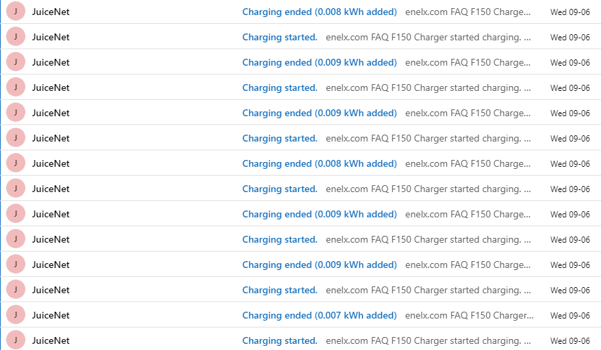

Two weeks ago did a long road-trip from Toronto to Tennessee. Get back on a Friday and truck charges fine overnight to my typical 90%. Seemed like it took longer than normal, but didn't really bat an eye at it.
Monday rolls around and I plug the truck back in. Wake up Tuesday morning and see a charge fault in my My Ford Pass. Now it gets interesting, because while this is happening I have two Juicebox chargers. They upgraded me to their new software which I had them roll back because the new stuff does not support load balancing which allows me to share a single circuit for two chargers.
I figure the new guys just messed things up and I would reset the power on the charger and retry. Plug the truck back in after the rest. It starts to charge for 5 seconds, stops for about 30, then retries. This happens in an endless loop. I try my other charger, same thing. I grab my neighbours 32A J1772 charger, plug it in. Same thing. Now I'm wondering if I have some kind of ground fault in my wiring. Plug my wifes EV6, it starts charging no problem with my Juicenet charger.
Bring the truck into the dealer. They call me back, they had plugged it into their FCP they have out front, no problem. They tech saw a code about the fault. I asked them to try a non FCP, I wasn't sure if the fact that its a CCS-1 connector had anything to do with it. I was concerned all the rapid charging fried something and that maybe when they cleared the codes, that's how it started working again. Finally after realizing they weren't going to do anything anyways as they were convinced the issue was my charger, I took back to the truck.
Sure enough took it home and it was charging at home without issue. Fast forward to the Wednesday after the Labour day weekend, and plug it in. Same garbage, it's cycling over and over:

This just repeats endlessly. Really hope that contactor is rated for more than 10k cycles. Call up Ford, and they have me do some troubleshooting which is basically reset the software by holding the left and right most buttons on the wheel. Familiar with this process, as I need to do it almost every drive to get Android Auto to connect. They tell me to go to a public charger and try. I'm lucky as I have one 1/4 mile down the street and go. Low and behold works fine. Rep basically tells me it's my charger or electrical, and they can't help any further because it's not a Ford charger. There's some back and forth where I try to explain its working fine on my wife's EV6, brother's ID4 and Sister'n'law's Model 3 who all charged that weekend. Basically I was told I could have the dealer look at it, but there might be a charge because it's probably a faulty charger.
Go back home, hoping the public charger somehow reset something - nope - same stupid cycling issue. Now I'm wondering if I have some kind of ground fault on my panel, so I grab my multi-meter and start checking resistance and voltage, etc. etc. Don't see anything. Next day, call an electrician in, they say everything is fine. I'm starting to think of all kinds of stupid things, maybe it's only when my A/C is in stage two plus the dryer plus blah blah blah. It's about 5.30pm and I decide to plug it back in, and it's working again?! This just reinforces maybe something else is somehow causing the electrical issues and I have to figure out a way to track voltage/resistance on my other outlet.
Now here's where I get lucky and it dawns on me what's happening. Normally I wouldn't plug in at 5.30pm it's peak tariff for me, it goes from 24 cents down to 6.5 cents at 7pm. But to troubleshoot with my multimeter I figure I'll plug in and see. I plug in, and Truck is charging fine. Go have some dinner, low and behold my phone starts going crazy right at 7pm. Damn truck is cycling again. It hit me then that the thing that explains everything was the Ford Profile settings that are based on GPS location. This is why it worked at the public charger, dealership, etc.
So I delete the charge profile and everything is working. I add it back, because I don't want to charge to 100% all the time, but so far it doesn't seem to have saved it yet. Oh well, at least I can charge it at home.
