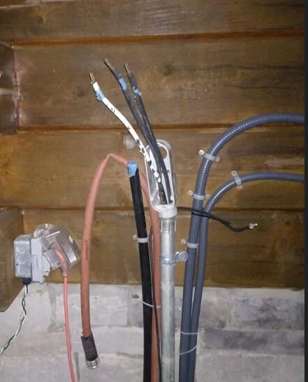

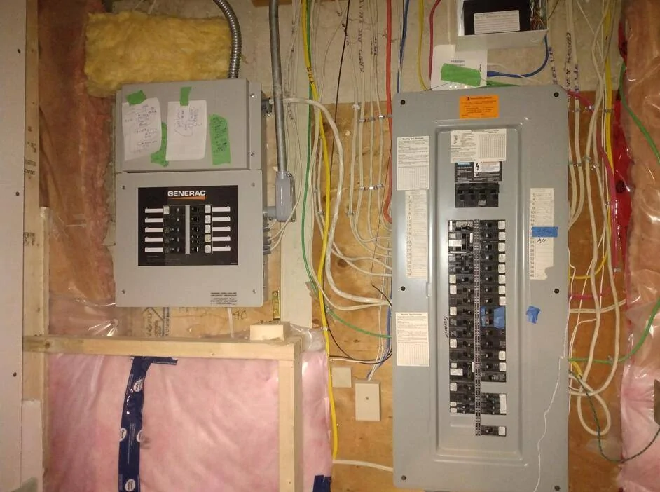

my basement 200A panel and ATS (automatic transfer switch for gas generator 7KW)

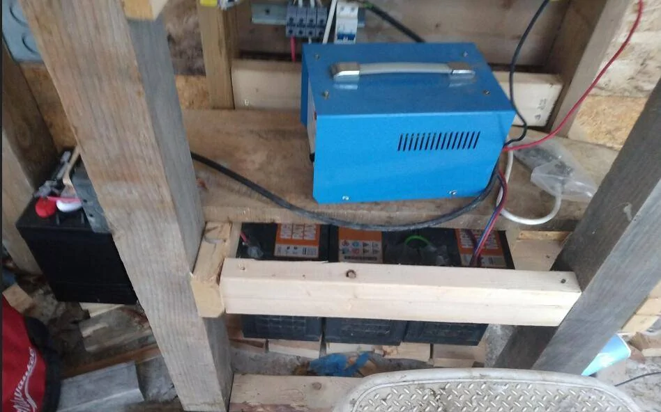

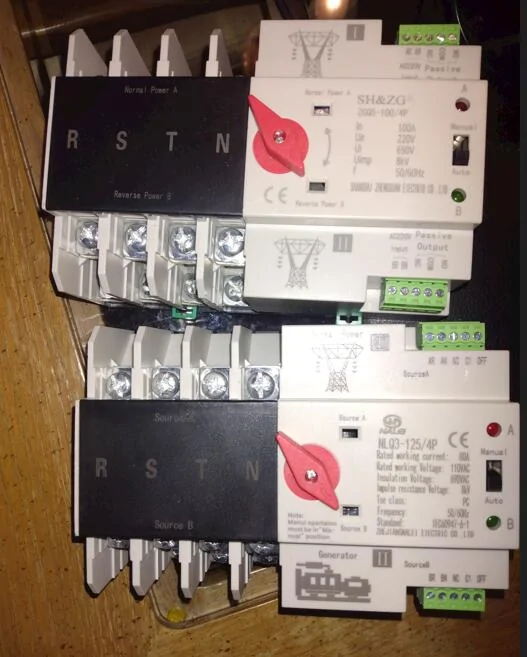

Outside house solar controller and another panel

Solar controller, input maximums 500DC. output 220vac ( European standard. ) 60HZ. couldn't separator two 110vac.

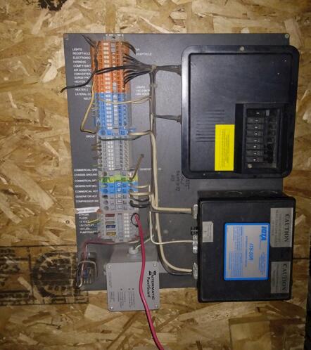

I have 17kw solar panels. Currently only have batteries (48x150AH). Not enough. I only have 4kw solar panels installed. Need to install 12kw more (the rest of the solar panels are now staying in my garage).
There is no electricity in the garage. There is room for solar panels on the garage. The garage to the house is about 160 feet. I put several underground cables. One is a 4/6 AWG, one is 4/10 AWG, one is 3/12 AWG cable from the house to the garage.

I'm sorry but all of those posts and pictures are not really helping. And frankly makes it worse. Sloppy wiring, contradictory information in various paragraphs. You're talking about non standard voltages too. Canada and the USA (and the F150) use 240/120v at 60hz but you're talking about 220v European power presumably 50hz.
Based on all of this, I recommend against trying to use an $80,000 F150 to do anything. Instead I recommend organizing your equipment and thoughts into a coherent plan with schematics and actual data.

Looks like you bought a bunch of things without adequate planning. Since you already started setting up an off-grid solar system with a 240V (60Hz config) only inverter which is not appropriate for the US house wiring but maybe OK for a 240V well pump. If you want to connect it to house wiring you will need a split-phase inverter or add an autotransformer. In any case, you should get the solar working first and this is not the right forum to help with that. Check out the DIY solar forums.
