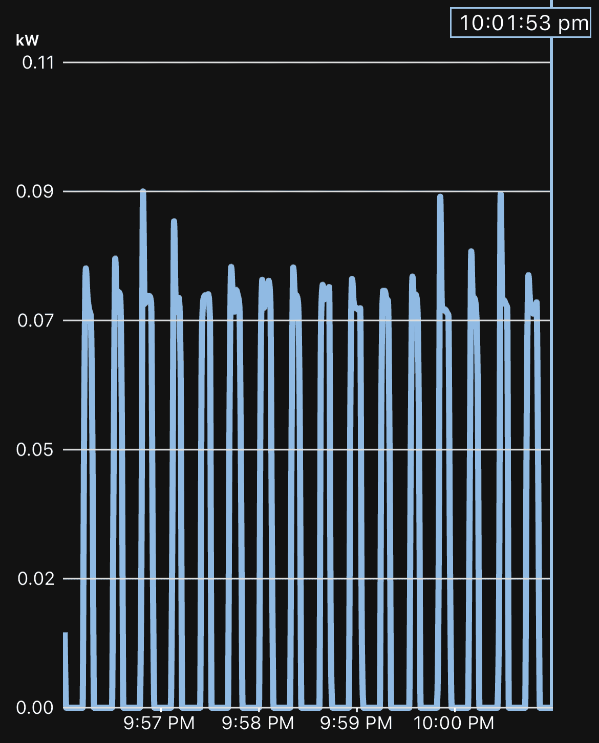

Did anyone ever figure out this clicking issue?
My replacement Charge Station Pro is doing the same thing. You can see the regular draw on the energy monitor graph below.

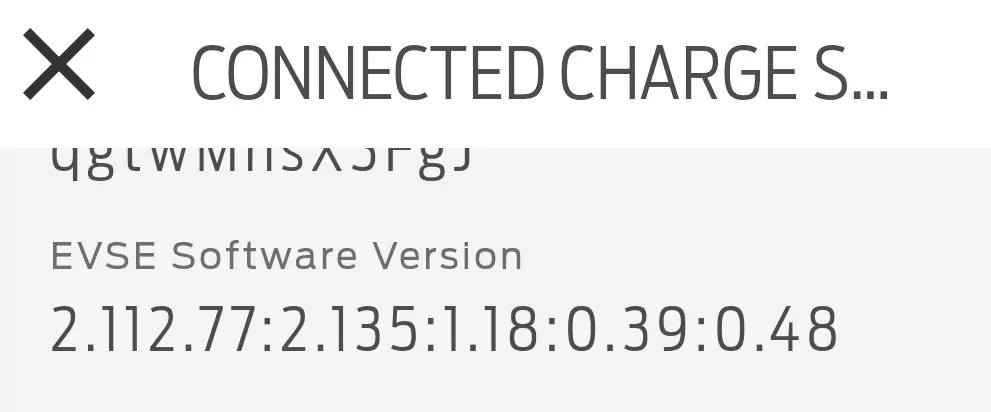

At the moment the cloud servers are offline..........
Is your Software version the same as this?

I have not noticed any unusual clicking issues, but after see another complaint in another thread, I decided to look at my Emporia Vue2 Energy monitor, I'm seeing this signature on my graphs intermittently even when the truck is not plugged into the EVSE, had noticed this months ago but wrote it of as noise on the line that the Emporia was picking up.
I just unplugged my truck a cycled the EVSE breaker, curious to see if this continues.
