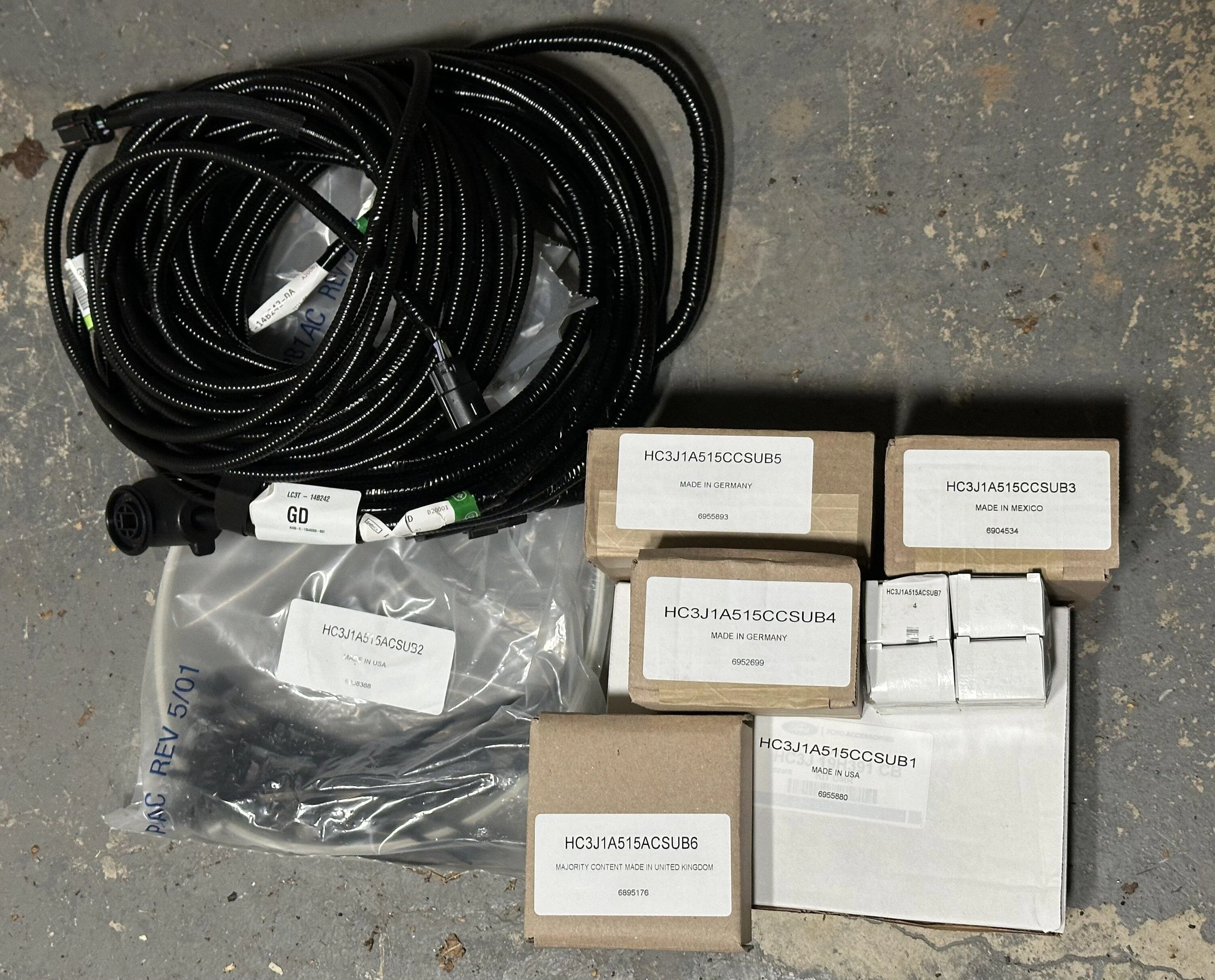

Step 2: Order parts. I used Full Kit Part# LC3Z-1A189-A. The LC3Z kits are for a F-250, but it worked just fine. There's also part numbers for the F-150 specific and will start with ML3Z. The part number is the same "1A189" It's just ML3Z vs LC3Z to indicate F-150 vs F-250. So ML3Z-1A189-A is the exact same kit with a different part number.
The last letter will dictate whether it's TPMS only, Camera only, TPMS+Camera, or Yaw Sensor or not. The plug replacement is the same for all of them, only the harness and accompanying modules differs. My "A" kit accommodates all of the modules and included everything but the yaw sensor (aka w/ Pro Backup Assist)
"A" is Cam + TPMS w/ Yaw Prep
"B" is TPMS w/ Yaw Prep
"C" is Cam w/ Yaw Prep
"D" is Cam + TPMS w/o Yaw Prep
"E" is TPMS w/o yaw Prep
"F" is Cam w/o yaw Prep

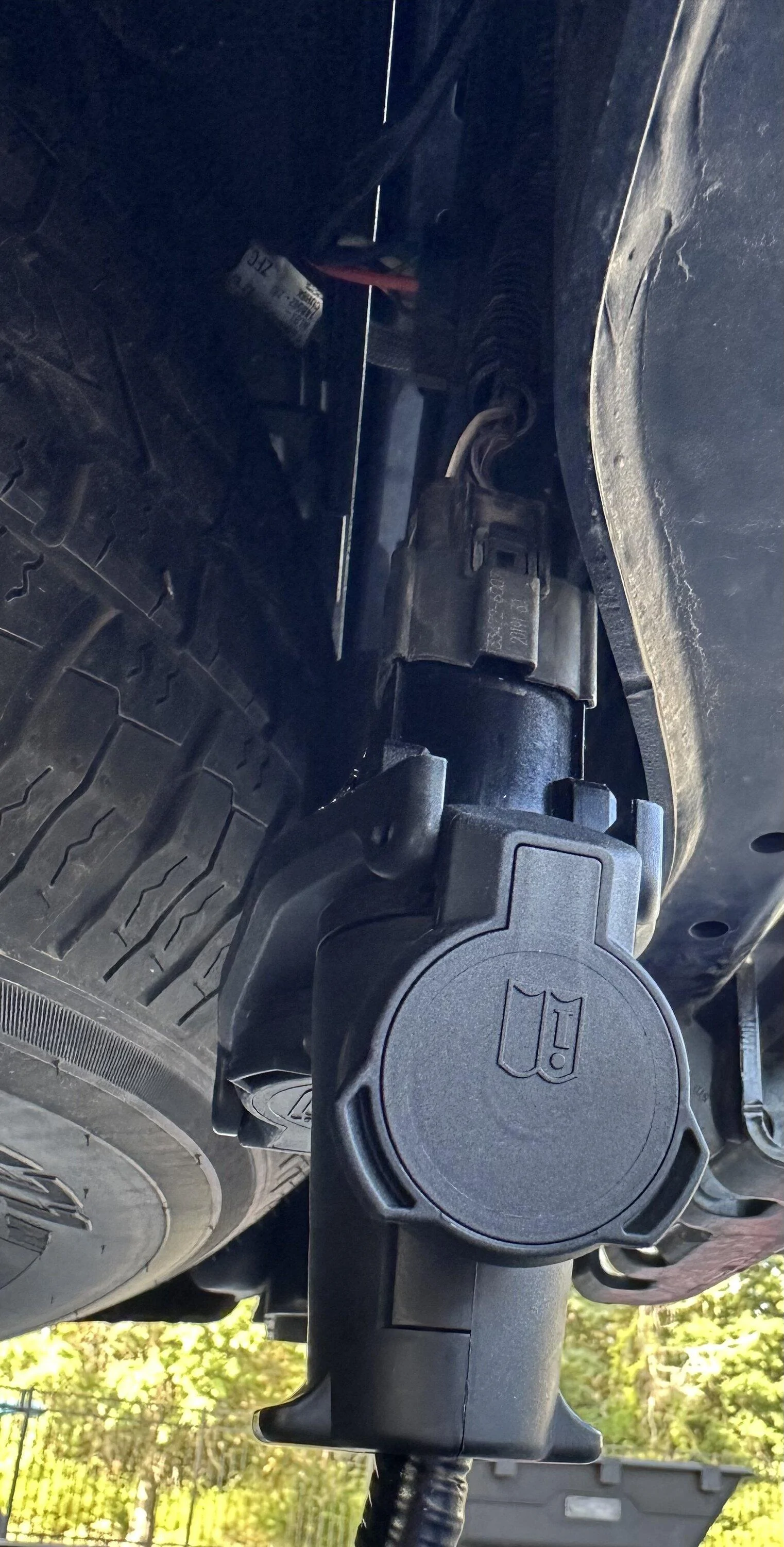

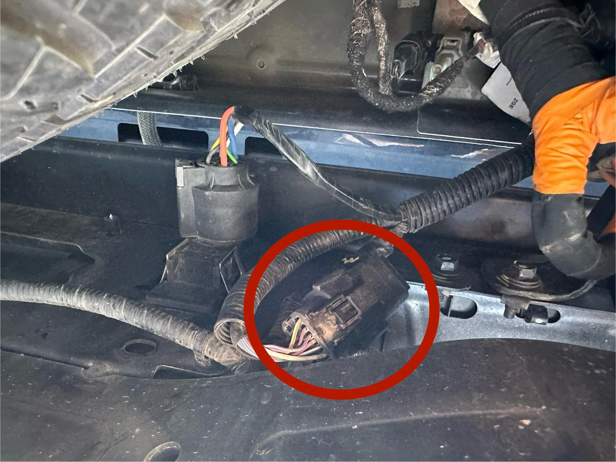

Step 3: Disconnect the 12 pin connector from the holder and release the 7/4 pin connector from the bumper.
Step 4: Disconnect the 7/4 pin connector from the wiring harness, connect the new included connector for 7 pin / aux connector, and push it back into the bumper.
Step 5: Connect the 12 pin connector to the new 7 pin/aux connector and check to ensure a tight fit.
Step 6: Plug in the camera.
Step 7: Climb into the truck and confirm everything is operational. Continue running and positioning your camera onto your trailer of choice.

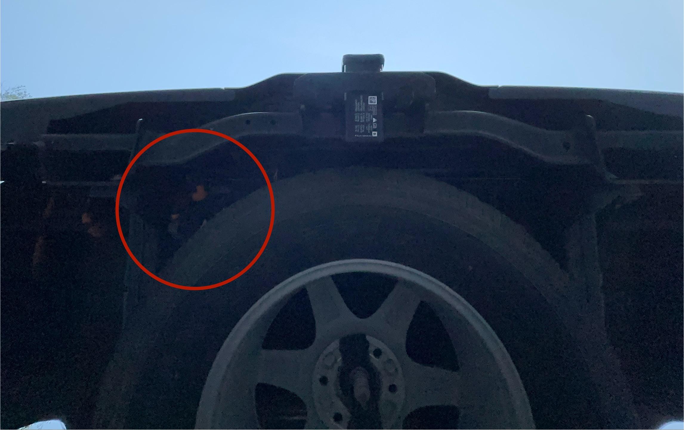

Having a hard time fixing in mind where this connection is being made.
Any chance we can get another photo taken further away that shows the whole bumper center section.

Ask and you shall receive. You'll see the hitch and spare and hopefully that will help orient you. You'll want to be on the drivers side. If you don't see orange electrical tape, you're likely on the wrong side of the truck.
Ford F-150 Lightning Ford Trailer Camera, TPMS, Yaw Kit Installation! DIY Instructions & Part # Numbers IMG_4412
Another point of reference. Facing the truck, just locate the 7 pin connector (left of the license plate) the plugs are directly behind there.

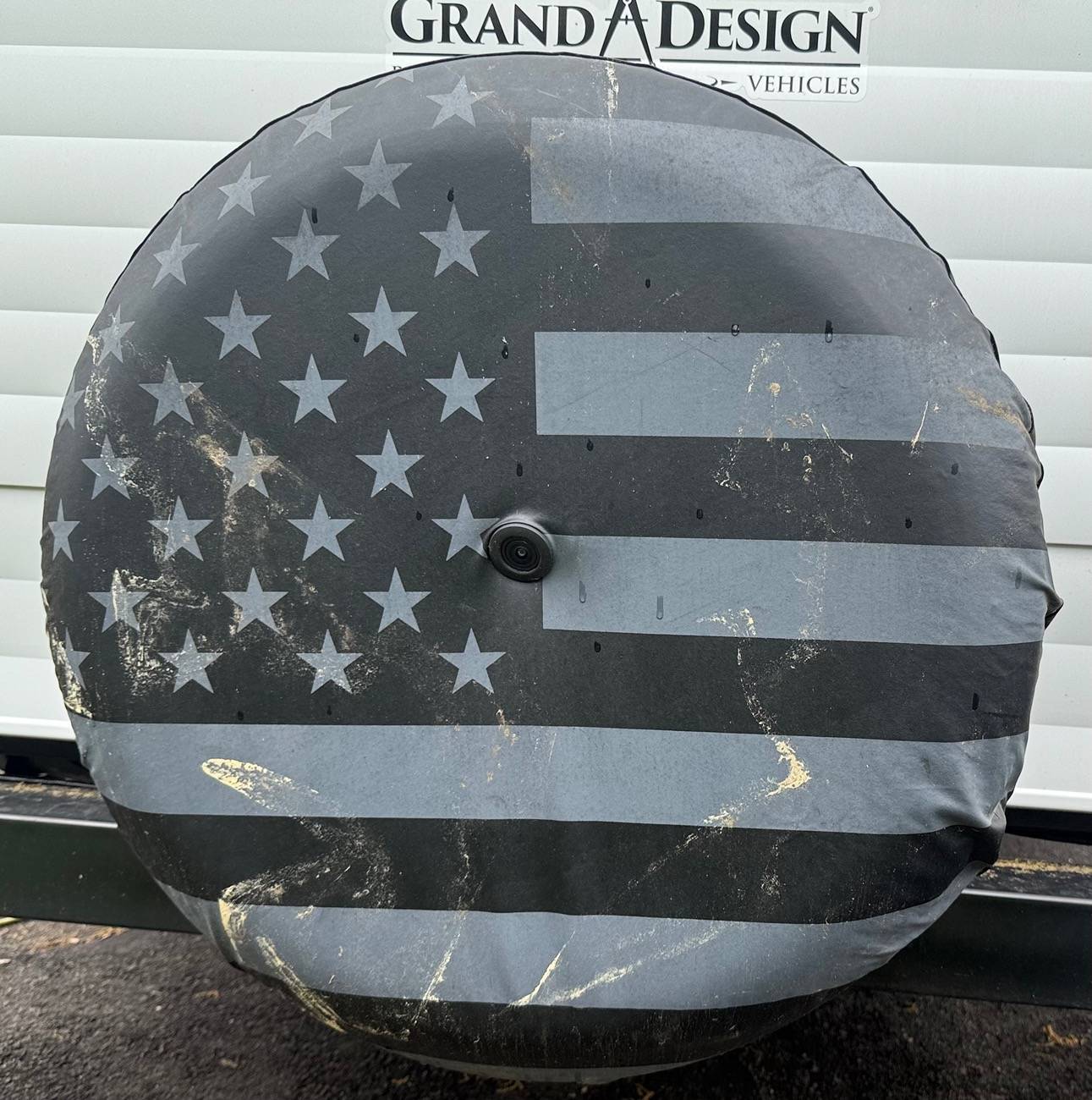

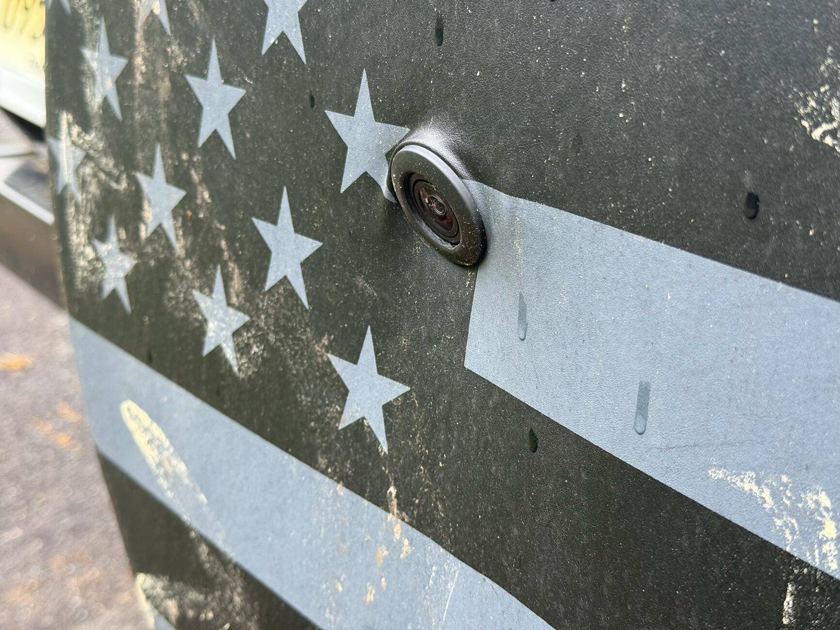

Just a little more to add..I wasn't willing to drill into the exterior of my travel trailer. I didn't want to create a potential for water intrusion nor did I want there to be holes if I sold the trailer and wanted to take the setup with me, so I ended up rigging my camera up to my spare tire.
1) Purchased a Wall Mount Trailer Spare Tire Mount for Utility Trailer for the bracket. It's a tight fit for a 4.5" wheel stud spacing, and should be no problem for anything further. For $6 it was a good starting point that required very little modification. I ended up drilling it so I could get all 3 screws in, but you can install it with less if you wanted.
I ended up putting this over top the existing bracket that held the spare and tightening it down with the existing lug.
I also had a soft tire cover, so I ended up doing the following:
2) Purchased 1" Curtain Grommets. $3 from a local curtain store instead of from Amazon. 1.5" grommet if you don't want to modify, but it'll be loose. I went with a 1" and used a drum sander on my drill to hollow it out just a tad. That allowed it to have a snug fit over the camera hole and helped to hold it.
Then it was just a matter of cinching it down for a nice neat look. Yes, I could've just bought a cover with a hole, but most of those holes are 2.5" and way too big for our cameras. Since mine already had the cover it was worth the $10 to modify it.
