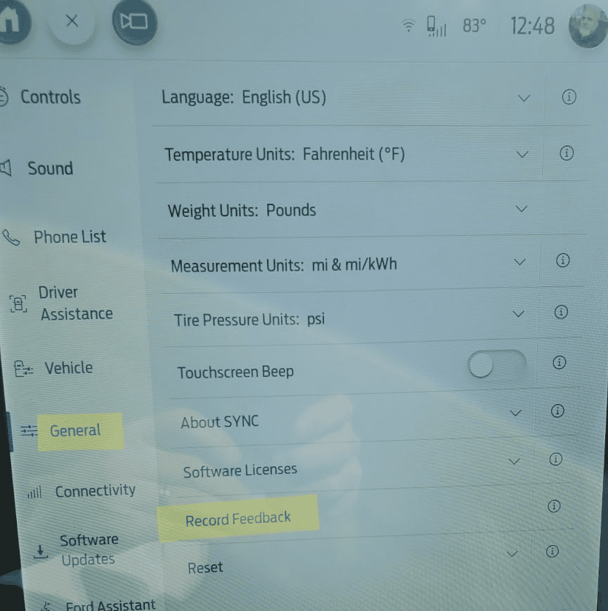

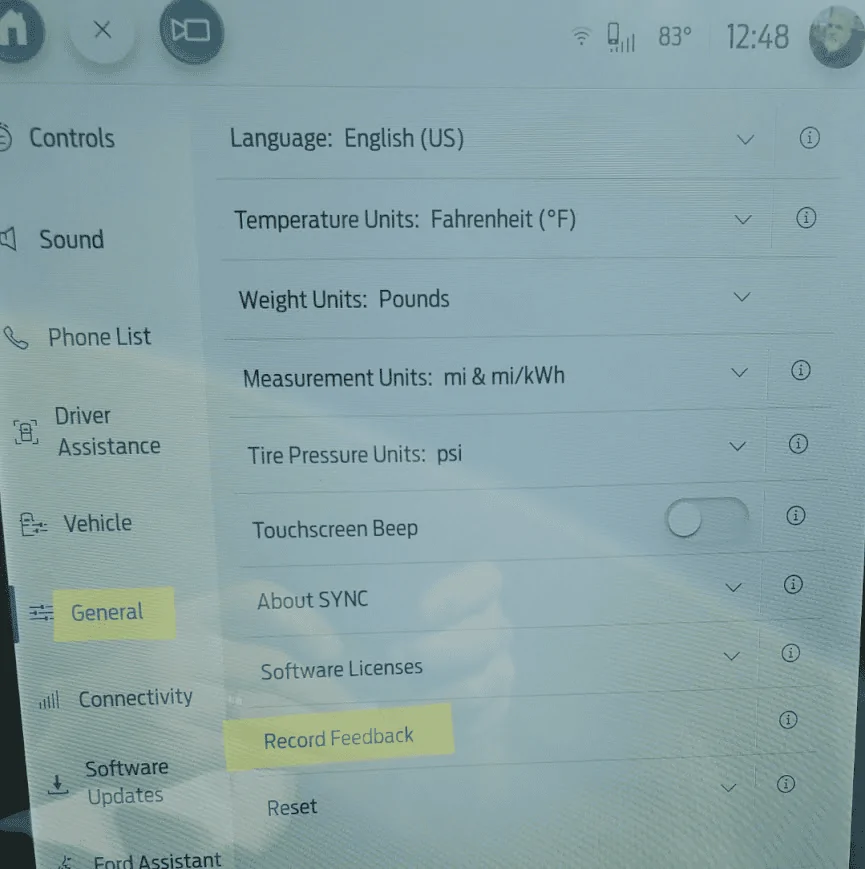

Question: How exactly do you report problems “via the synk system?”

Sync screen, truck settings, General, Record Feedback

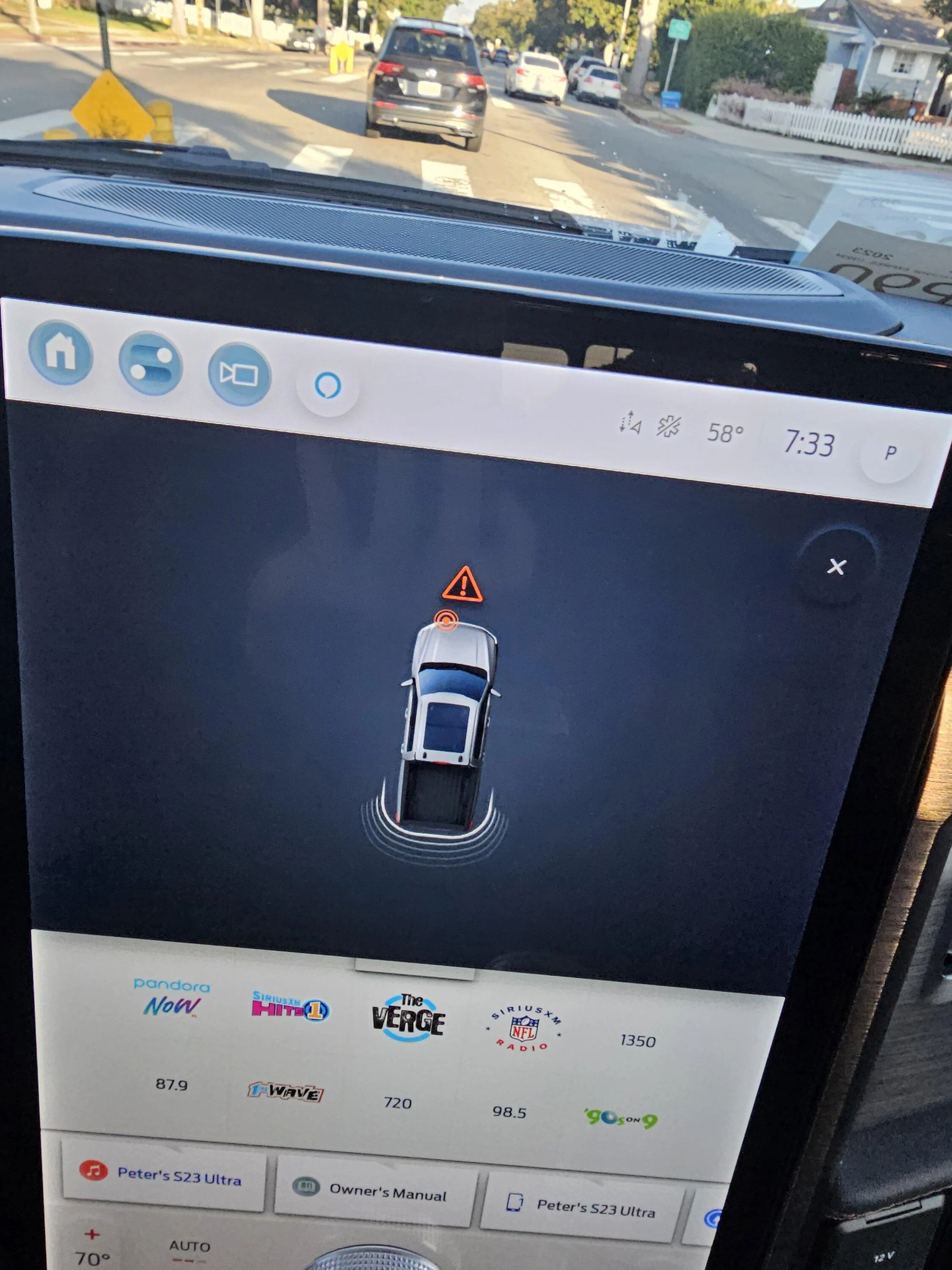

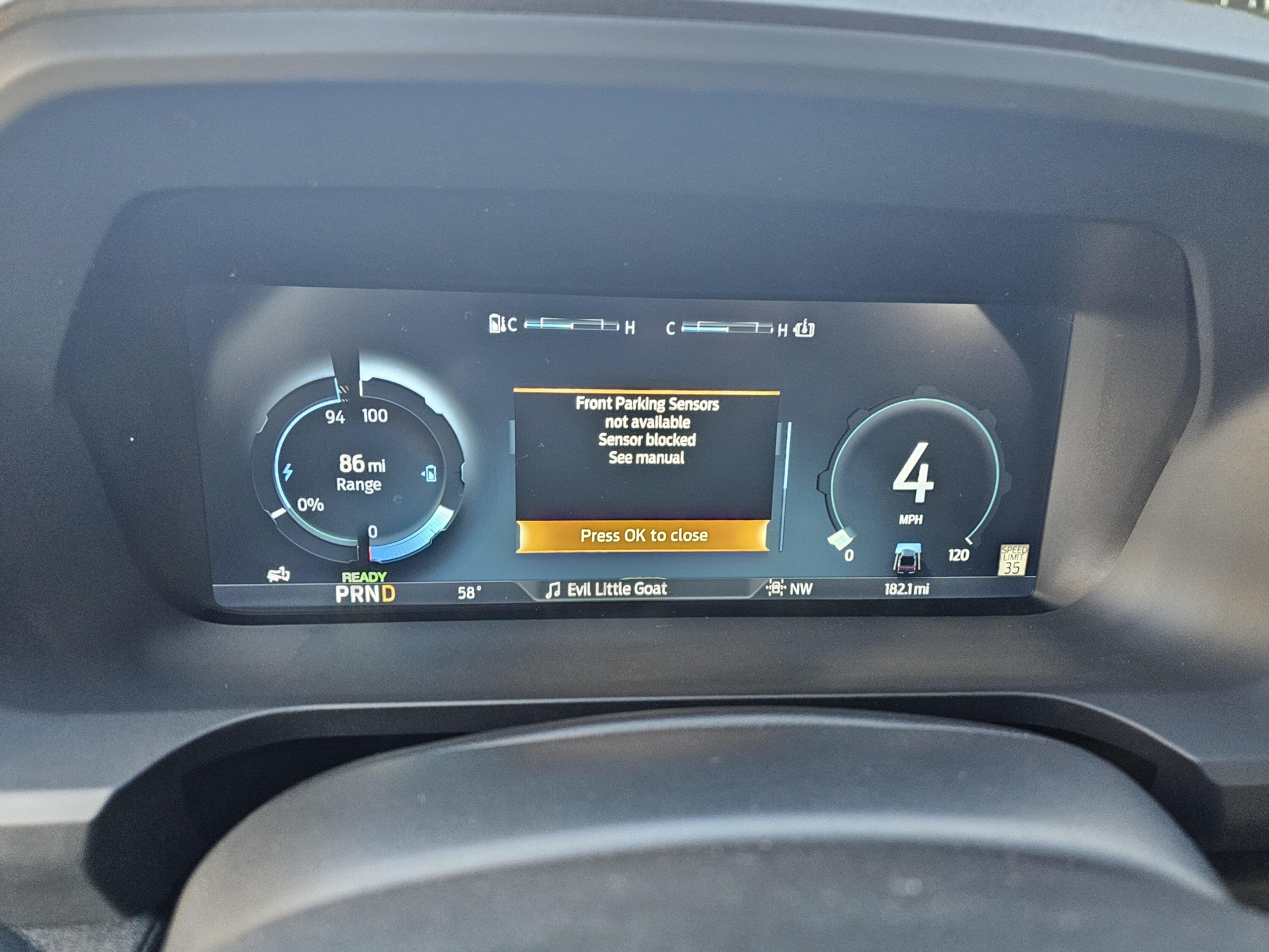

So I've got a new Lightning and I'm already back here asking for info...
I made the trip home from the dealer (3 hous away) with no issues until I pulled into the driveway.
i get the error that the front sensor is unavailable, front sensor blocked. I checked the FB Lightning group and a clear pattern I could see is that a the other members reporting this are new buyers that purchased within the last couple of weeks. Any know of a DIY solution or is the dealer the answer?
Me too. 10 days old.
Happens more when it's dark, maybe?

Exact same problem with my truck, 2 weeks after delivery. Have had it to the dealer where they reported it as a defective sensor and have ordered and received it - waiting on it to be painted and installed. Had to take it to the dealer twice for them to warranty it.
