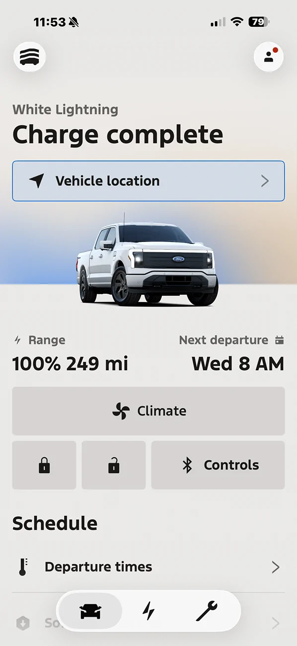

For the last few weeks my 23 ER lightning with 123,000 miles on it is stopping charging at 85%. I have the settings in the app and the truck set properly and have tried adjusting the charge limits to see if it makes a difference. But no matter what I set it to the app will tell me it’s charged to 100% but the truck stops charging at 85%. Has anyone had this issue or know of any solutions?

Your screen capture shows charged to 100%, where are you seeing 85%, and do you have a target charge location for home and if so, what is the target charge?

This was happening to me awhile ago, it was a bad battery module. Take it to the dealer and they can diagnose and replace on warranty.
EDIT: Another issue when this happens is that it charges very slowly once it reaches a few percent from the max (usually 100%, but in your case 85%), so if you see very slow charging as it approaches 85% it's most likely a bad module.

Since your out of warranty, lets think about something else ... I assume your app shows 100% but you get in the truck and the screen shows 85%, is this correct?

Sounds like the same symptoms I was having. It is described in SSM 53208.
While your app shows 100%, the 249 mile Range shows about 78% of your ER battery. And I'm guessing when you start your truck the SOC immediately drops to <90%.
Several of us have experienced that and it's a bad cell in one of the 9 battery modules. I was never able to charge past 83%. Currently at dealer awaiting module replacement. I see you're out of warranty (over 100K). Dealer told me it was a $7500 repair. :(
If you have an OBD dongle, you can use the free CarScanner app to look at the HVB module variation (details in post 1 of my thread). Anything over .030 V (or ~2.5%) would likely be considered out of spec and suggest replacement.
This is correct.
