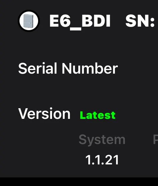

In addition to successfully installing 6.1.0, have you had a chance to confirm the following for your system:
Delta Inverter on firmware version 1.1.21

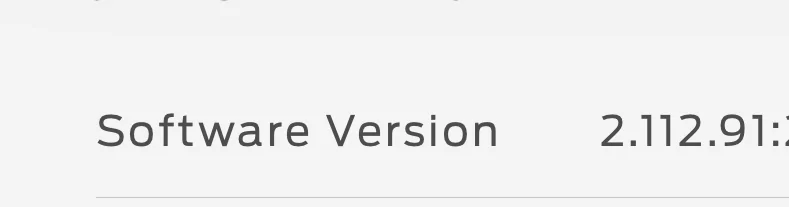

Ford Charge Station Pro on version 2.112.91
Ford F-150 Lightning Installing a Home Integration System for Intelligent Backup Power (without SunRun) IMG_8999
If all of three of these stars are aligned, then the system should still operate (significantly better than before). I am still able to make changes to the configuration on the Ford Sync screen within the Lightning as well as monitor power flow. The system will work with the Lightning turned on and off.
I was able to configure the system in the FordPass until yesterday (posted earlier in the thread), when I received the error in the FordPass app. I have reported this to both of my contacts at Ford and SunRun. Both teams are working together with Ford's engineering team to get this issue resolved.
Fingers crossed for you all!

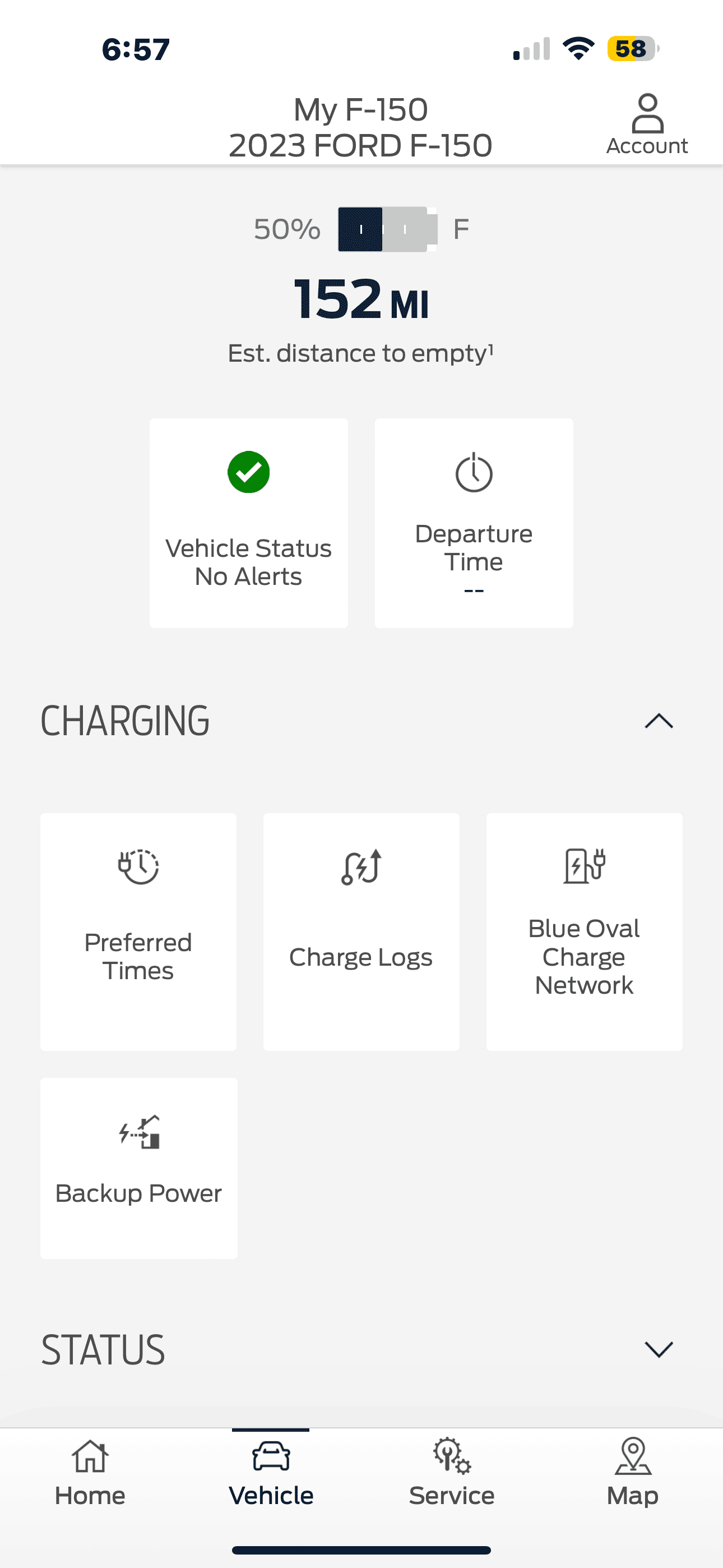

Something new in the FordPass app? First time I've noticed the applet within the FordPass app was last night and I'm wondering if it's new with the FordPass iOS update to v4.30.2 in the past couple of days.
If you go to the VEHICLE tab in the FordPass app and open the CHARGING dropdown, you should see the following:
Ford F-150 Lightning Installing a Home Integration System for Intelligent Backup Power (without SunRun) 1697242260860
If I click on BACKUP POWER, I see the following screen, which I've never noticed before:
Ford F-150 Lightning Installing a Home Integration System for Intelligent Backup Power (without SunRun) 1697242341774
I'm on the same Wi-Fi network as the FCSP and the M Professional app shows that I can connect to the BDI, too. But the Get Started button is greyed out for me. Refreshing the FordPass app or force-killing and relaunching it does not cause the Get Started button to become active.
Has anyone succeeded in running this FordPass applet and to what result? I'm thinking maybe it will only become functional after I've gotten the Power Up 6.1 update... And so it goes with Ford. Lack of heads-up information and lack of functionality you'd expect for an $80K->$100K product...
Yess all those are up to date
hifixenthusiast
Dec 13, 2022
61
Lighting Lariat ER, Taycan CT, Lyriq & Bolt
Outstanding! You should be good to go then if your system was already paired and be able to configure the settings from within the Truck. My understanding is that the current issues are related to FordPass servers/network. So if your system wasn’t paired before these recent app issues started occurring, you’ll likely have to wait until Ford gets them resolved. I have it on good authority that Ford is aware and actively seeking resolution on the FordPass app issues with an urgency.
