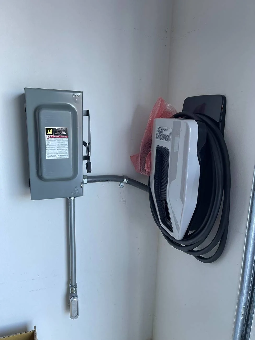

The electrical contractor is at my house right now installing the Pro Power Charger. Will I need to do anything tonight when I go home to charge? Is it all plug n play? Do I need to set up anything?

The charger worked flawlessly. First time I woke up to a fully charged vehicle. I did not hook to Wi-Fi, I may eventually try, but after it warms up in spring. LOL.
