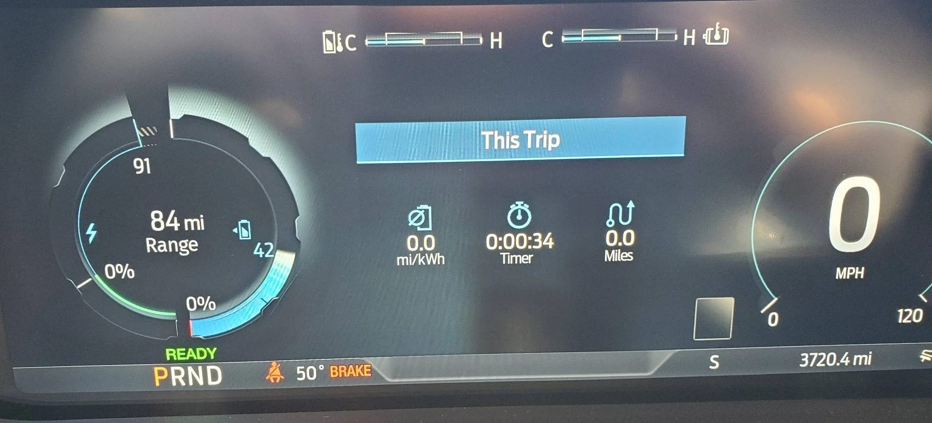

I have a 2024 Flash and bought it back in July. Until this morning, I have never seen the maximum power be reduced from 100%. Today it is down to 91%. I have run the vehicle down below 42% SoC before this without losing maximum power. It was somewhat chilly this morning -- around 38F -- but the truck has seen that before and not dropped max power before. Am I starting to experience a battery module failure? Any other explanations for this?

I forget the reference points but SOC's below 50% and cool / cold temps will trigger an lower power available to the motors. If memory serves me well it was a bit colder than your 50°

Hmmmm... the battery temperature gauge shows right in the middle. I didn't see this issue with my 2023 XLT ER in similar conditions.

Doesn't seem normal to me. I have never taken detailed notes but I think it only starts limiting the max power when you get down to 15-20% ish. And it shouldn't at all if the battery temperature is good. 50 F is not cold at all. Should probably check for codes with an OBD reader
108
6,811
9,266
Remember that the air temp is not the battery temp. If it got down to 35 last night, but it is now 50, the battery may be closer to 35.

That's a good point. I will keep an eye on it. I do expect a power reduction when cold -- that's battery chemistry in action -- but wasn't sure what was normal with this truck.

It's normal, in cooler weather the available power lowers as soc lowers. It'll drop further into the 80s as you get below the mid 30s soc.

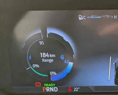

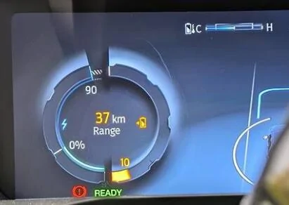

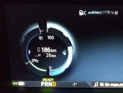

Its normal to see limited power. it depends on your Battery SOC, exterior and battery temperatures. Here are several photos. The first 3 show the outside temperature in degrees c and the last one was taken in September when the outside temp was about 75 degrees f or 21 degrees c. I did notice power being limited more after the BMS software was updated.
