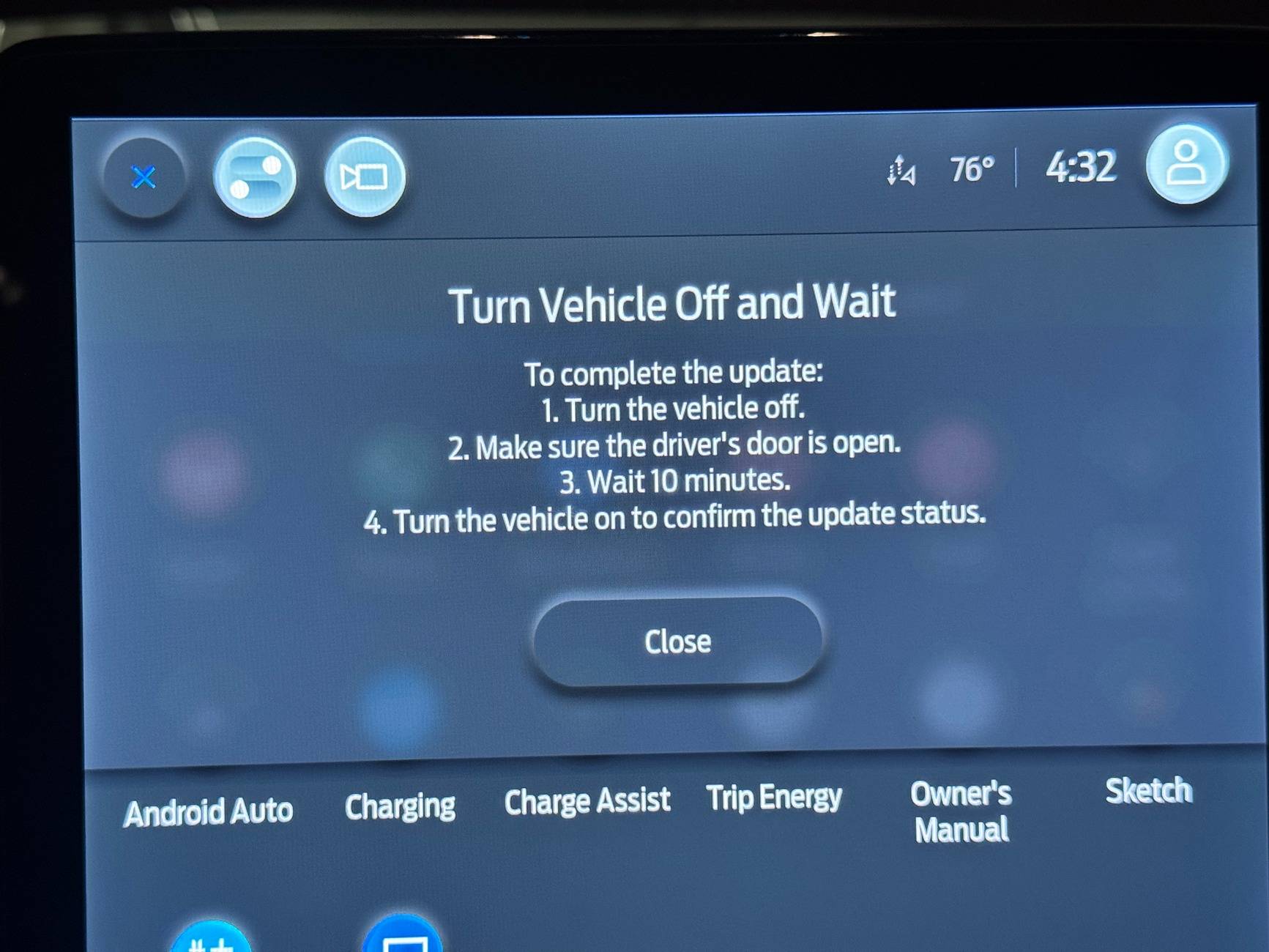

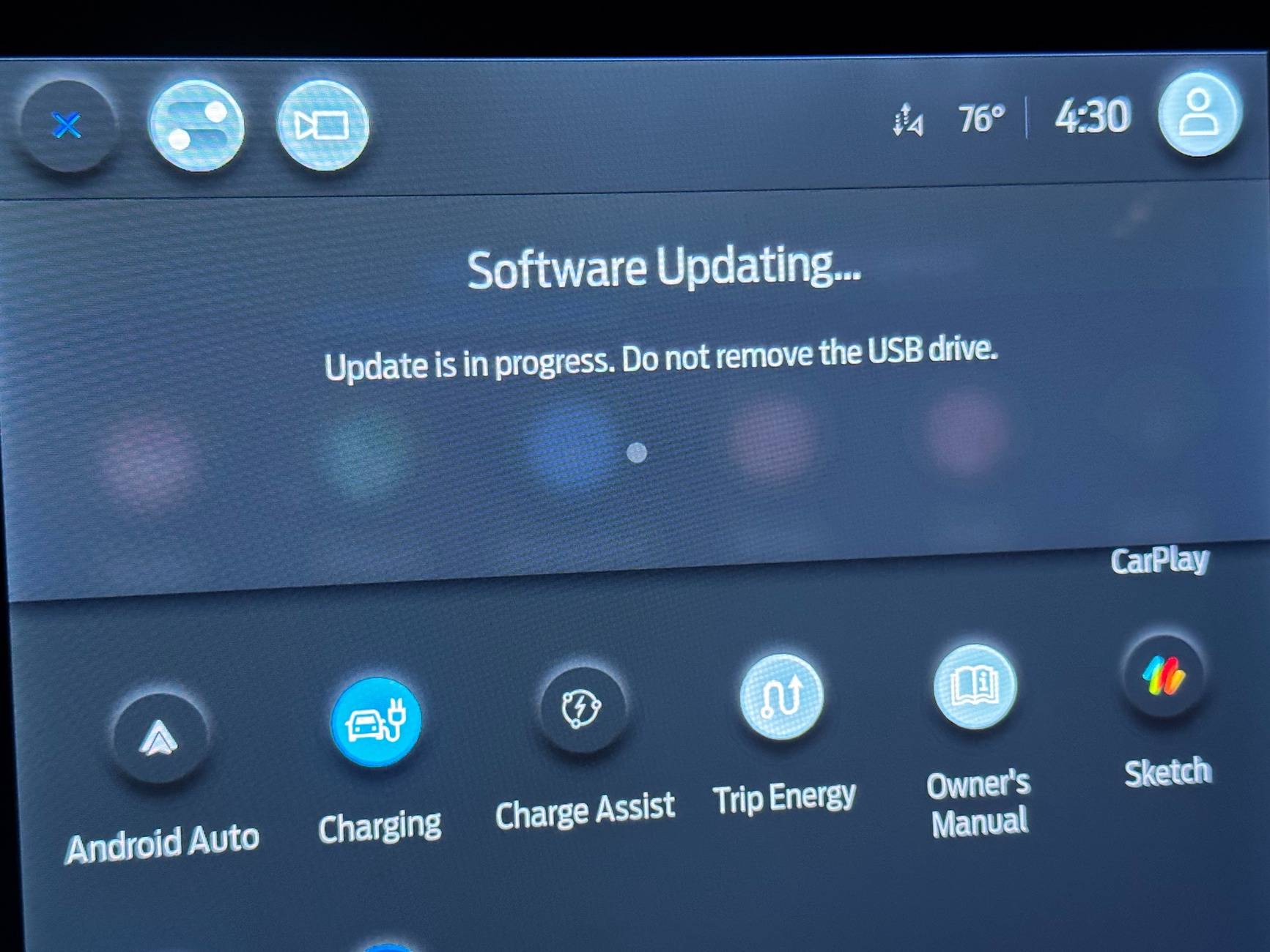

When attempting to update GWM, after plugging the USB into the vehicle's USB port, I receive the Software updating...message below.
Ford F-150 Lightning Lightning Software Updates using FDRS IMG_4633
A few minutes later, the screen updates to the Turn Vehicle off and wait 10 minutes message below:
Ford F-150 Lightning Lightning Software Updates using FDRS IMG_4634
After waiting 10 minutes, I turn the vehicle on and the same Turn Vehicle off and wait 10 minutes message appears.
Do I CLOSE the message, turn the vehicle off and wait 10 minutes more before turning on again, or something else?

Did you perform the "clear all errors" (or something like that) step between each module update?
I forget exactly what it's called, and it has been a while since I've done updates, but I seem to remember there is a step that you have to perform in between each module update to clear errors.
Normally fdrs does this automatically when it finishes.
In an attempt to save power, I had turned off the vehicle entertainment system. Once I turned it on, was good to go.
USB updates are all processed with the vehicle fully on...so there's no need to try and conserve power by shutting things off.
