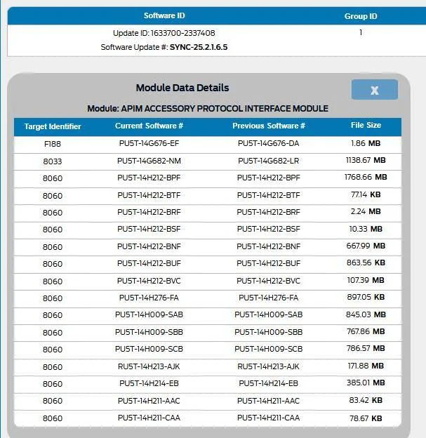

Thanks Jesse. Where can I see the values NG or NR?
I just see values from F188, F124, etc.
I believe it is in the 8033 DID. Going from memory here, but I'm pretty sure that's it.
Edit: Yea, that's it. This is from your truck.
Ford F-150 Lightning Lightning Software Updates using FDRS 1747938202870-pm

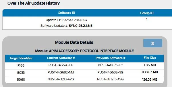

In the case that the vehicle was on another older version of Sync, it will look very different as the update packet is more extensive. Like this:
Ford F-150 Lightning Lightning Software Updates using FDRS 1747938331973-
