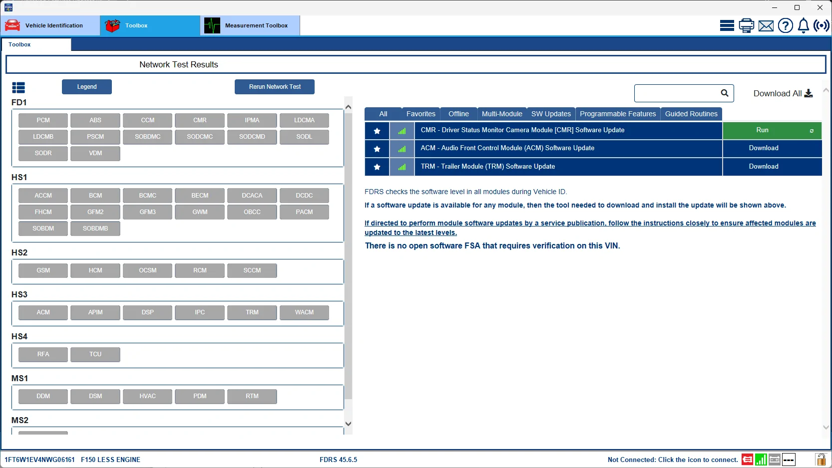

Strange that Lightning updates quite often come out on a Sunday...but there it is....today a CMR update appeared in my list. I'm guessing it's the same update that I got for my Mach-E last week, just tailored for our trucks.
Ford F-150 Lightning Lightning Software Updates using FDRS CMR_Update_Lightning-17-Aug-25
Nothing better to do this afternoon so.....I did check to see if this was in my OTA queue and it's not (it was on my MME though).
From experience, this will take 50 minutes and definitely requires a powersupply.
Mike G
Mike G
Jan 6, 2022
1,847
2,711
N. AL, USA
So I'm not sure the TRM update took even a full minute. It was very fast.
As I said above, I expected the CMR to take 50 minutes, but it actually took 40 using a VCM 3.
And I did try to update that pesky ACM....again...and still after not trying for 6 months it went through the motions but still remains on my list after it's all said and done.
This website was down on the 25th of July, so I didn't get to mention at that time that on that day the RFA update that wouldn't clear off my list finally dropped off like magic.

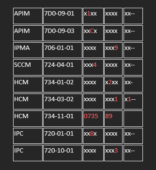

Sunday again...7 Sep...
So FDRS is showing a HCM update as well as GVMIS data warnings for the USB-updateable modules this morning (GWM, APIM, TCU, IPC). No idea what that's about, but it will likely go away by itself. (I checked a 23 and 24 model and they also have the same GVMIS data warnings for those same modules this morning, but they do not have the HCM update I have showing).
As I currently have Glare-Free lighting enabled, I'm not really keen to update that HCM without knowing what's going to change. I might just let this ride a bit before doing this update. Kinda wait and see if a TSB or SSM shows up that would explain why this update is a good idea or what it's supposed to fix. Also, I need to check my cloud based asbuilt to confirm that my Glare-Free settings are stored on the Ford server at this point. That way I'll know if I'm going to have to redo them with FORSCAN after doing the HCM update.
Ford F-150 Lightning Lightning Software Updates using FDRS Lightning_HCM-GVMIS-7-Sep-25
Another note....when I checked my Mach-E in FDRS this morning it shows the same GVMS data warnings on those same modules...so I tend to think this is a server data issue more than anything else. It is Sunday after all, and we know that's when they do maintenance on the system.

I know, that's significant tweaking on what is it, 2 or 3 modules to get the glare free feature.
Mike G
Mike G
Jan 6, 2022
1,847
2,711
N. AL, USA
This is my cheat sheet for GF lighting:
Ford F-150 Lightning Lightning Software Updates using FDRS GF_asbuilt_data
I just changed the bits in red.
