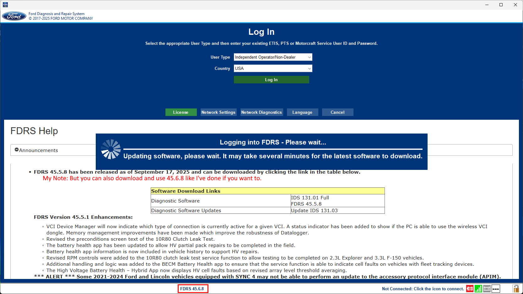

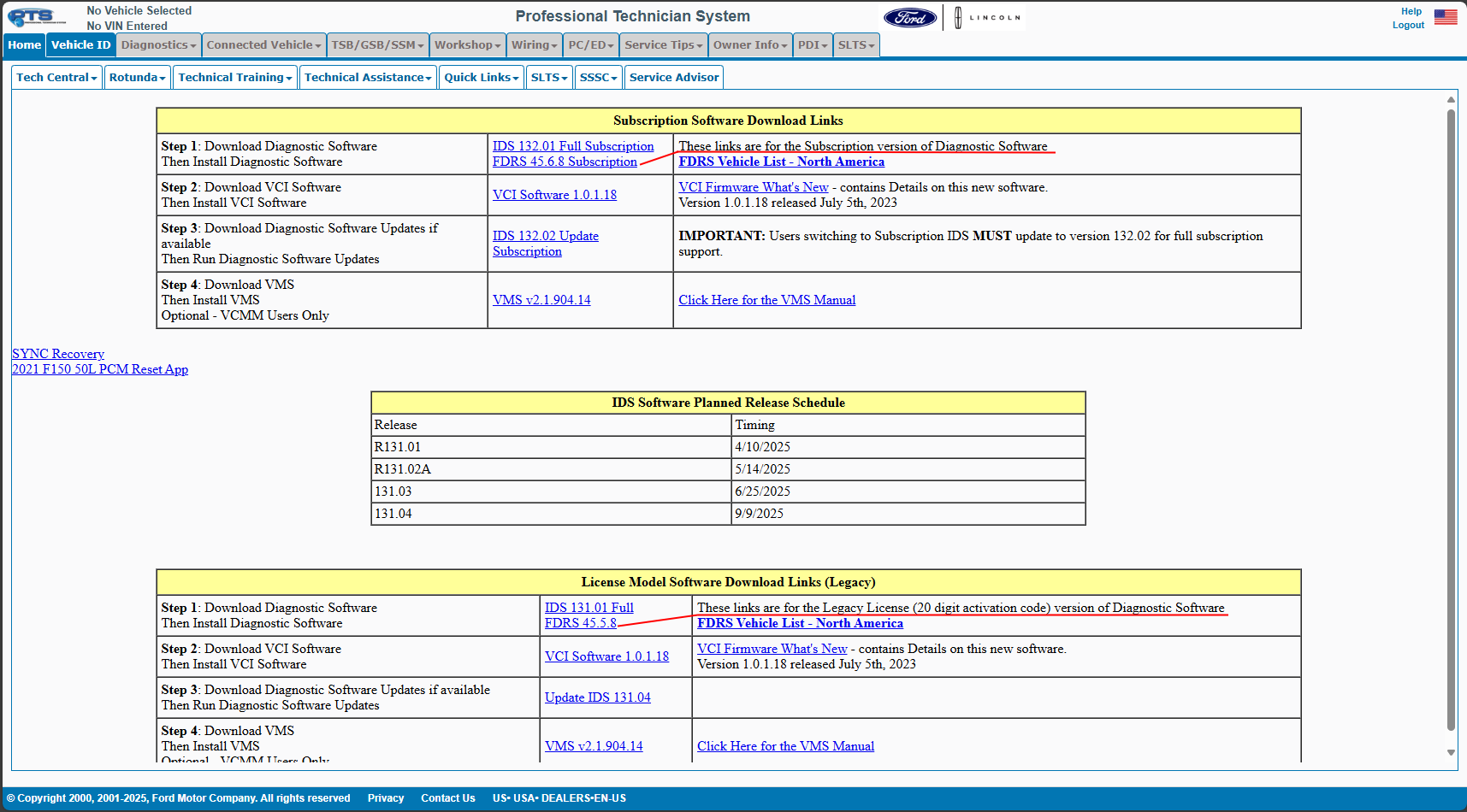

I finally got the subscription and account all sorted out and started an update session today.
My first module was the PCM. When it got to the last step it gave me an "update failed configuration error". I hit the "try again" button, with the same result.
After that attempt, I hit the "no" button and it moved on to the next update on its own.
Any suggestions for the PCM update configuration error?
EDIT
Tried again and I get this:
Ford F-150 Lightning Lightning Software Updates using FDRS 2025-10-1010.14.324855737511184826647
